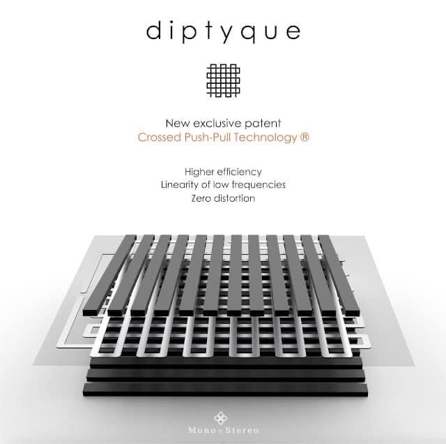

Its not clear what Xmax the Diptique has, they do user bigger magnets not sure what type., i never tried there cross coil design, besides that i believe they patented it. with ferites single ended 3-4 mm xmax is doable. and price not to insane. in push pull this might be more around 6mm one way. but it does get expensive. i buy mine around 60-75 cents a piece if you buy allot in one order and are 100mm long. but it adds up rather fast. 100mm long neos are around 1 euro a piece. if you buy allot. (1200 or so) now problem remains that the neos are less wide so more of them are used but the output is muuuch higher of course. if you would make this push pull (must find a better name for it since it is not push and pull, but everyone calls it pp) witch should be push push :) it becomes really expensive and the need for a really sturdy frame and a hell of a assembly that makes it really scary.. you might **** up a few hundred euros in magnets, steel , membrane and time in less then a second

I think, the Diptyque PPBM patent can be two "single ended" system in opposite application. The magnetic field isn't superposed regularly (lowered the efficiency), but the undriven area of membrane is divided smaller quadratic areas. I think, there is ferrite blocks, the induction is around 100mT at membrane traces, but the driving force is symmetrical (and pretty linear) to rest point. The rated 86 dB sensitivity can be an evidence (relative low for PP magnet assembly).
in any case both magnets will short to each other where they meet alternating and every other vertical magnet it pushes against it like a normal PP. since vertical is north south north, and horizontal is to. some do push against each other some dont. and will short out to the opposing magnet. (if that is put to use its not all lost :) but i was always worried about coils going horizontal and vertically been in a field not corresponding to what it should be at some points... then again i never tested it :) so wo knows. might be one of those things that looks like a bad idea but might work..... femm is not capable of modelling that :( so cant confirm

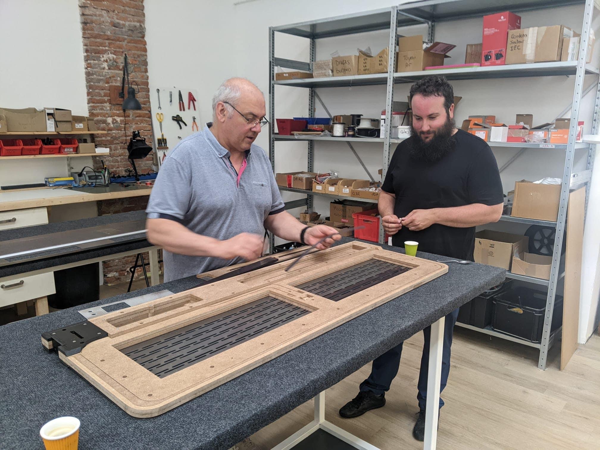

Looks like common strip magnets were used

yeah they look like rubber magnets, maybe Ndfeb ones ? else they will not reach much of Xmax max 1-2mm if the drawing is anywhere the real thing :)
since ferite ones are weak. and Ndfeb are... well expensive :)
hmm nice i never seen the left picture. it indeed shows it is rubber. and slightly wider then we are used to maybe slightly thicker to (5mm give or take). but not really all that impressive. weird :)
almost looks like STRIP ANISOTROPIC 9X6 MM rubber magnet :) or the 12 mm version
Many thanks for good pictures!
My suspicious think: the U-shaped magnetizing of strips not generate too much repellent force, if they take to opponent position, but not pole to pole (N-N and S-S at true PP arrangement), but crossed direction. This is the secret of PPBM! No more need a lot of steel support and crossbar, the cheap laser perforated metal sheet is enough. The price of this idea is the smaller membrane excursion and lower efficiency.
