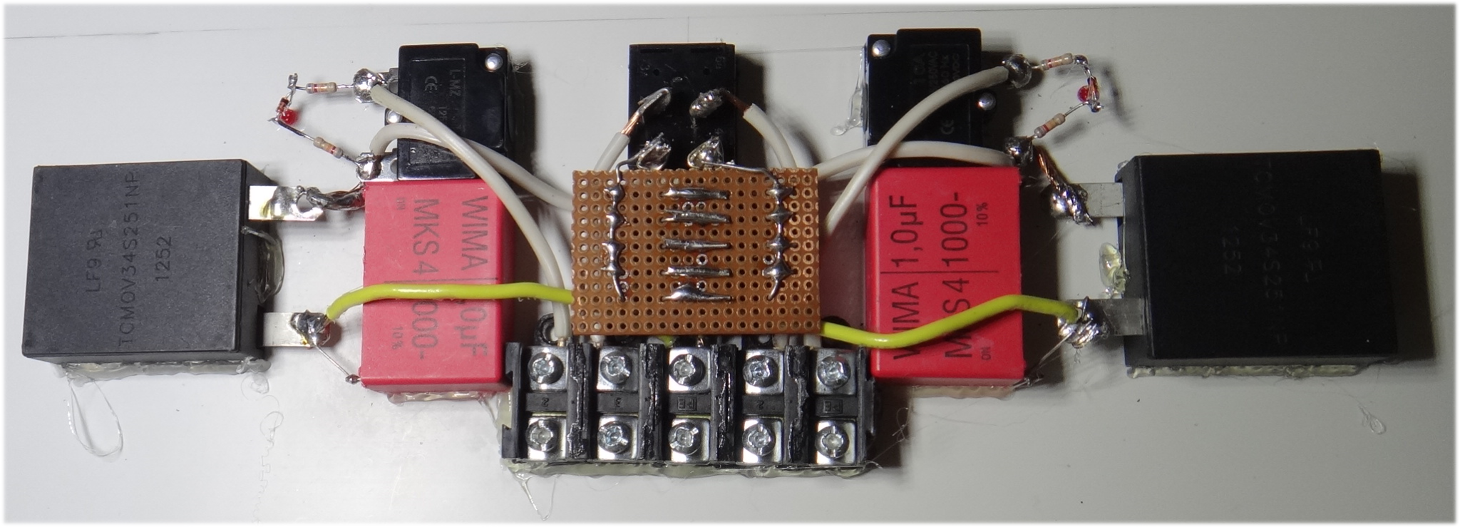

MOVs are more reliable when limiting the current through them, for instance to the maximum value the household might need. In my case, a 20A thermic fuse does a good job (applied MOVs can take kA) and over the thermic fuse a LED, antiparallel with 1N4148, in series with ~150k is used to indicate "temporarily switched off". As the input lines are 120V opposite phase, each line is treated that way, and the "protected" 240V output is run through a transformer, 240 to 120V. The installation has been working well since 2017. As I've witnessed the red LEDs turning on several times during "close hits", it's a solution I can recommend. In the middle is a switch to turn off grid connection during power cut, so I can connect a generator to any outlet.
Thanks everyone, that is useful. It does seem that some are better than others, then. I'm not expecting total elimination of all possible spikes, but whilst there are a fair number of them, happily we rarely get huge ones here (perhaps as above, because the cables are burried).
I might possibly have a go at making my own then. Or failing that, trying a different brand with a better joule rating; it looks like APC make some UK types for instance, and I've been pleased with their Uninterruptible Power Supplies over the years.
