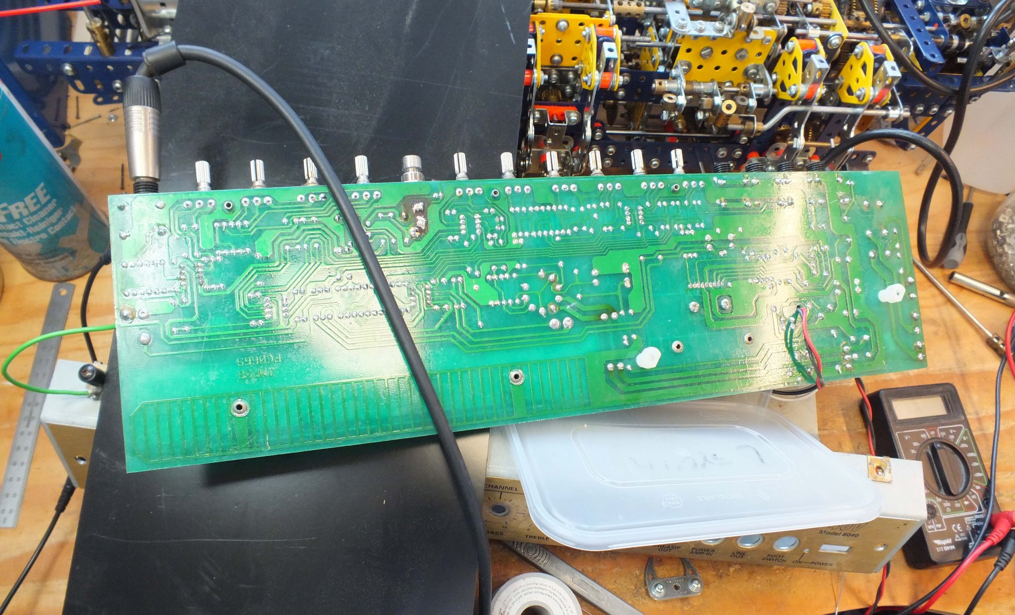

Thanks for answers so far.
I didn't post schematic as I was not really looking for specific fault finding advice, just a general question on PCB soldered joints.
It is 1 large PCB, single sided, thru hole.
Working on is tricky as power tranny is bolted to case, short wires. IEC inlet is riveted to case, everything hard wired, not socketed.
I have PCB inverted & solid plastic sheet between PCB & metal case to prevent shorts.
Thus I don't fancy wiggling & poking too much.
You say unrelated problems but the common factor so far is intermittentness.
I reflowed the power supply side of the board and now have consistent power.
On this basis, I will reflow other areas that are subject to heat or weight - valve socket, large caps, power resistors.
I will (for now) avoid reflowing around ic pins (lower risk of failure, chance of overheating chips in the process).
If all seems ok I will replace pots (they always were noisy).
On the 'minimal improvement' side, I intend to fit input protection diodes to protect the input ic and (if no objections) a third PCB standoff.
As can be seen in the photo, a large area of board is completely unsupported.
Maybe it is supposed to flap about as the reverb is fitted in that corner?

OK, umpteen joints reflowed.
Didn't take long and I consider it time well spent.
I now have sound from both clean and boost channels.
I now feel confident that replacing the pots is now worth while.

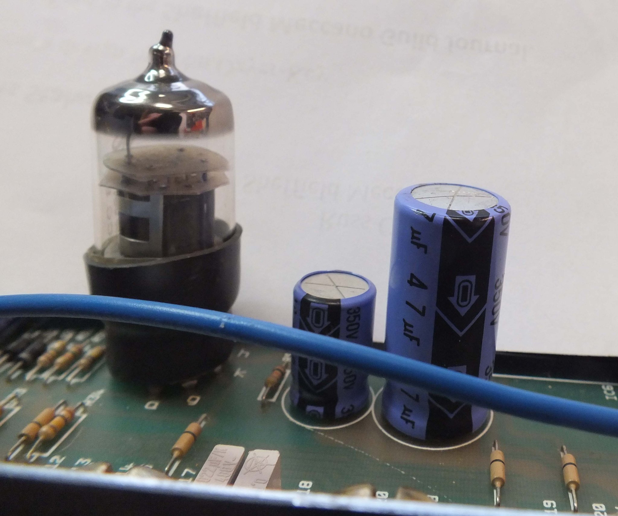

Last question, B+ smoothing cap, large one in picture.
Is this what a bulged cap looks like?
I think the photo shows the top is crowned.
All the others, the top is flat and below the poly sleeve.
Would you agree I should replace it?
Yes, the replacement cap will be a perfect fit. .
