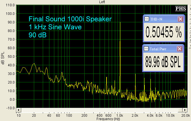

It's been shown in several measurements by different people that Quad ESL63 can have very low distortion. Final ESLs have a reputation of having poor harmonic distortion either because they use an unusual drive configuration (inverted electrostat) or because they used to use high conductivity membranes. The example of a more recent Final ESL I found a review of pretty good, though:
https://www.diyaudio.com/community/threads/inverted-electrostat-inferior-in-distortion.409322/
Just one picture (ignore the 0.5% THD which is probably THD+N, the important thing is that the HD2 is 60 dB down = 0.1% HD2)
I also had a chance to measure an Acoustat 1+1 recently. I just did a quick test at 200 Hz at rougly 85 dB / 1 m and got HD2 about 55 dB down, so not bad at all.
There were also measurements of pre-production Capaciti panels in Klang+Ton and HobbyHifi magazines which were in the 50 dB+ range.

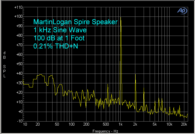

Found another review by myself (same magazine, same reviewer):
https://hometheaterhifi.com/reviews/speaker/floor-standing/a-secrets-speaker-review41/
So that's even at 100 dB/1 foot, so probably 90 db/1m and finally 60 dB down (so 0.1% THD without N):
So Gen 2 panels can be good. The size of the larger panel of the Spire vs. the Purity should not really matter at 1 kHz. So how do we explain the -37 dB (roughly 1.4% HD) at a lower level in the purity vs -60 dB (0.1%) in the Spire?
