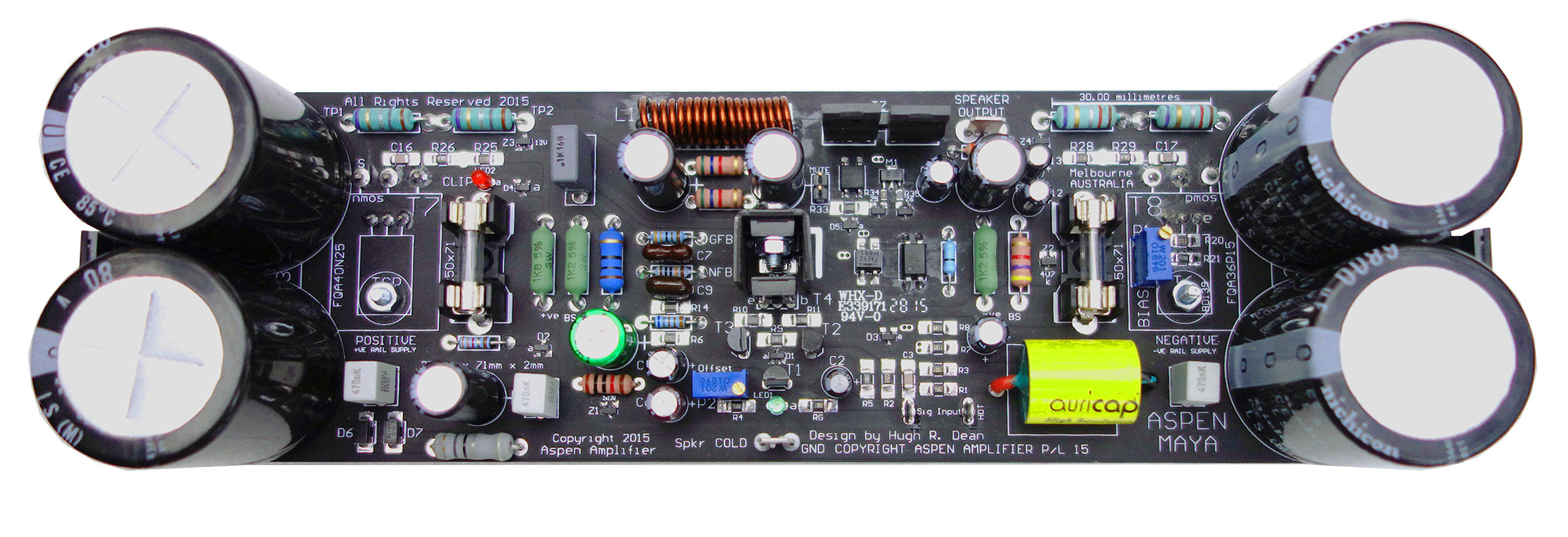

I'm listening to a 50V Maya at present, on classical guitar. This amp will be released with 62V rails, which relates to an easy 210W into 8R and much more, depending only on the transformers, into 4R, at least 300W. The topology is unique, different to the NAKSA, and the flagship for Aspen. I will be offering the modules for $AUD2250, which is $USD1642 on the present rates. This is actually pretty much the same as the original N125, which was sold at $AUD1620 when the Oz dollar was almost at parity, so in a sense it's a lineball price, and much more technology and performance.
Features:
SS relay speaker protection, which tripped with more than +/-2V DC on the output.
Soft turn on and fast turn off for the speaker.
29dB of global feedback, delivering wonderful spatial characteristics, viz sound field.
Blinding speed; the amp is limited with a low pass filter on the input, but will deliver real power up to 150KHz. Quiescent is 125mA, and total dissipation of output stage is up to short term 940W.
Very low THD, less than 0.025% into 200W, and very low noise, lower than -105dB.
Very low odd order harmonics in the distortion profile; this is the primary aim in this design, which is supernaturally musical - tube grace with SS muscle.
Attached is the module, which is double sided on 2mm black FR4 and 70 microns copper. Every attempt has been taken to address all detail in the layout of a SOTA Class AB amp.
I am now finishing the documentation, but I will not be publishing the schematic!
Hugh

Hi Hugh,
Out of curiosity, why did you choose FQA40N25 instead FQA28N15 as a FQA36P15 complement...FQA40N25 has ~1/3 higher gfs and parasitic capacitance than FQA36P15?
Happy New Year
Ivo
I'm not Hugh, but the mosfets you are posting about are the ones in the Naksa 125. The Maya, topic of this thread, uses different mosfets altogether. Hugh can comment further.
Hi Ivo,
Happy New Year to you!
I use much bigger, 480W mosfets for the Maya, and yes, they have much higher transconductance and parasitic capacitances. The NAKSA 125 uses 280W devices.
I could fill a page on this; it's my stock in trade for the last twenty years. Firstly, higher transconductance means there is very little change in Vgs on these devices over the full waveform, and the Cgs (input capacitance Ciss) is bootstrapped by a common source configuration. These devices have transconductance around 25S plus, where bipolars are markedly less (typically 20S for a C5200), so the waveform compression of mosfets is generally superior to equivalent bipolars by 1:1. A single pair of very large mosfets are superior to multiple pairs of bipolars; more resolution and easier to drive (no gate current). It is much easier to drive large mosfets than most expect, and in fact I found using drivers increased phase shift and gave no subjective improvement in sound. We are working with audio, not radio frequencies, and up to 20KHz a high driver current is more than sufficient drive. In fact, the Maya will do huge output to 100KHz and beyond if not fitted with a mandatory LP filter.
There are some dark secrets in using mosfets in this way. They are skittish devices, inclined to self-oscillate. Robert Cordell helped me from a 1984 white paper on these fascinating devices. These days I would not use anything else, and we can thank SS traction technology for this; hybrid electronics use them in VFD modules.
Thanks Steve, absolutely, different devices, and we think, you and I, that the bigger mosfets sound as good and even a bit better.....
Hugh
