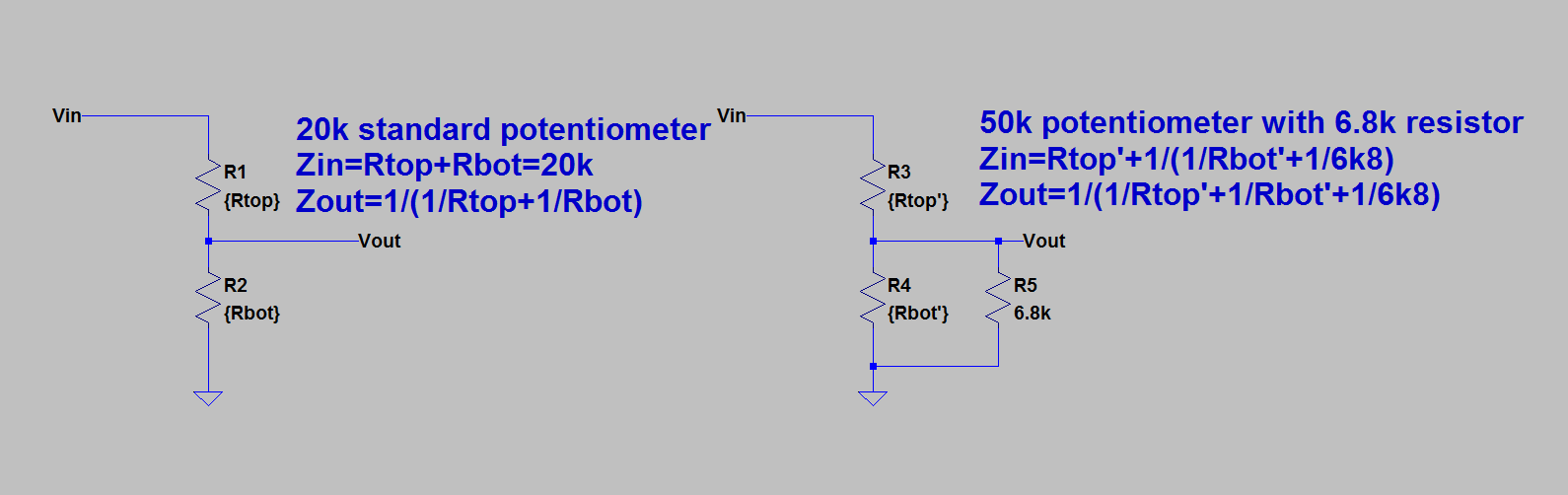

I read this article from Rod Elliott about a better volume control and wondered if I could not do something similar that could work fine with the DCB1. I'm a beginner in electronics so finding the answer took me some time and I'd like to share it here hoping that somebody can confirm I did not make mistakes.

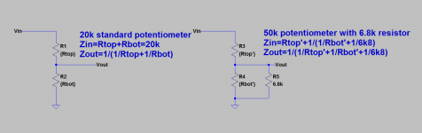

If I understood what said in several posts here, in order to work fine the better volume control would need to have an output impedance similar to the one of a standard 20k pot and an input impedance possibly high and compatible with the sources I will use. I then calculated the input and output impedances for a standard 20k pot and for a 50 k linear pot with a 6.8k resistor added between ground and slider, as suggested in the Rod Elliott project. I put the the formulas I used next to the schematics below.

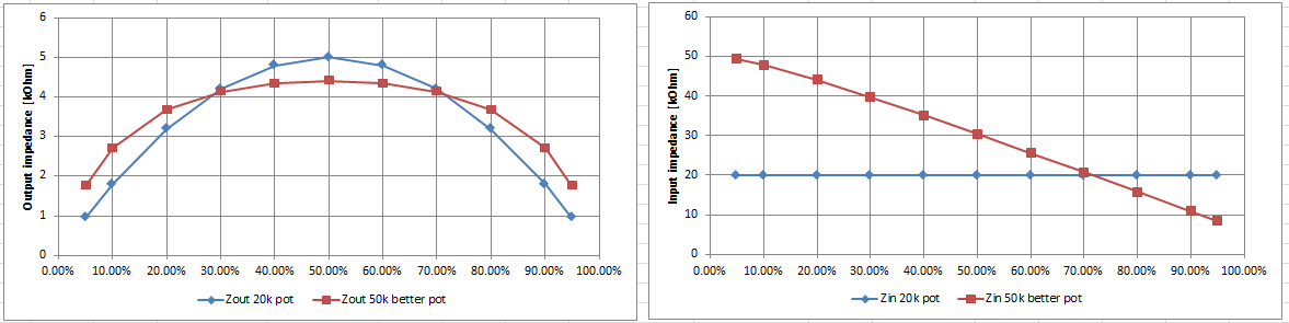

Putting the results of the calcs in graphs vs the percentage of the potentiometer stroke gives these plots
These seem to tell that if I use a 50k linear pot together with a 6.8k resistor I get an input impedence generally high (its min is 8.5k at maximum volume). This is fine for my source (a DAC with 80ohm output mpedance). The output impedence also seems correct, following the same behavior of the 20k pot.

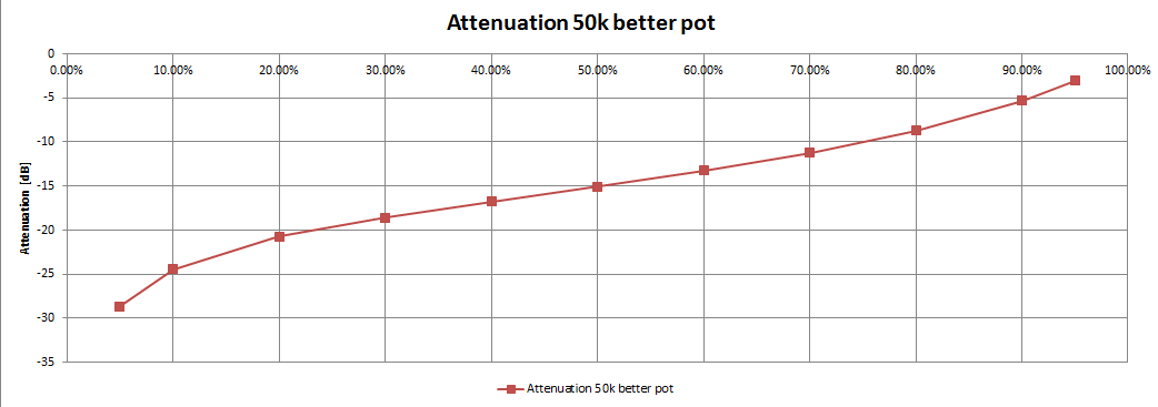

Last piece of info is the attentuation vs pot stroke here below.
This also seems to have good behavior with decent linearity in the central range of the volume pot stroke.

Making a linear pot to a mimic a log one is an old trick that works. I had done this once to a Sfernice small white Lin pot. That was a really clean sounding pot. Alas it never had good very low level channel matching. Was shutting them off one by one. The //R quality mattered too as I recall.
Yes, I assumed I could omit the receiver based on two hypothesis:
1 if the two solutions compare well without the receiver they will also with it
2 if the receiver has high enough input impedance then it won't affect the actual values too much.
Is this correct? If not i will spend some more time on this later tonight

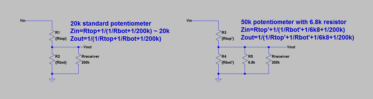

thanks Salas. So if the value is 200k the formulas change to
and the effect on the results is very small. I would then go with a 50k linear with the 6k8 resistor in place of the 20k log pot, leaving everything else the same.
I will give it a try.

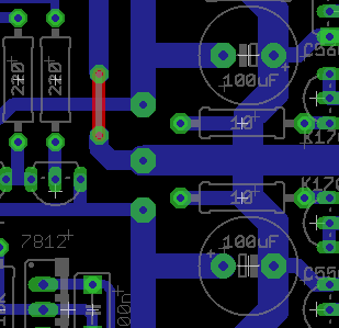

My little issues are
1) the three holes near the centre of the board between the 10 ohm resistors and the small jumper
2) There is an extra LED site near 2k2 resistor that the Bill of Materials does not account for - should one be placed there?
3) Should the 2 x 300 ohm resistors be placed where indicated even if the jumper for 12 volt relays be used?.

1. Test pads for probing and reading the regulators outputs +0- DC
2. Power on indicator LED. Can wire to a front panel LED from there. Can also remain unpopulated, no harm.
3. No. Only in case of must be using 5V relays. 12V ones are preferable. Don't mix types if having few of both.
