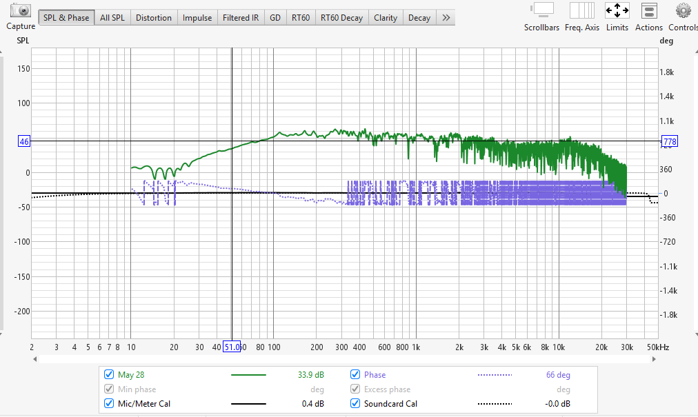

I did a search here on the forum about microphone calibration files and I was wondering if the method of intervening on the file based on microphone models with higher specifications and costs, can be useful to obtain/improve the measurement quality of the microphone.
mic. ECM8000

I already downloaded and took a quick look at the file that you download from their site and it is like silto a three column text file. but is there a program to read the current calibration and then with the added file?
with calibration files and without. I'm perplexed, I don't see big differences and... there must be something I'm doing wrong. this measurement is done with the LS 3/5a hybrid finished in the last few days.

if I understand correctly, you are telling me that I should raise the measurement level - when I do the Level check, if I remember correctly, I go around -22-23db, I raise it up to -12 and tighten the scale from 20hz to 25Khz?

In REW looking at the graph - hit the box named "Limits" upper right.
Add 10 in "SPL Top" and -40 in "SPL Bottom". Hit Enter.

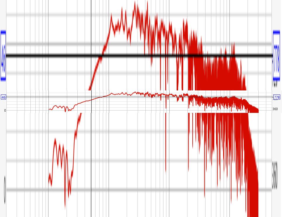

Now you will see your measurement like most presentations on this site. I hope it's clear that now you see much deeper into the measurement but all levels are the same. Same measurement, different presentation scales.
As of now, you have such an tremdeous large range for dB that small variations can't be seen.
Reactions: jeffrowland

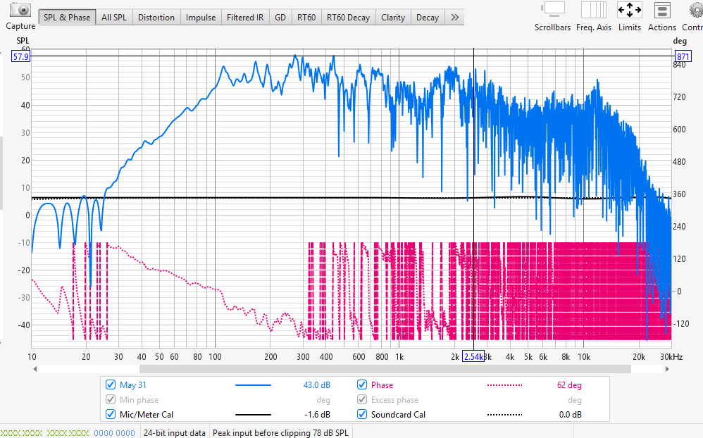

Yes - but you are still 50dB to "large". That measurement should use 10to60 dB top/bot of the scale. You probably also want to "smooth" (average) the trace - this is made in the Actions button, also up right. Do e.g. 1/12 smooting.
Now you can compare with what most other show here.

Go to your impulse tab and make the gate drop about 5ms after the start of the impulse. That will remove room reflections and give you a better idea of actual treble response (if you had a flat mic, that is)

I don't understand what you mean with - Go to your impulse tab and make the gate drop about 5ms after the start of the impulse.
the image above is actually the measurement of the hybrids with the yellow cone. 🙂
