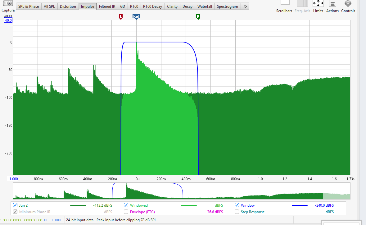

See the tabs at the top? There is one called impulse. There you can change the gating and remove room reflections (Read the F#$^ing manual)

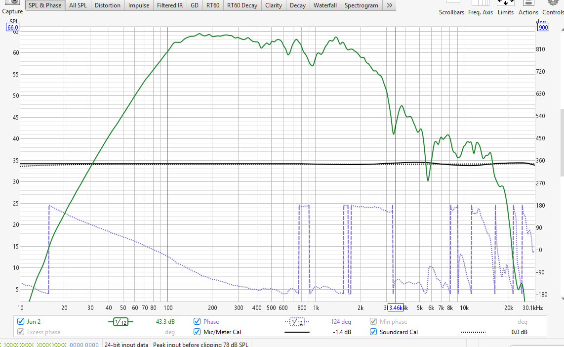

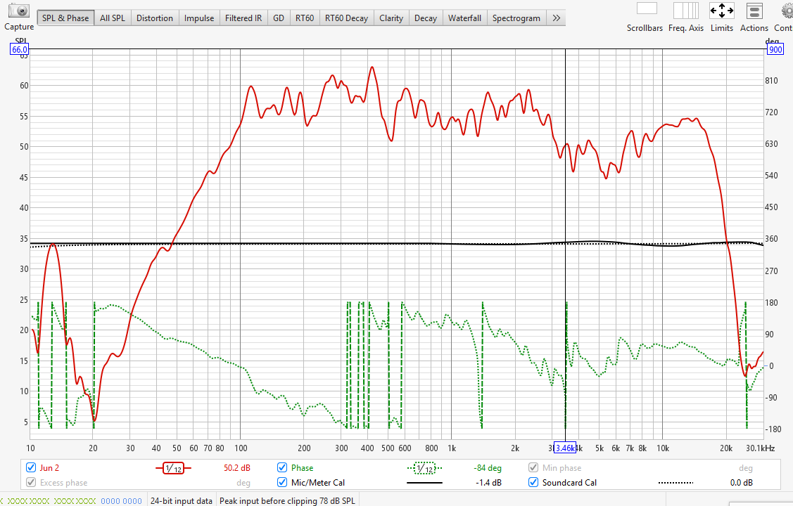

this measurement refers to the second type of crossover, with a different approach than the one you saw above and you can see how it has difficulties on the low range. it sounds very good, in the medium-low and high range and is well balanced, but below that deficiency is immediately noticeable.
The plot technique is looking better.
What does your bass look like if you put the mic very close to the cone and measure? Have you looked at your room effect?
move the mic closer to the woofer, I haven't tried it yet. for now I've kept levels and distances to see the differences between the two crossovers - the mic is on the X and Y axis between the tweeter and the woofer. and no room control at the moment.
Ok. When you are ready, putting the mic close (less than 1cm) will tell you the bass response without the room. You can learn what is causing your problem.

this is what the card looks like - impulse - with the last measurement performed.
are you talking about another program to install?

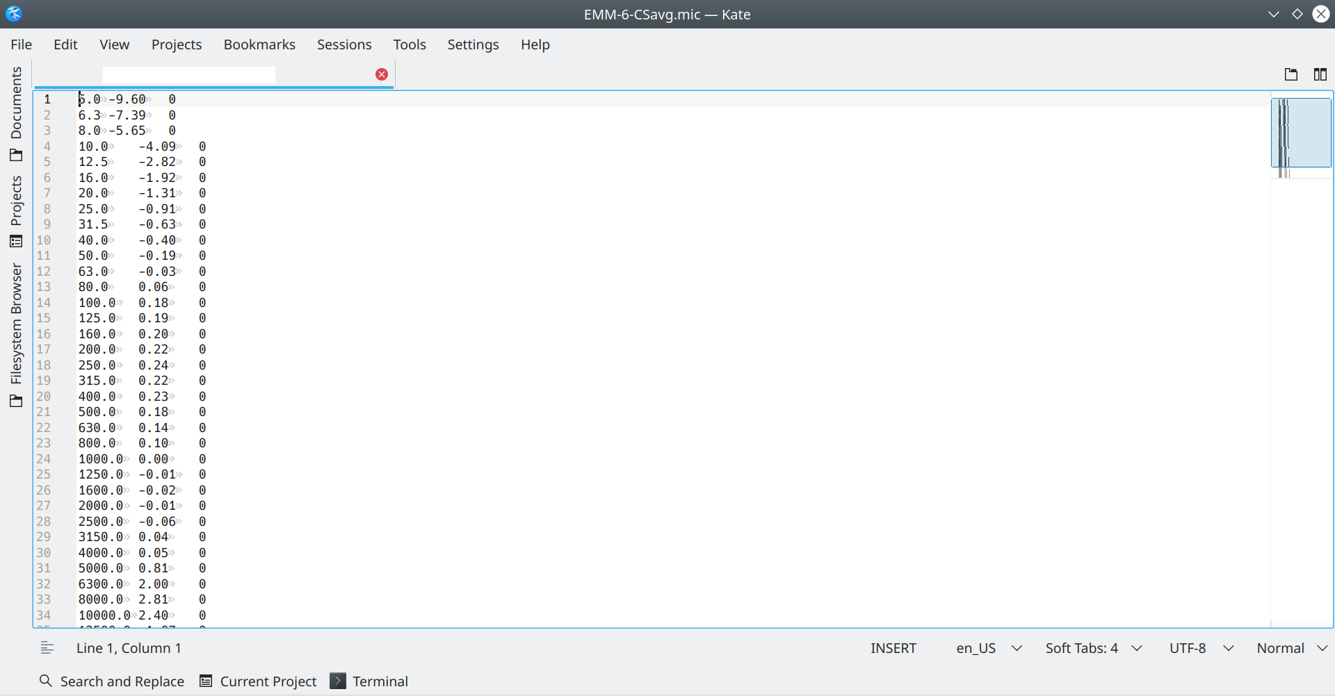

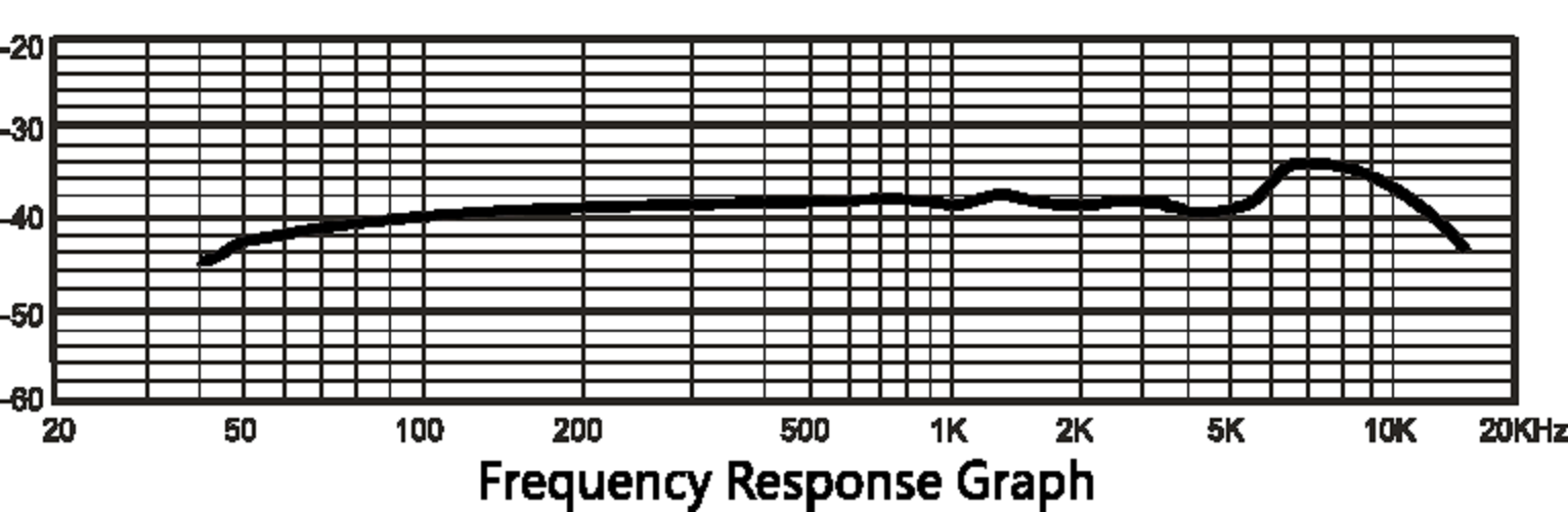

My two cents. Given that chances for a mic manufacturer to build their own electret capsules are thin, it's likely they use ready available parts and in my understanding these fall to just a few categories regarding frequency response irregularities. If one could find the exact part then the calibration file should apply. That is in my opinion of course. But I built a mic based on that and generally I'm satisfied.
Measuring known speakers, I got a rough idea about its generic frequency response.

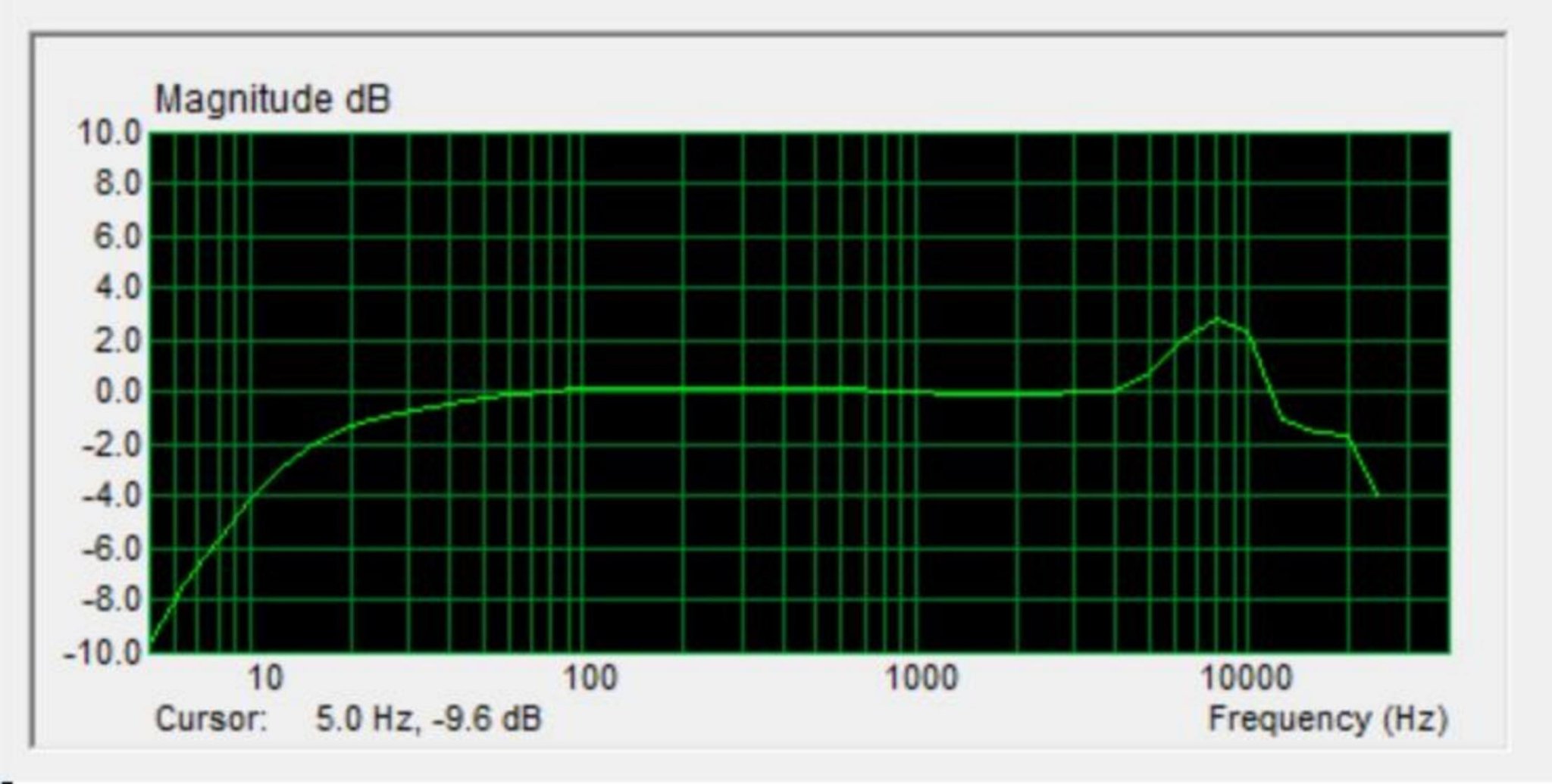

Something like that. Then I downloaded a commercial calibration file and edited it with a text editor. Simple as that.
When loaded in ARTA it looks like this
Accuracy of this method depends on the reference used, preferably another known mic but what I did works for me.

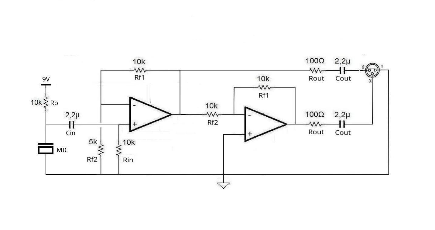

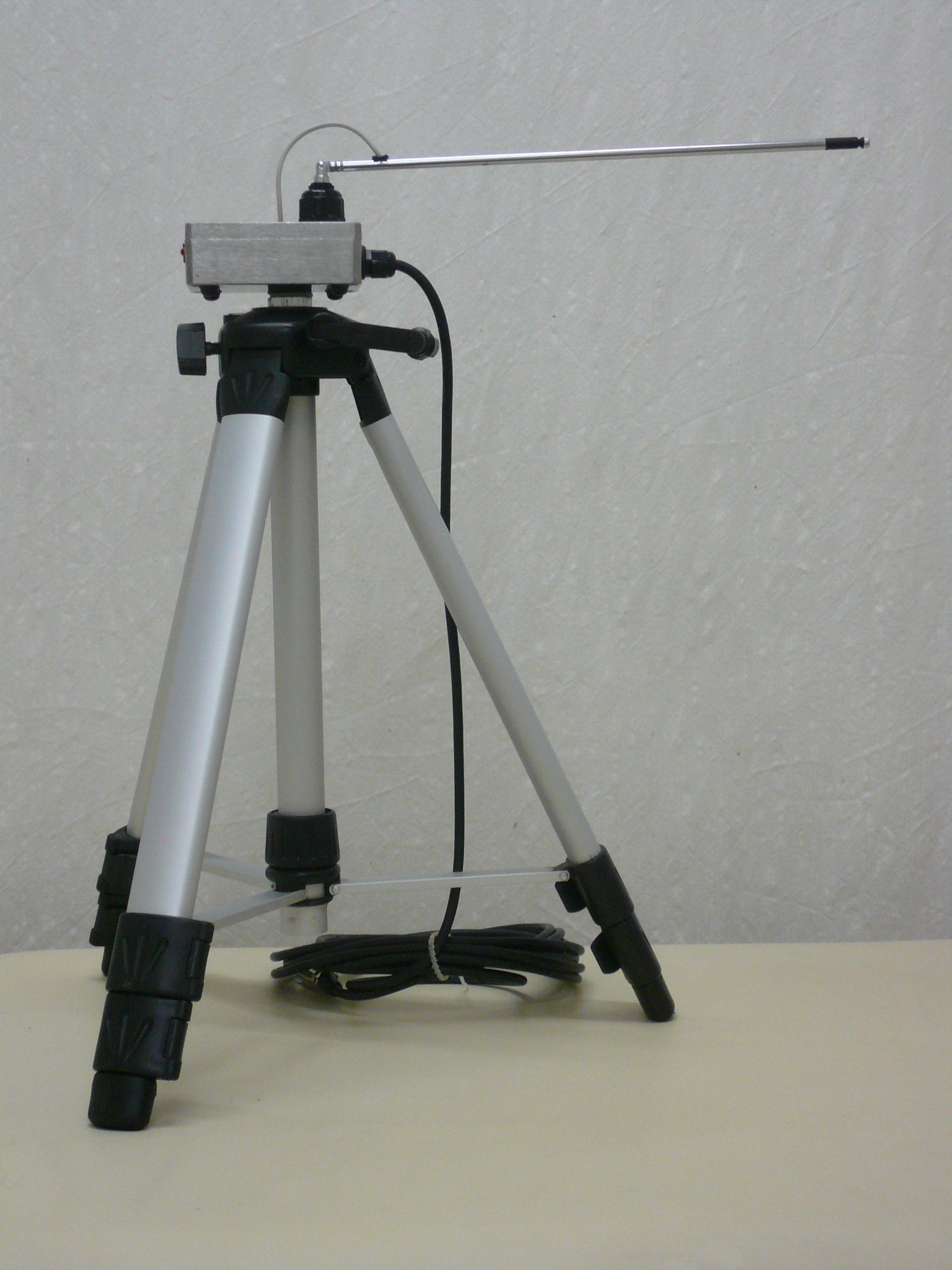

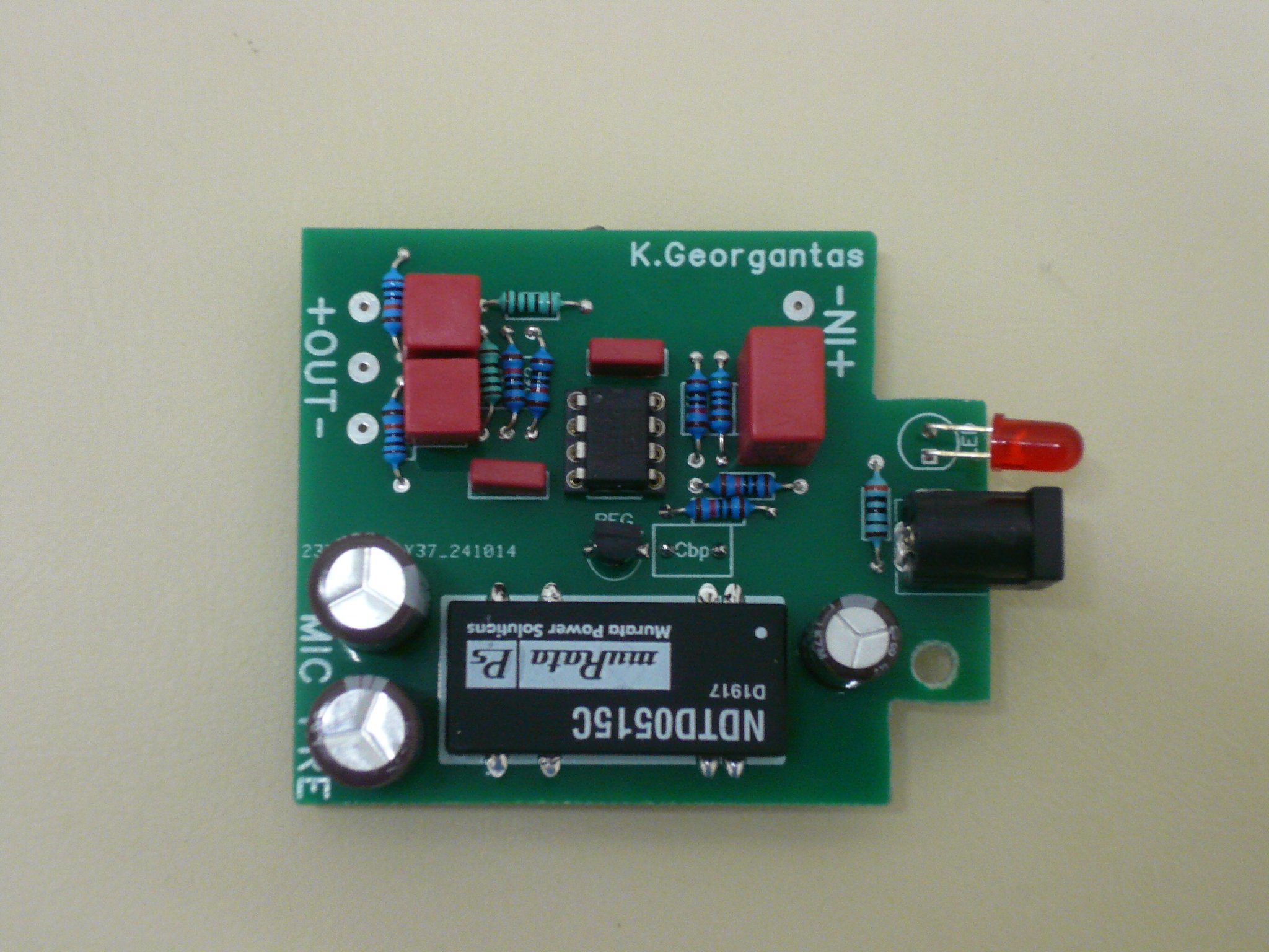

It's built mostly with what I had available. As you said, a piece of an FM antenna holds the electret mic with heatshring tube, and then a screened cable goes to the preamp inside the aluminum box. The tripod comes from a laser leveler, it expands to more than 1,5m high. The preamp is simple, based on OPA2134. One half is used to take balanced output to drive a long interconnect.
It requires 5V external power supply, for example USB. It has a DC converter to +/-15v for the opamp and a separate 9V regulator for mic.
The triangle shape means that you are measuring all the room reflections You want your gate time to be about 5ms (depending on how far away the reflecting planes are) after the start of the pulse, not 400-500ms.this is what the card looks like - impulse - with the last measurement performed.
Also, if you are still using the cardioid mic, proximity effect is going to alter the frequency response of your close mic measurements at the low end.
