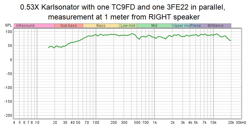

With much gratitude to xrk971 for the design and thread, and to Skylar88 for 12mm plywood plans, I'm now able to show you my 0.53x Karlsonators, each with one 8 ohm TC9FD and one 8 ohm 3FE22 in parallel, giving 4 ohms ... in beta format.
I built them using those particular drivers - because I had them! But I think they work well together - the TC9 is below the 3FE22. I used melamine pads in the box exactly as per X's recommendation, and silver foil/bitumen on the back of the front K-aperture - again because I had it, and didn't have foam core.
I will now finalise the construction and give the boxes some kind of finish.
Please ignore the sound quality in my recording - they sound good!
have fun!
Simon

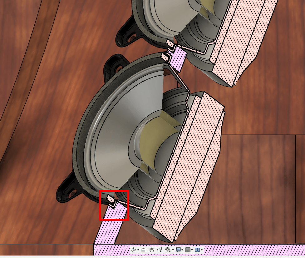

Hello everyone, I have finally decided to manufacture a 0.53x with the Faital 3FE25-16, I see that the frame is stamped creating a significant thickness on the front, the question is, is it convenient to lower the board to accommodate the profile? or that will not affect the diffractions of the speaker by having that foam ring that sticks out more. Thanks for reading.
