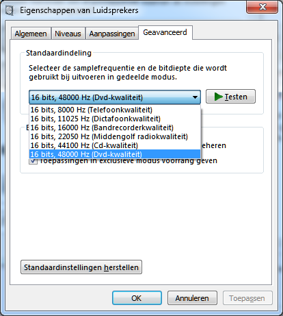

9. The minidsp only accepts 48kHz. Being an I2S signal it can be both 24 and 16 bits. So without a minidigi you must set the properties of the usb-soundcard in your OS to 48kHz/24bit or 48kHz/16bit mode. In the picture you can see how it's done in Windows (sorry it's in dutch).
10. See answer 9.
10. See answer 9.

9. I figured out, I can definitely force the output of my computer to 48kHz, so that's a go. No need to put a MiniDigi in between, saving me a nice 70$.
