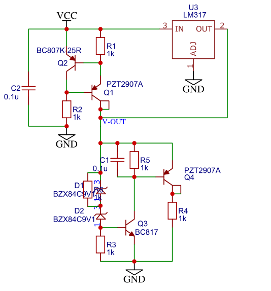

A few weeks ago I prototyped a discrete shunt using a Sziklai pair of transistors and got wifey to turn it into a PCB. The noise reading from this was a huge disappointment at almost 80uVRMS. After a minute of headscratching I wondered if I was running the zeners too current-starved. So I jacked up their bias to 5mA from the original 1mA. At 5mA the noise reading was 15uV, a worthwhile improvement over the LM317. Higher currents reduce the noise further still. Schematic below - note the 1k resistor values are place-holders.
