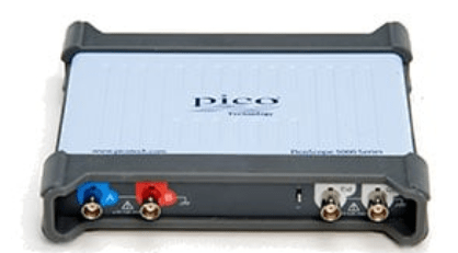

I have a Picoscope 5242D 60MHz dual channel scope, it is sort of expensive but in single channel measurements offers up to 16 bit single channel resolution and in 2 channel mode up to 15 bits, as useful perhaps is the spectrum analyzer which is quite good. I wanted a small solution that leveraged the computer already on my bench top rather than a standalone scope. Replaced both my analog scope and a Tektronix TBS1052B
