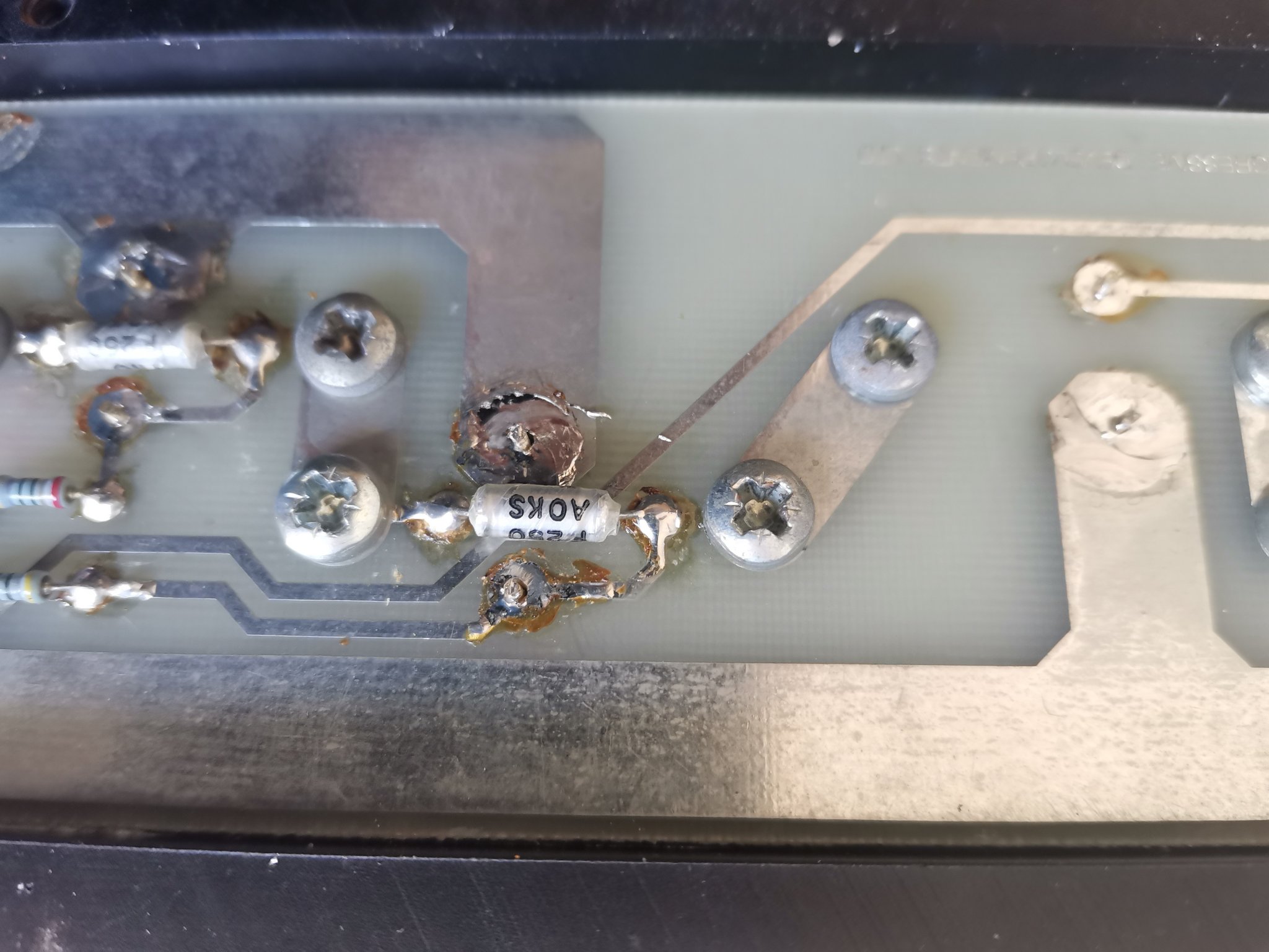

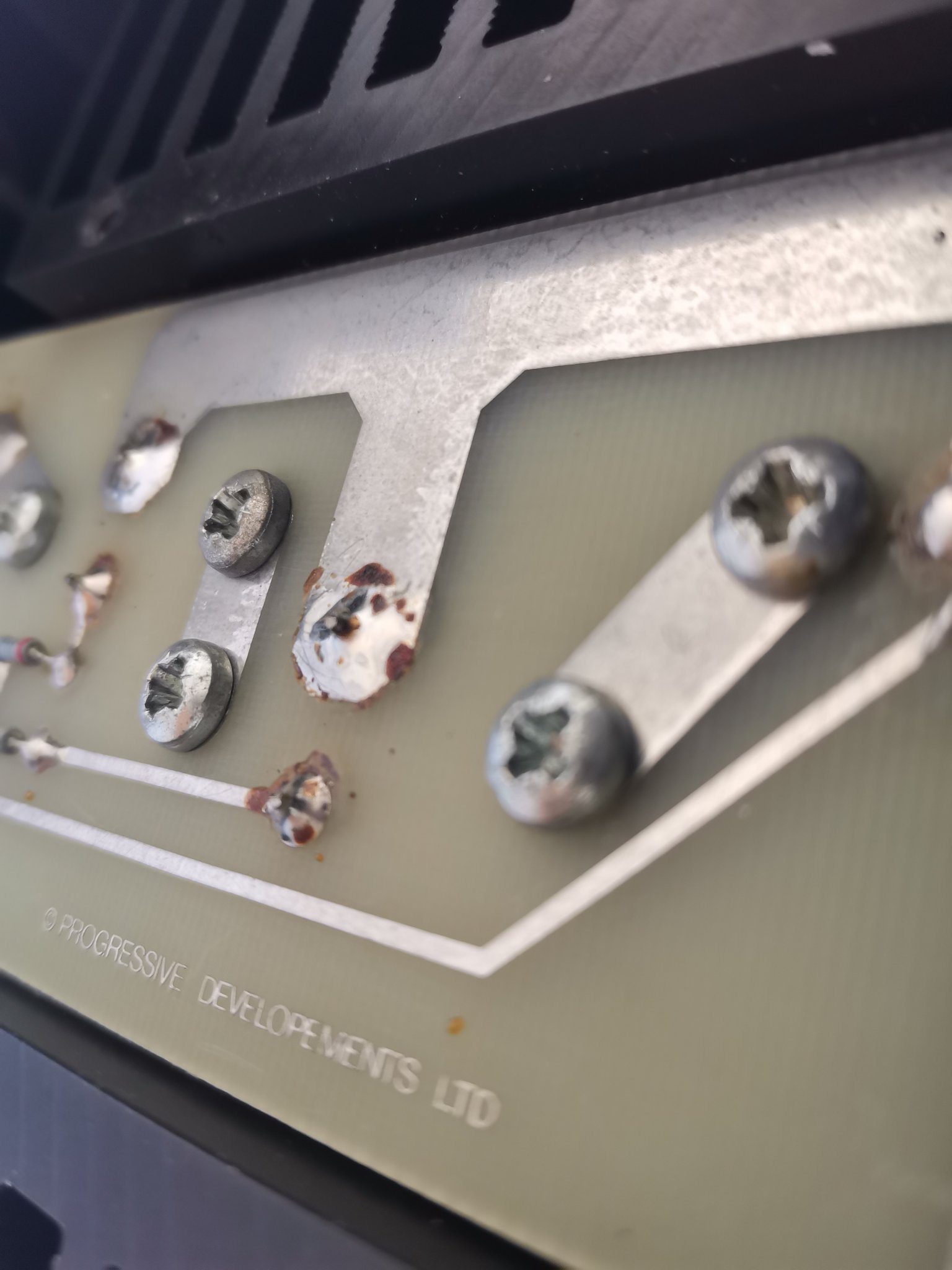

On the left channel, I looked at the PCB containing the mosfets, and found they weren't soldered in properly. It looks like someone has replaced them at some stage and forgot to solder them in properly before reassembling the amp. I was surprised the left channel worked as well as it did. Nevertheless I applied solder and reassembled. No huge change to the sound though.
On the right channel, the heat output is now much cooler. All I did was disassemble enough to look under the mosfet PCB to check soldering, then reassemble and tighten down the nuts holding the mosfets to the heatsink. (there were a few somewhat loose ones). The mosfet case (which the nuts/bolts secure against) is the mosfet source. Could a loose connection here have caused the right channel to be producing a lot more heat?
Would it be a good idea to solder the screws... in case there is a corroded/poor connection between the PCB traces and the screws?

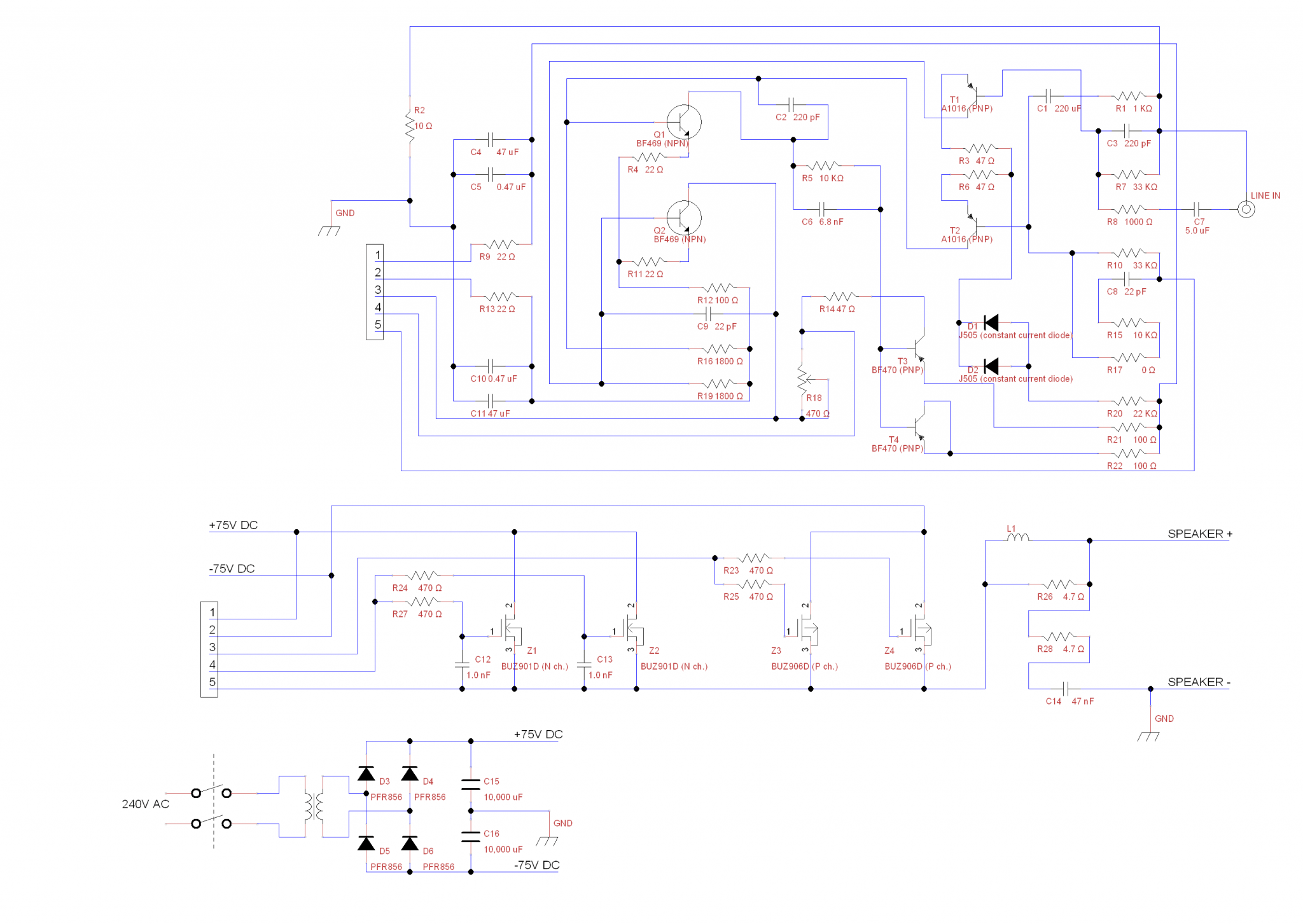

I spent this afternoon creating a schematic of the amp. Can anyone comment on the amp's design? Or how I could go about modifying it to decrease distortion / get a cleaner sound? Is there a way I can tell what the bias current should be from looking at the schematic?
Sorry, I do have some understanding of electronics but very little knowledge of amp design.
Please excuse the poor layout of the schematics, I was trying to keep the components in line with where they were on the PCBs so I wouldn't get too confused
Well that would make it difficult to remove them again without lifting pads on the PCB which isn't a great idea. Maybe add crinkle washers to apply constant pressure to the PCB pad. Or just clean, tighten. TO3 and similar packages are always problematic for mounting which is (I suspect) why they became obsolete.

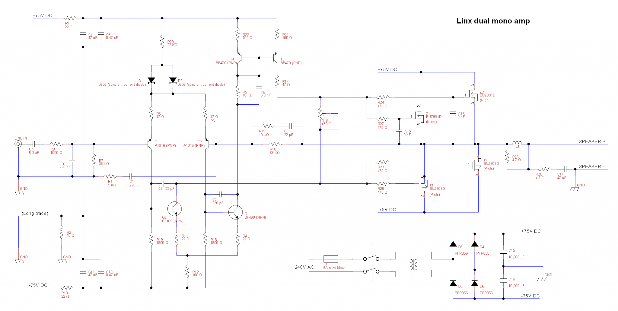

I have gone back over the schematic and corrected a couple of mistakes and laid it out a lot more nicely.
Is anyone able to offer any comments on the amp's design?
(This is a power amp, not sure I made that clear in the previous posts)

A typical way of drawing this type amp like this:
Al values and variation of stabilising also. There is a lot of Goldmund amp (uses "the same circuit upside down with j-fet input and driver for the mosfet output. Goldmund uses current sorce here stiped with driver transistors "stippeled"):
If you change the circiut with driver transistors or any other circiut mod you also have to change stabilising capasitors.
Input capasitor AND C1 is werry important for sound and bandwith the amp will play in the low frequensy region spessially.
I havent drawed your shematic but the amp is somwat typical.
It dont have the best measurments but run in the group Sounds Good. and that is in a high degree caused by the AButput stage, almoust Unbreakable
You can by ready or built kits with similar circuit that wil fit in your case..
if that would not bee a to big a challenge for a handyman.?
