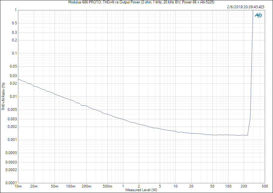

I took a look at the THD+N vs Output Power into a 2 Ω load. I had to use a linear supply as the Mean Well SE-600-36 with its 16.6 A output current rating runs out of juice on the peaks. So the THD+N vs power graph is with the Power-86 in its stock configuration powered by an Antek AN-5225 power transformer. The plot is attached here.
The THD+N is a bit higher than I'd like. I may be able to improve on that. Stay tuned for the final boards.

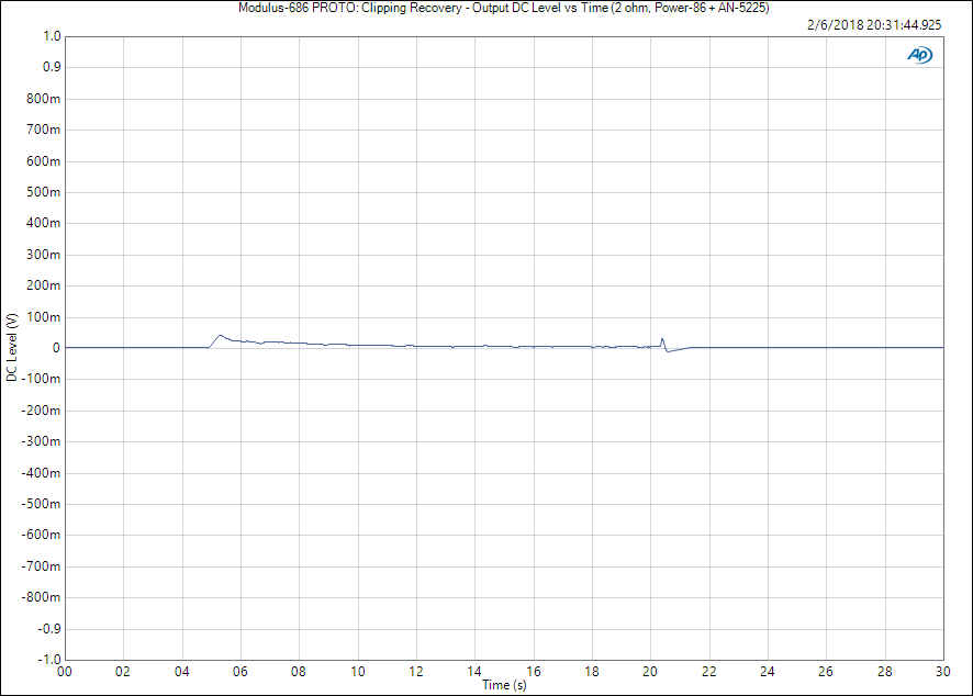

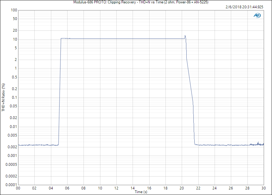

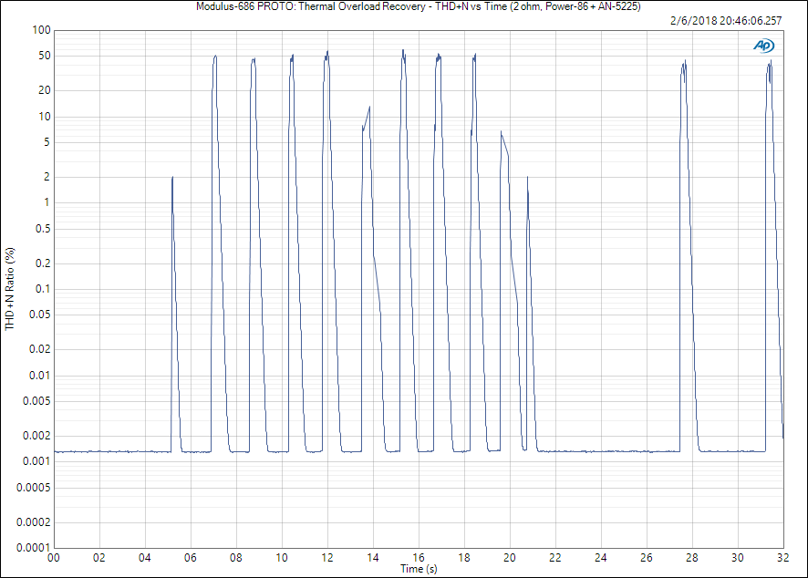

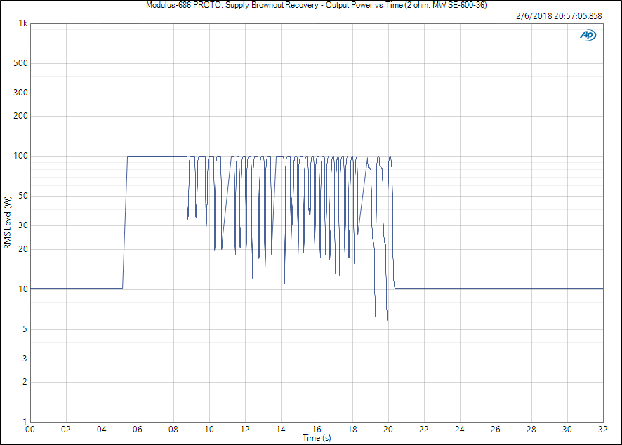

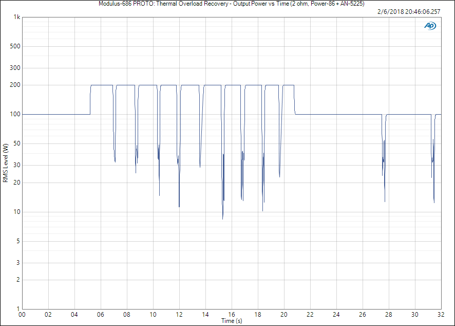

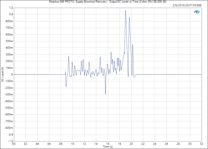

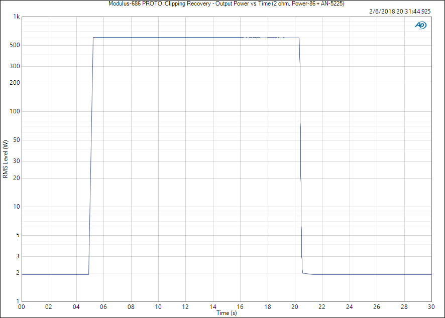

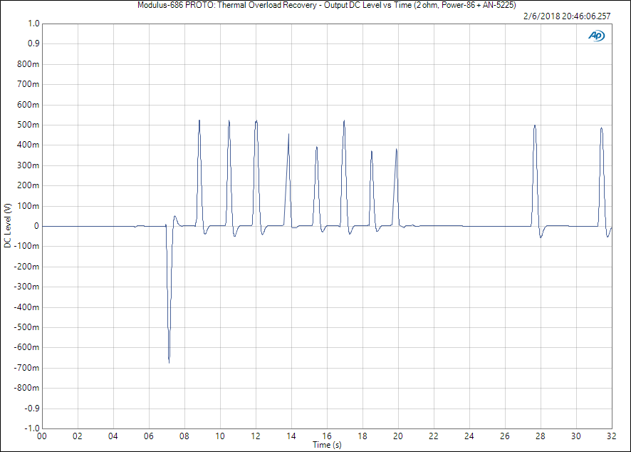

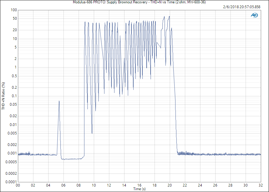

I thought of putting all the plots into one post, but figured I'd better put the plots that shows the amp in overload condition separate from those that show the amp under normal working conditions.
Here are the overload plots of the power vs time, DC offset vs time, and THD+N vs time. All plots were done with 2 Ω load.
I ran three conditions:
The amplifier is obviously not producing a clean output when it is driven into hard clipping, when the LM3886 thermal protection kicks in, or when the supply current limits. That should be obvious. However, importantly, the amplifier does recover well from all those conditions as evidenced by the THD+N returning to the same value as before the fault condition. Also note that the DC output voltage never exceeds 1.0 V. This isn't even enough to trigger the DC protection in a speaker protection circuit.
It is interesting to note that after running at 200 W for 15 seconds, the heat sink is so hot that the amp starts to overheat at 100 W (into 2 Ω, remember!) already. This is with a 0.4 K/W heat sink.
I stand by my claim that this amp will drive 8 Ω and 4 Ω rated speakers - even if they should have impedance dips into the 2 Ω range.
Tom
- 2 W -> 600 W step: Hard clipping recovery. (Power-86 + Antek AN-5225).
- 100 W -> 200 W step: Triggers thermal overload. (Power-86 + Antek AN-5225).
- 10 W -> 100 W step: Triggers supply brownout. (Mean Well SE-600-36).

Modulus-686 PROTO_ Supply Brownout Recovery - Output Power vs Time (2 ohm, MW SE-600-36).PNG38.3 KB · Views: 228
Modulus-686 PROTO_ Supply Brownout Recovery - Output DC Level vs Time (2 ohm, MW SE-600-36).PNG32.3 KB · Views: 218
Modulus-686 PROTO_ Thermal Overload Recovery - THD+N vs Time (2 ohm, Power-86 + AN-5225).PNG54.1 KB · Views: 236
Modulus-686 PROTO_ Thermal Overload Recovery - Output Power vs Time (2 ohm, Power-86 + AN-5225).PNG35.5 KB · Views: 253
Modulus-686 PROTO_ Thermal Overload Recovery - Output DC Level vs Time (2 ohm, Power-86 + AN-522.PNG33.6 KB · Views: 859
Modulus-686 PROTO_ Clipping Recovery - THD+N vs Time (2 ohm, Power-86 + AN-5225).PNG28.7 KB · Views: 885
Modulus-686 PROTO_ Clipping Recovery - Output Power vs Time (2 ohm, Power-86 + AN-5225).PNG25.7 KB · Views: 853

Modulus-686 PROTO_ Supply Brownout Recovery - THD+N vs Time (2 ohm, MW-600-36).PNG49.7 KB · Views: 217
