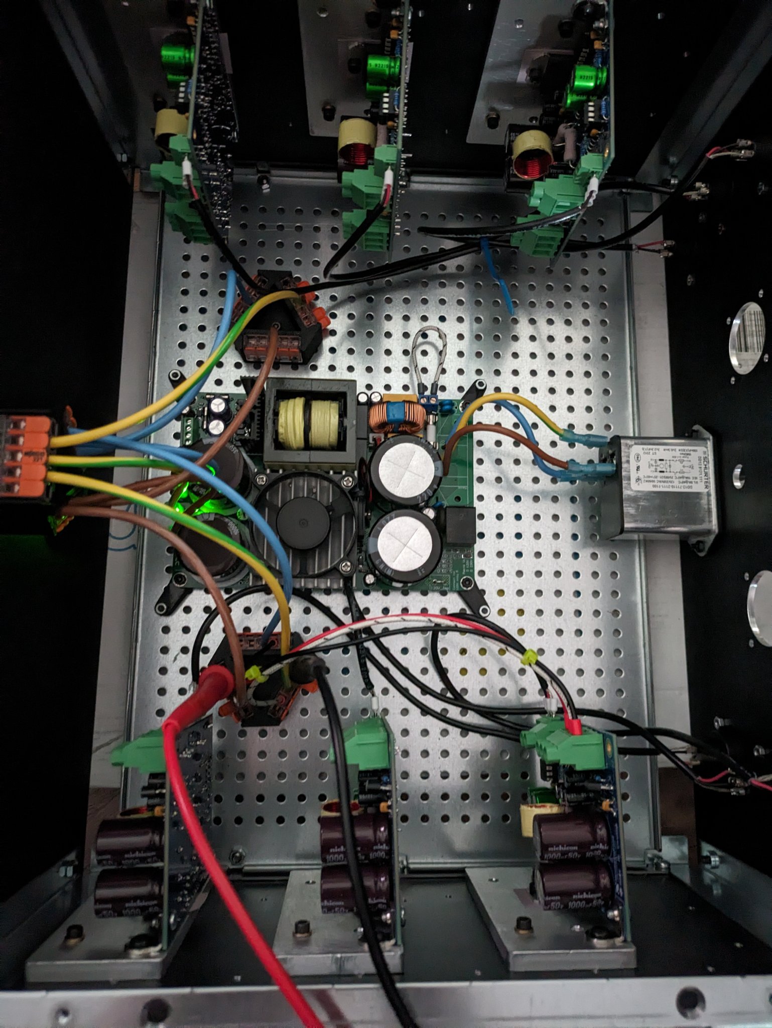

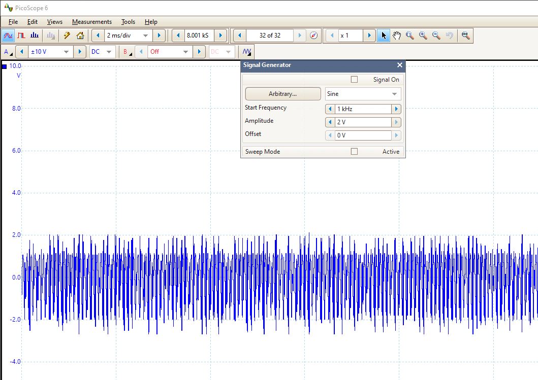

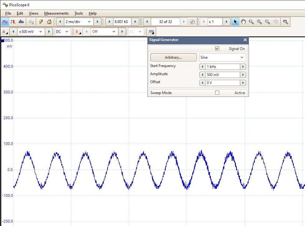

Coming back with some progress, things are mounted and wired. So I can test modules one by one.
Not sure I'm doing this correctly. I have no load on the output. And put 500mv sine wave to the input.
it's very noisy on the output with no input.
Should I be worries?

Your first scope pictures shows more like 50 mV sine wave. I'm not sure what to make of the second image. Is that the noise you're talking about?
You will get higher output noise with the input floating as the amp will then amplify the thermal noise of the 48 kΩ input impedance. That goes away when you plug a source in as the source output impedance (typ. < 100 Ω) will then be in parallel with the input impedance of the amp. That said, I'm not able to hear any noise in the speakers even with the input to the amp unplugged. I haven't measured in that specific condition, but I would expect the amp to have less than 100 uV RMS of output noise with the input floating. But with the input floating the input wiring has a good chance of acting as antenna, so you could be picking up all sorts of noise there that is then amplified.
If the noise goes away with the input to the amp shorted, I wouldn't worry about it.
Tom
