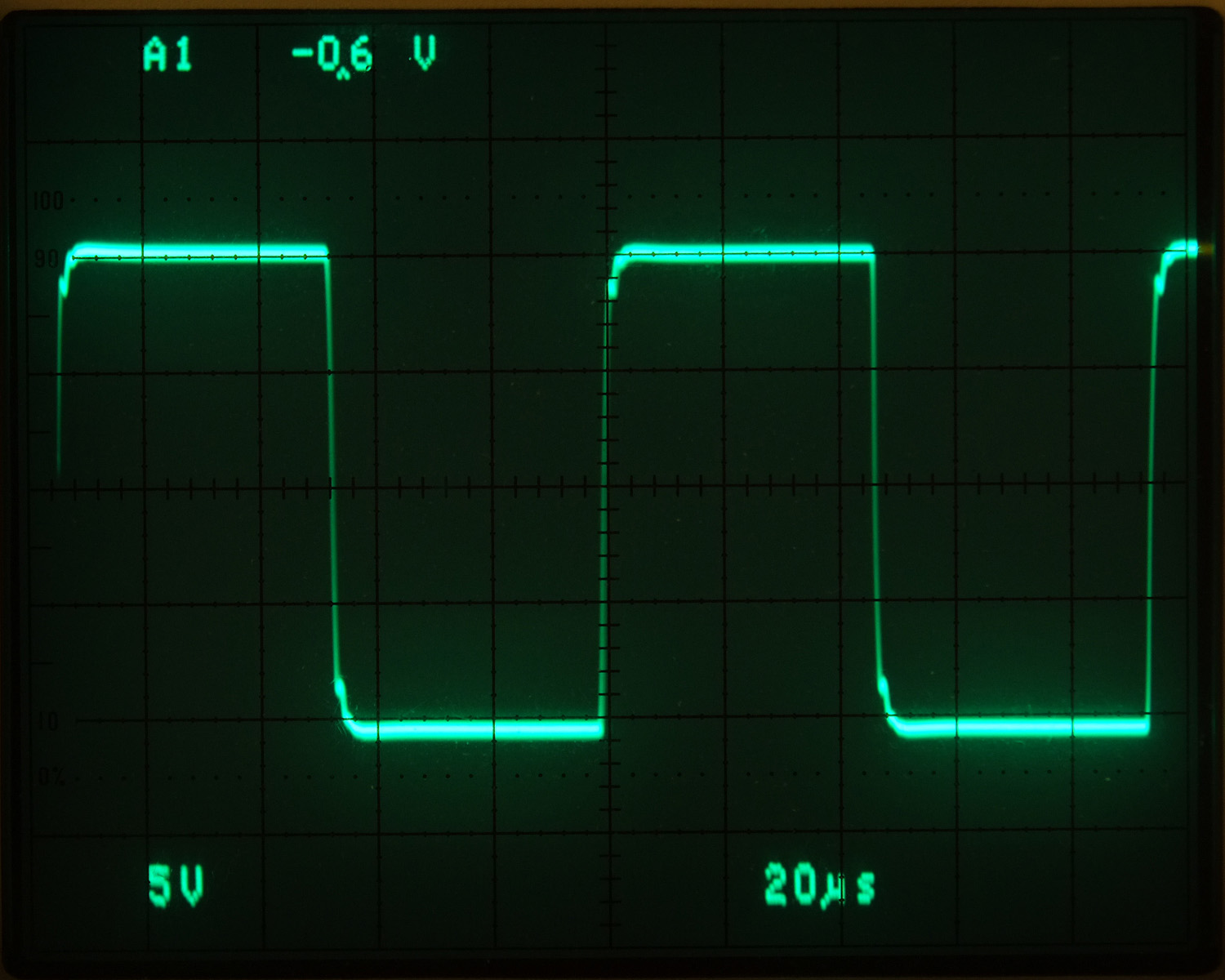

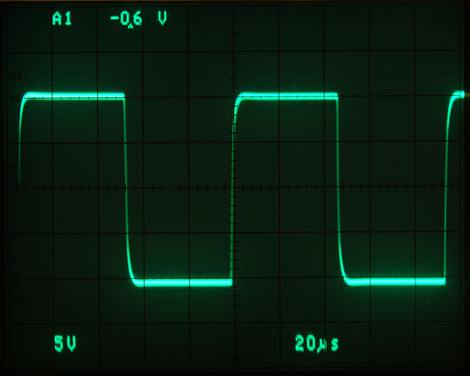

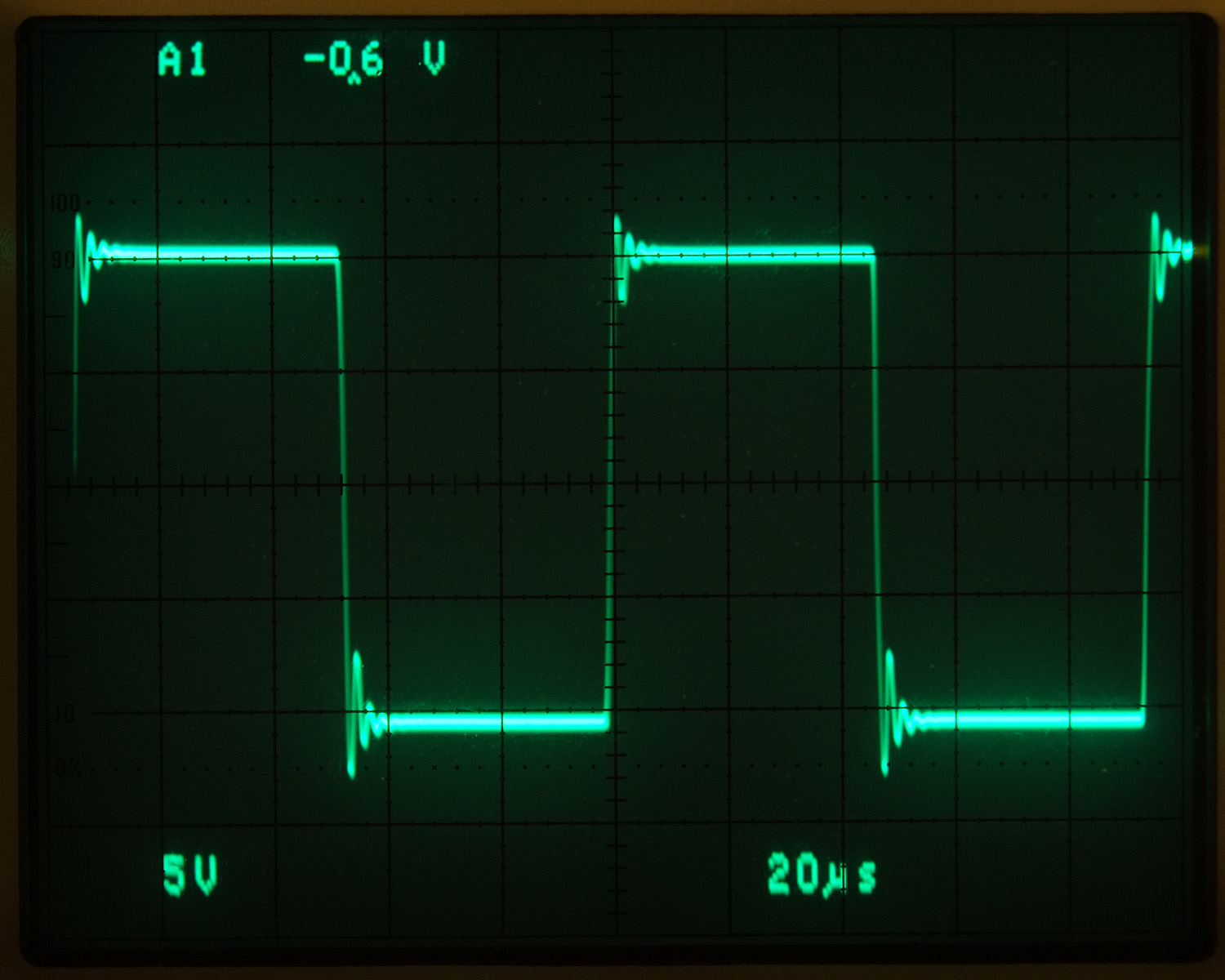

This spring I set out to design the Mother of All LM3886 Amplifiers. An amplifier so good that it would knock your socks off. But also an amplifier that someone with decent soldering skills could build if provided a well-designed circuit board. This design effort took a while and led to an interesting investigation of the capabilities of the LM3886. It also led me to produce an LM3886 design guide: Taming the LM3886 Chip Amplifier, which I will keep adding material to as it becomes available.
The Modulus-86 is my latest amplifier design. It is a composite amplifier using an LME49710 precision opamp to control an LM3886 power amp. The performance of the resulting composite amp, both in terms of measured performance and in terms of sound quality, is dominated by the performance of the LME49710. Hence, the performance of the Modulus-86 is absolutely stellar. One of the many benefits of the composite topology is that the power supply rejection is very high. This means the Modulus-86 performs as well on a real power supply (I tested with a toroidal transformer, rectifier, and 2x22000 uF) as it does on a regulated, $1200, lab supply (I used an Agilent E3632A). The excellent supply rejection is also one of the main contributors to the stellar sound quality of this amp.
In addition to the LME49710, an OPA2277 precision opamp is used for the DC servo. The use of a DC servo avoids the use of large capacitors in the main signal path.
The input to the amplifier is provided by a THAT1200 differential receiver. This makes it possible to use the XLR connections commonly found in pro audio. The THAT1200 provides performance rivaling that of an input transformer. When using differential connections, this minimizes the induction of hum and EMI, resulting in dead quiet during quiet passages in the music. The differential input can also be configured for use with the single-ended RCA connectors commonly used on prosumer audio gear.
The key features of the Modulus-86 are:

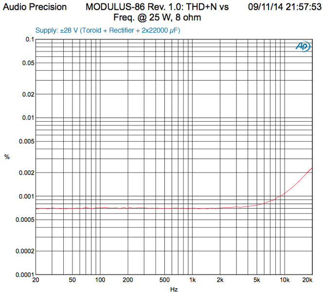

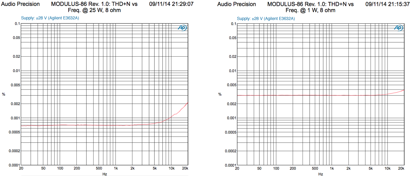

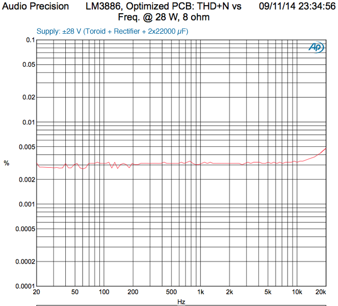

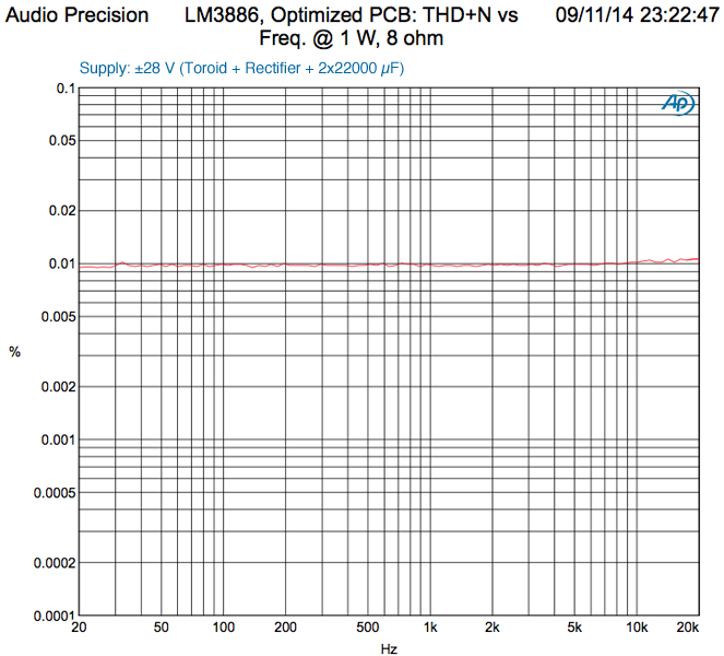

The THD+N is constant versus frequency throughout the majority of the audio range. The THD+N does rise slightly towards the high end as the loop gain of the amplifier rolls off. At normal listening levels (<1 W), the THD+N is perfectly flat versus frequency, resulting in incredible sound quality.
The differential input makes it super easy to use multiple boards in a bridge, parallel, or bridge/parallel configuration. All that is required to turn a stereo amp into a mono, bridged amp is that two wires are swapped. No component substitutions necessary.
The Modulus-86 has a gain of +20 dB (10x) for better gain structure in the end system. Should a higher gain be desired, the amp can be configured for +26 dB (20x) by changing a resistor. The circuit support the use of the THAT1203 and THAT1206 for gains of +17 dB (7x) and +14 dB (5x), respectively, should lower gains be desired for further optimization of the gain structure.
"But, but ... how does it sound?", I hear you ask. It sounds fantastic! The first time I turned on the Modulus-86 and started the music, I went “WOW!” before even making it to my listening chair. It was immediately obvious that this amp was something special. What struck me was the level of clarity of the reproduction and the deep quiet during quiet passages in the music. Talk about a huge dynamic range! I have played a few instruments in my life – including the trumpet and a brief stint with a drum set. It is especially important to me that metallic instruments (brass wind and cymbal for example) sound metallic and natural. This is an area that challenges many amplifiers and where the Modulus-86 really shines. The midrange is open and natural. The bass is precise and tight. What can I say? I really like it… The detail reproduced from Dire Straits, “Brothers in Arms” and “On Every Street”, for example, is out of this world. I am certain the incredible sonic performance is due to the stellar supply rejection and flat THD+N vs. frequency of the Modulus-86.
For those interested in more background information on composite amplifiers, I suggest reading the article, "Composite Audio Power Amplifiers" in Electronics Now, Nov. 1992 (pp. 38-44). This DIY Audio thread contains a few pictures from the article: composite amplifiers
For the impact of layout on the performance of an LM3886, I suggest looking at this DIY Audio Thread: http://www.diyaudio.com/forums/chip-amps/252436-lm3886-pcb-vs-point-point-data.html
Finally, for a more complete picture, I'll direct you to my Taming the LM3886 page: Neurochrome.com : : Audio : Taming the LM3886 Chip Amplifier

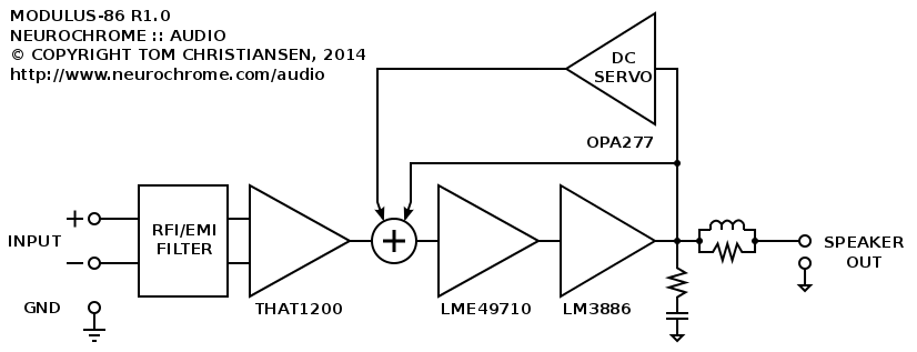

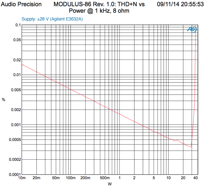

- Ultra-low 0.000061 % THD (1 W, 8 Ω, 1 kHz).
- Ultra-low 0.000067 % THD (40 W, 8 Ω, 1 kHz).
- Ultra-low 0.00038 % THD+N (40 W, 8 Ω, 1 kHz).
- Ultra-low 0.000067 % THD (65 W, 4 Ω, 1 kHz).
- Ultra-low 0.00041 % THD+N (65 W, 4 Ω, 1 kHz).

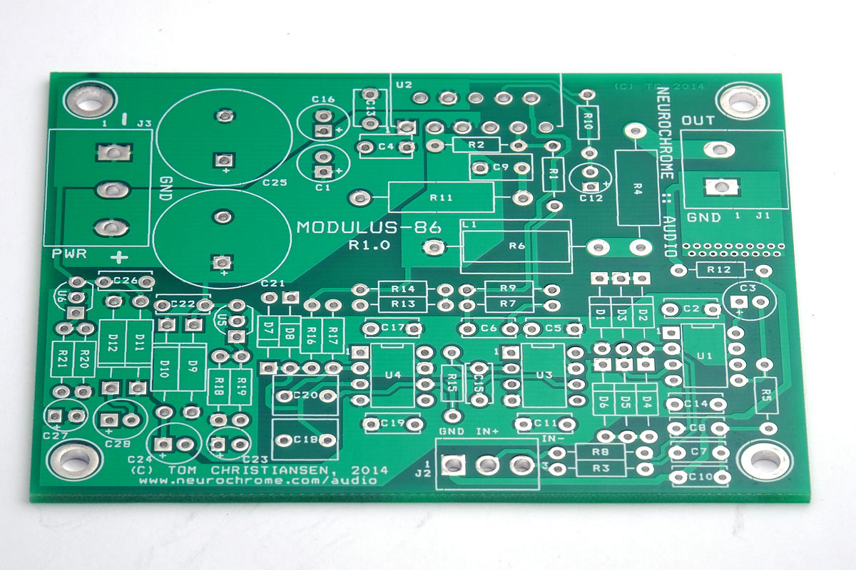

- Elaborate use of planes and copper pours to maximize circuit performance by minimizing supply and ground impedances.
- Low-inductance signal ground connects to power ground at one point only for maximum performance.
- On-board Zobel and Thiele networks for maximum stability even with capacitive loads.
- On-board EMI/RFI input filter and ESD protection.
- On-board low noise voltage regulators for the driver op-amp and DC servo.
- Power and output terminal blocks accept wire sizes up to AWG 10 (5.2 mm2).
- All leaded. Easy to solder. 90 × 70 mm board footprint.

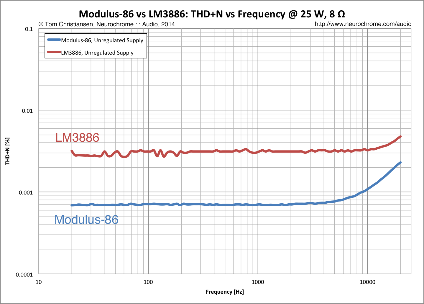

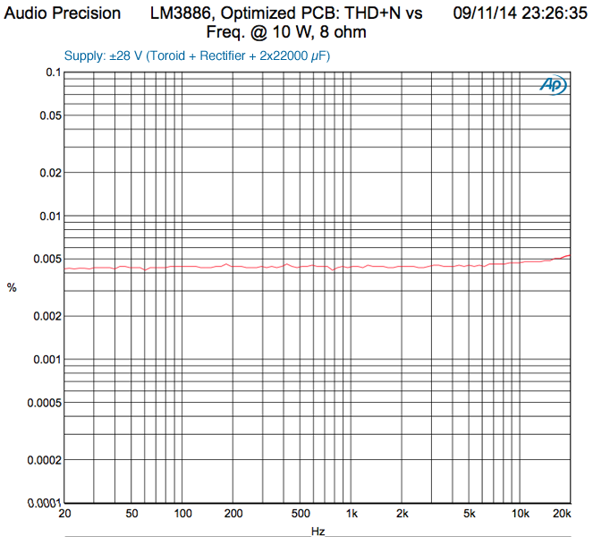

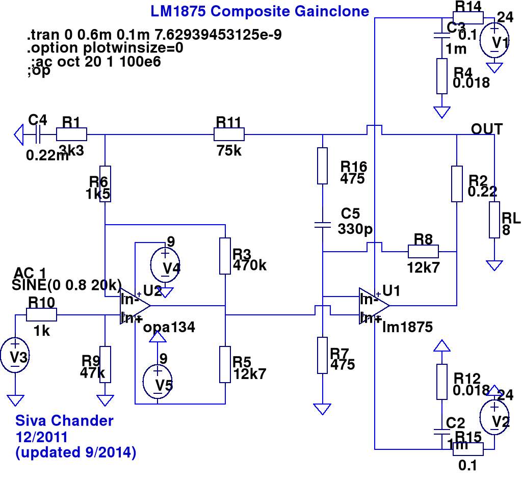

Congratulations - it looks like a continuation of the evolution of nested topologies like the MyRef, MiniRef, etc. We've just started discussion of a DC Servo for the MyRef this year, so it's good to see that you've already done a working implementation here. I hope I can borrow ideas from the DC Servo, if needed.
A few quick questions:
a) Is it possible to omit the differential input and use a single-ended input fed directly to the input of the LME49710 stage without too much surgery?
b) Are alternative opamps like the LME49990 usable without tinkering with the compensation?
c) Is the schematic free for perusal (mainly for the compensation schema)?
Also see composite opamp articles by Walt Jung but the one listed above is for lm1875 and obviously the most appropriate reference. Opamp rolling should be easy with no resistor changes.
THAT1200 has SE output so removal should be trivial.
Just my guesses as circuit is not in front of me but composite amps are pretty straightforward and well documented.
Thanks, I've seen some of Walt Jung's composite opamp schematics, and I've also borrowed some ideas from them a few years ago while designing the MiniRef - which uses a Jung-style nested voltage-series feedback loop, but with a Howland current-pump (transconductance block) like the MyRef for the inner high-power chipamp block. It works great, with excellent audible sonics, much like the MyRef, but simpler.
I missed reading the Electronics Now article (referenced above) then, but a quick perusal of the AD711-LM1875 schematic posted at these forums from that article shows that it is significantly sub-optimal - as jcx points out, it throws away a lot of loop gain in a resistive divider in an effort to gain stability (both the MyRef and Miniref are way more sophisticated in applying loop gain for better performance, both locally and globally).
It's possible to implement simple nested voltage/voltage composite opamp/chipamps with fairly trivial (though possibly heavy-handed) dominant-pole compensation - I found one such simulation schematic while digging through some 3-year old simulation files today, which appears to be stable as shown below:
Edit: IIRC, R5 was an attempt to bias the outer opamp into current-sourcing Class-A, which could be omitted or modified with a JFET CCS as needed.
Yep. You can do that. Pull the THAT1200 and connect two pins on the IC footprint with a piece of wire and you have an amp with a single-ended input. You will lose all the benefits of having a differential input, of course. Tradeoffs, tradeoffs...
The LME49990 is SMD only and I decided early on to develop the circuit using leaded parts for ease of assembly.
The LME49990 has twice the bandwidth of the LME49710, so you will have to tweak the compensation to compensate. In general, I don't recommend opamp "rolling" with composite amplifiers.

tomchr said:Ultra-low <0.0004 % THD (25 W, 8 Ω, 1 kHz).
I must be reading LM3886 datasheet wrong ....

I have attached a bunch of measurements of the THD+N for the Modulus-86 and the LM3886 by itself. These measurements were taken using a real supply (toroid transformer + 25 A rectifier + 2x22000 uF reservoir caps). The performance speaks for itself.
The difference between the measured performance of the LM3886 and the data sheet performance is due to the use of a real (unregulated) power supply. The use of a real supply means that the somewhat poor PSRR of the LM3886 becomes a large contributor to the performance. In the composite amp, all this is nulled out by the controlling opamp.
No. You're reading the LM3886 data sheet correctly. What you seem to be missing is that this is a composite amplifier where a precision opamp is used to correct for the imperfections of the LM3886. The controlling opamp (LME49710 in my case) is responsible for the stellar distortion numbers and for the superior power supply rejection. The advantages of composite amplifiers are well established in the literature. I've linked to several references in Post #1, I suggest starting with those.
In case of the Modulus-86, you can consider it an LME49710 that is capable of driving a speaker load and deliver up to 11 A of current.
Thank you. I have attached a couple of transient response shots and some comparisons between the LM3886 and the Modulus-86. I'll follow up with the clipping behavior later.
Yep. That's exactly it. The LME49710 control opamp provides an additional 140 dB of loop gain. This is used to drive the imperfections of the LM3886 to, practically, zero.
From the THD+N vs power measurement. The THD+N vs power is done with a 1 kHz test signal and 22 kHz measurement bandwidth. This is high enough bandwidth to include 21 harmonics and all the noise in the audio range. For the THD+N vs frequency, I have to switch to 80 kHz measurement bandwidth to get a realistic measure of the THD at 20 kHz. The additional bandwidth from 22 kHz to 80 kHz adds a bit more noise to the measurement, hence, the THD+N measurement versus frequency will show slightly higher numbers.
Really? Are you aware of any amp that's better? I'm curious...
How about some scope shots of overload/clipping behavior and recovery? If you also showed as compared to "normal" LM3886 based designs, even better.
Is the improved distortion spec due to the extra available gain by using the opamp in front of the 3886, increasing the available feedback?
Not sure where the "<0.0004 % THD+N" comes from?
Also one graph seems to show surprisingly high THD at 1 watt?
