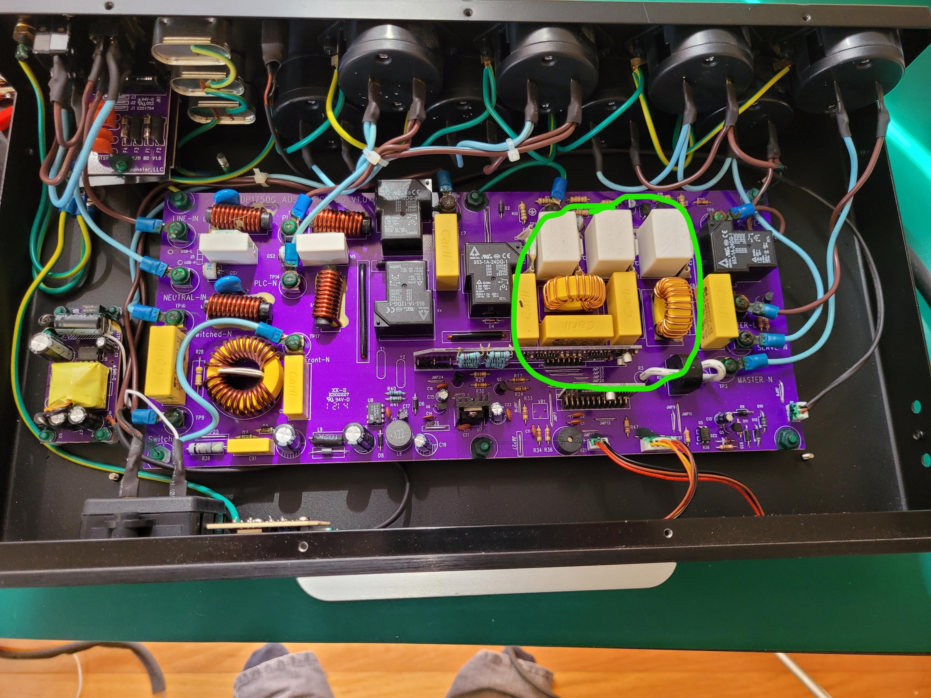

I have a 'Monster Power HDP1750G+ Powercenter' power conditioner which is making a loud buzzing noise.
The unit seems to be working fine other than the buzzing noise.
When you plug it in there is no noise. You turn the power switch on, and there is a low volume buzzing noise from the left hand side of the unit. Then after about 10 seconds a relay kicks in and a loud buzzing noise comes from the right hand side of the unit.
I have contacted Monster and they have told me that this noise is the surge protection circuitry kicking in and that I should dispose of the unit.
They have also advise there are no schematics available for this unit.
I have opened the unit up and everything looks clean and healthy (nothing looks blown or damaged).
The buzzing seems to be coming from the section with the varistors, chokes, caps, and relays (circled in the picture)
Has anyone come across this problem with a Monster power condition before?
I am suspecting it's the varistors which is making the noise and needs changing? Am I correct in my assumption?
If so, is it something I should do? Or is it time to dispose of the unit?

Use a plastic rod, or old ball pen, touch each part, works like a stethoscope. Will tell what is vibrating and causing the sound.
And check for dry joints.
The odd looking relay on the left of the circled area is possibly a relay with overload built in, those go faulty at times.
Another fault is that the DC to relay coils may be faulty: low voltage, bad diodes and caps.Those need checking too.
The blac ones are just plain 24V SPST relays, (there are two 12V and two 24V there.)
This - I like to use a wooden spoon :) - you should be able to find the component that is causing the problem... depends what sort of buzzing it is though.

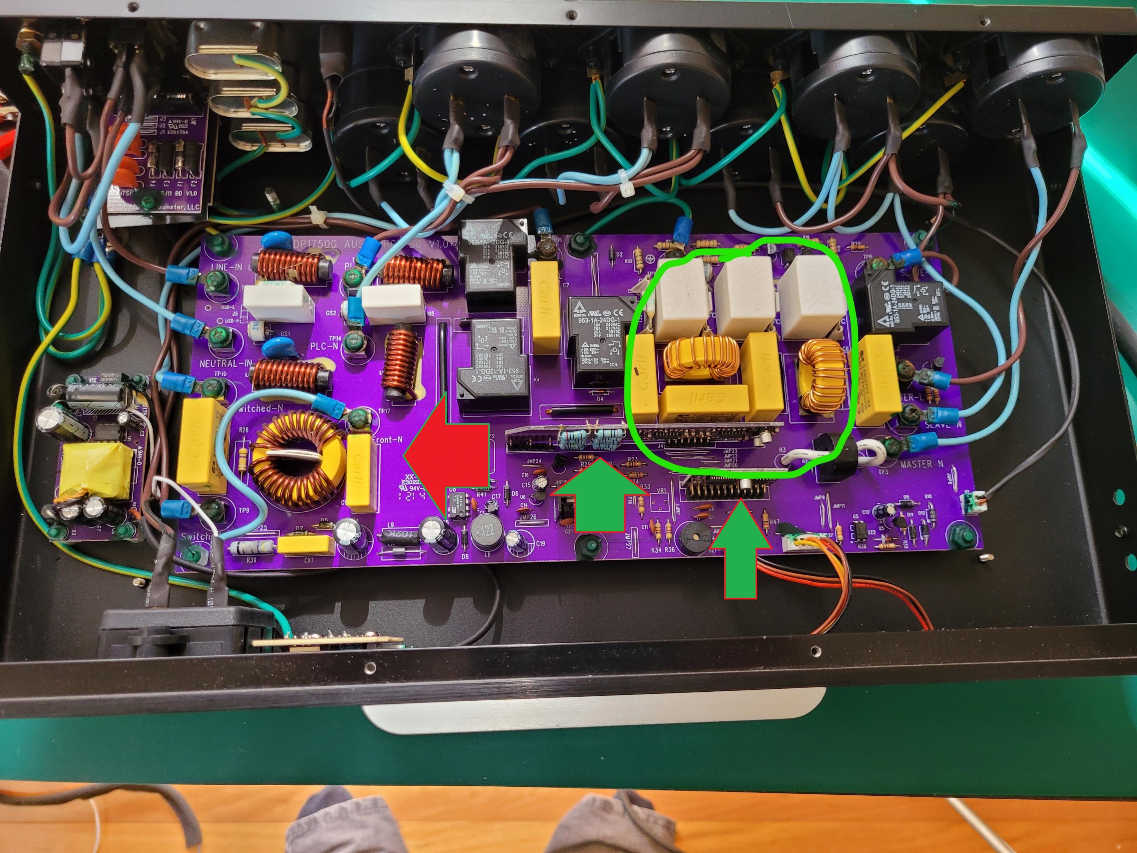

But it could be some sort of drive/control fault, I'd be interested in checking the small smd caps on the small daughter board
I have used a small piece of wood (chopstick) and have touched all those components and unable to see which one is making the noise.
The noise remains the same whichever component I touch, and I can't see any vibrations through the chopstick.
Is the daughter board the small board on the bottom left of the picture? If so I can't see any smd caps. Which ones are you referring to?
The two small boards next to the chokes on the right side...check those.
Vertical to the main board.
I have visually looked at used the stick on those boards, but no vibration.
They are soldered in, so I will go about removing them this weekend.
Should I replace the smd caps with smd caps? Or just normal caps?

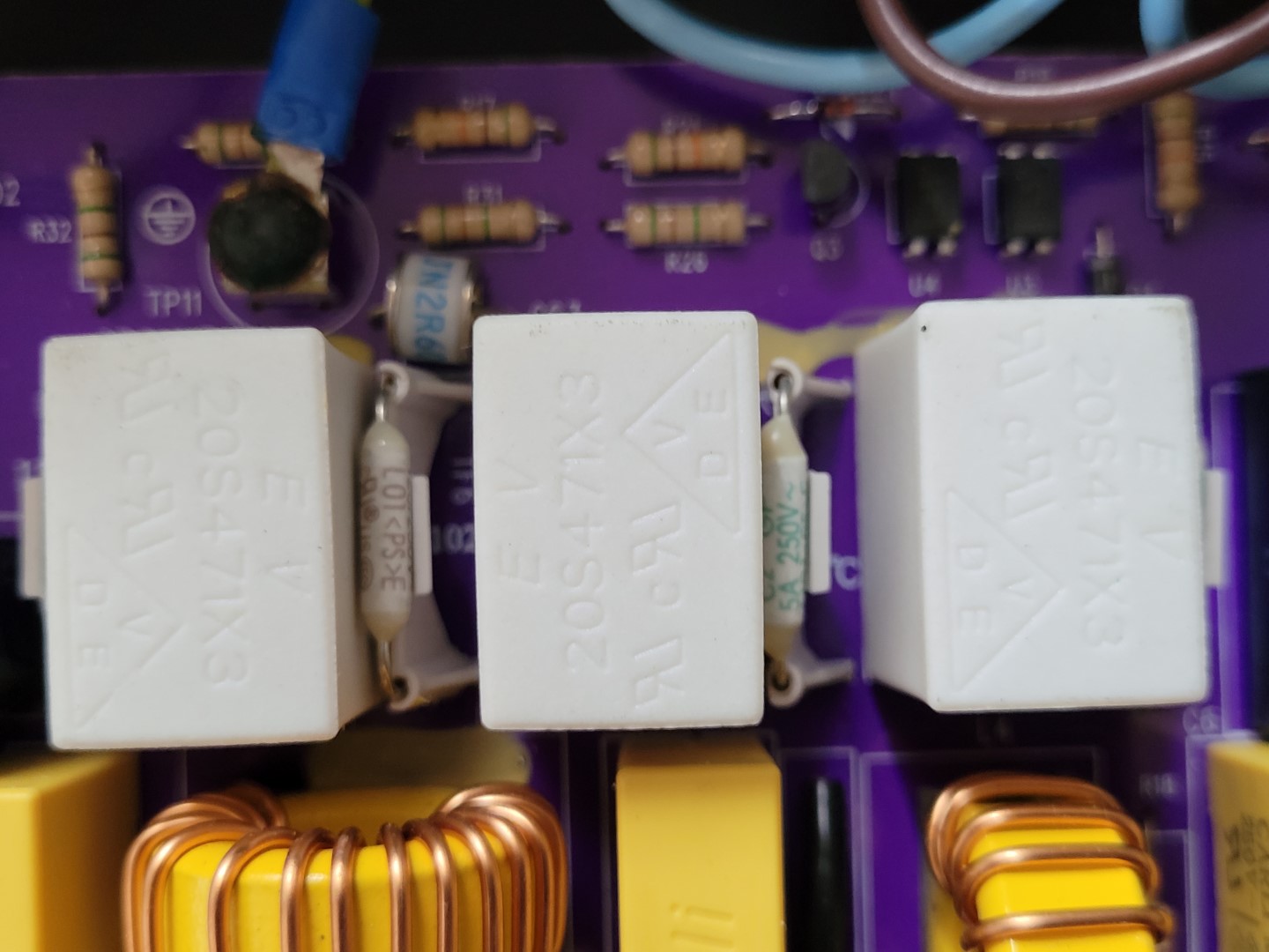

2. Where the big white things are (I think they're varistors) there are some smaller things which look like big resistors. I'm guessing they are fuses? All of them have green writing except 1 which has black writing. Is this an indication of anything? I have included a photo.

The daughter board possibly supply power to the relays, if power is not clean, the relays will buzz.
Even the transformer may buzz...
You will have to do a close inspection.
If it is a new topic for you, read up on line voltage stabilizer / regulator, the workings are described.
That will give you a better idea of what is going on.
Sorry didn't get a notification
Red arrow: motherboard
Green arrows: Daughter boards

Things near the white things
White things - MOVs (Varistors)
things with green writing are thermal fuses, set against the MOVs to 'monitor' temperature

Only to be done by someone that knows stuff:
Replace ALL the ultra bad quality Capxon electrolytic caps for known good stuff like Panasonic FC from a reputable distributor (NOT Ebay) with the same value/ratings and then test. The voltage to the relays is not as it should be which causes the relays to hum. I have noticed this in a few similar units. Capxon is one of the brands known for bulging/blowing electrolytic caps and spilled electrolyte eating PCB tracks. This especially counts when they are used in SMPS like here. Make a list and find the caps with the same values/ratings/physical sizes, Panasonic makes these in various sizes while having the same ratings!
I would also inspect and clean ALL screw connectors as I see abnormal residue/corrosion besides the sealing stuff they applied. This is all mains voltage related stuff so don't have average Joe doing this. If you don't know to locate the buzzing with the easy screwdriver trick then have it done. Please note that waiting for it to cure itself is something only happening in fairy tales.

I would replace the MOVs since when they do their job of shunting a surge it often damages them which may be the cause of your noise. They are probably the most vulnerable and fragile parts of this kit. Also Harbor Freight Tools sells a cheap mechanics stethoscope that may get you closer to the buzz.
I have tried looking for replacement MOVs but unable to find it using the numbers.
20S471X3
That is what's written on it. When I search for it, all I can find a images of it, and some compliance documents with the numbers written.
Does anyone know what a suitable replacement would be?
I have tried the screwdriver trick. Tried with a wooden chopstick also, but unable to hear/feel which component was buzzing.
