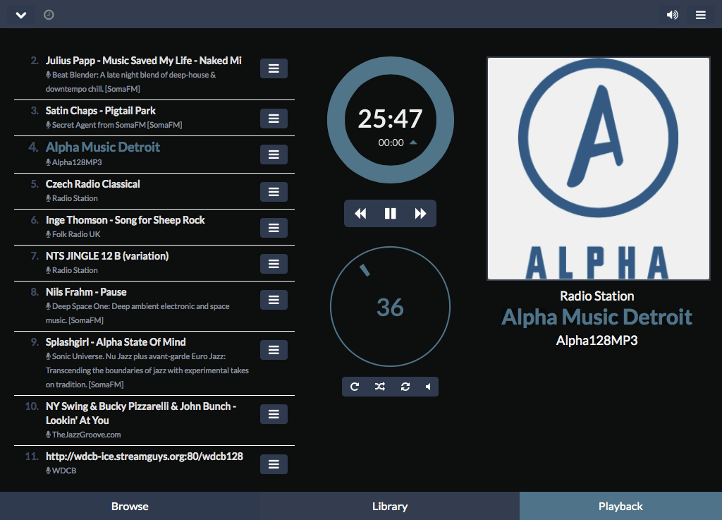

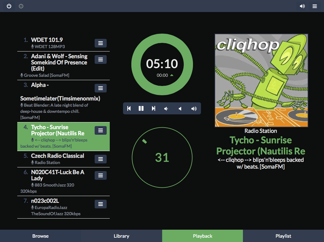

Here's a brief update on release 1.8 (late April) There may be a Test Release #2 before the final release.
The attached screen shots show a prototype of the new Playback panel layout with integrated playlist and unified control bar, new System config page with comprehensive name change and timezone select features and a streamlined Sources page.
Enjoy!
See release notes below for details.

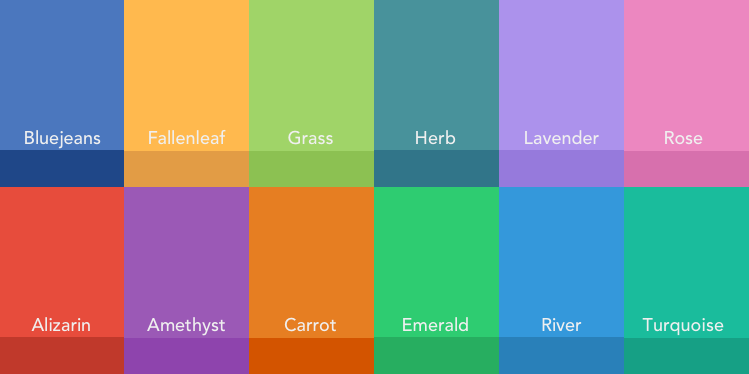

- NEW: Choose Theme color from Customize popup

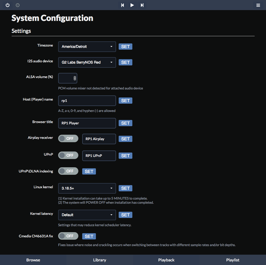

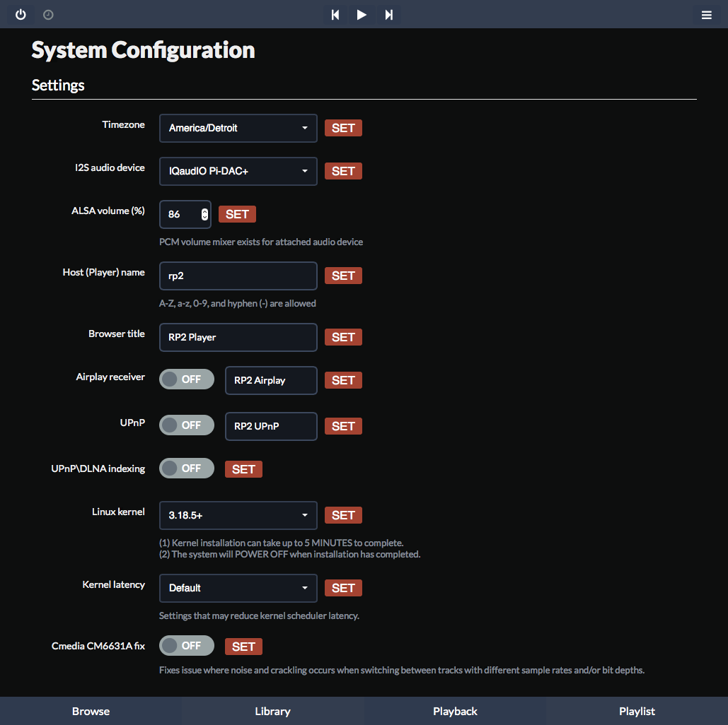

Here's a few more release 1.8 screen shots showing the new PCM volume setting feature and updated layout for the new Playback panel with integrated playlist.
The blue screen shot shows that for BerryNOS Red which has no hardware volume controller we get "no PCM volume mixer detected" and no "SET" button. The orange screen shot shows that for IQaudIO DAC+ which does have hardware volume controller we get a volume level and ability to change it.
This feature provides an easy way to set the 0dB point for configurations where the audio device has a hardware volume controller and either MPD software volume is being used or an external volume control is being used.
