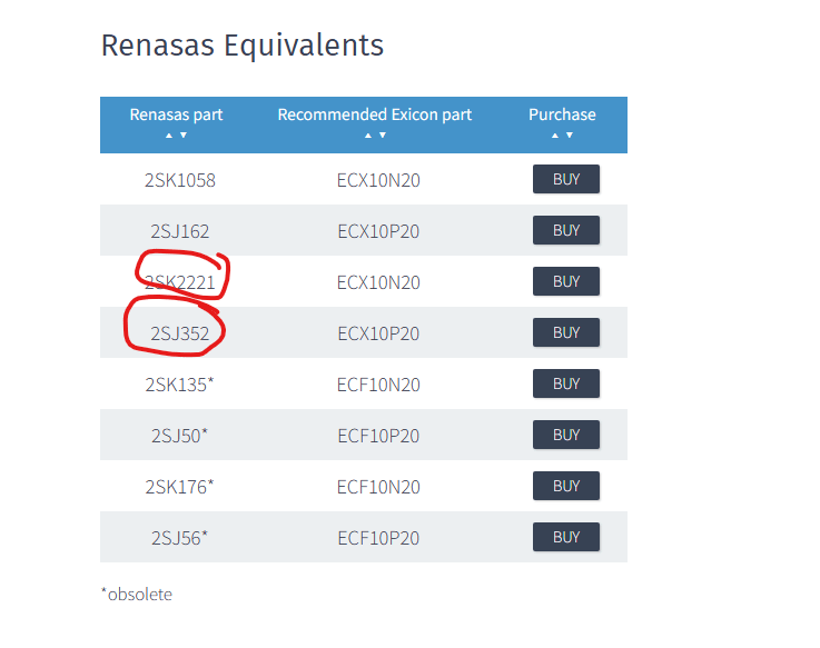

The suspect could literally be 'anything', not even a FET.
These parts look like Lateral FET's to me (going off the data sheet characteristics) and the only reputable source of those are new devices from Exicon.
https://www.exicon.info/products.php
If you have even momentarily reversed supply polarity there could be other damage... not possible to second guess that without testing.
You need to work methodically, use a DBT (dim bulb tester) to limit current that can be drawn and fault find in the normal way. The DBT helps prevent damage and blowing of output transistors. I would definitely suspect your Chinese replacements as being fake though.

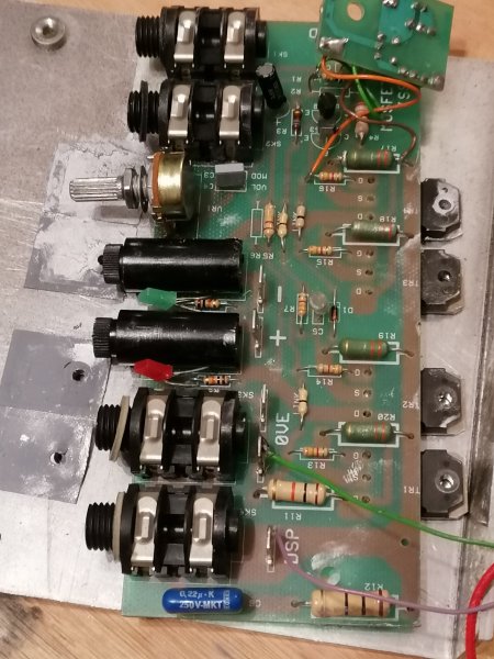

There aren't a great deal of components on the board, 7 transistors (incluing the 4 MOSFETS) and a bunch of resistors and a couple of caps. I have a good working board on the other channel and using a multimeter I comparing each component and the only difference i can find is the MOSFET - the 2 x N channel are on order but I fear will be fakes also.
There is one other small transistor that is giving me a different reasding, it is a BC558 with a negative base pin. On the good board I get a reading of 843 on the emitter and 808 on the collector. On the channel i am fixing readings are 774 and 748 respectively - not sure if that is significant?
The BC558 is a common device if it needed them. I'm not quite following what you mean by a 'negative base pin' Transistors really have to be checked out of circuit to stop interaction with other parts. The BC558 is a PNP device and the base should read to both collector and emitter provided the black meter lead is on the base and you use the 'diode check' range on your meter. There should be no reading between collector and emitter with the red lead on the emitter. I wouldn't suspect the transistor at this point though.
Looking at the board and it appears the FET's are in parallel pairs which suggests for testing you could use just one complementary pair (N and P channel). I would strongly recommend using a bulb tester though.

I managed to pick up some replacement FETs - fitted and bolted down and sound quality is great.
However, after the amp has been powered down over night, when I first power it up I get quite bad humming sound, Today when this happened I turned it off then back on and the noise began to rise, I then adjusted the volume and a flapping sound began to rise. Powered off and on the third attempt there was just a humming, like a bad earth when a turntable hasn't had the ground connected - but it was stable and didn't rise.
When I add a sound source and play something the humming/feedback/flapping stops and playback is fine. Would it be a bad idea to add some caps across D and S on the FETs?

So it works Maybe there is a problem with the input sockets if it consistently behaves when you connect something to it and play something. Are they 1/4 inch input jacks or phono sockets?
1/4" input jacks yes. Just tried again I didn't get any of the flapping, just a bit of a hum when I switch on, the hum is there without the input source plugged in.
Seems that this channel is getting a little warmer than the other - as mentioned FETs are now screwed down. It could be that a previous underlying issue meant this channel ran hotter than the other before but I wasn't really paying too much attention.
Maybe I just need to let it play for a period of time and monitor?
Regarding the cap mod, apologies should have been between G and D, not D and S!

It might be worth cleaning the input jacks and particularly if they have contacts that lift up and open as you plug anything in. In any case some clean paper towel soaked in iso or switch cleaner and twirled in the socket is no bad idea to clean them.
If there are no bias presets on the board then it will run at fixed bias and differences in FET characteristics would change the current (and hence the overall heat). Without examining the circuit it is impossible to tell you how to alter that.
You could measure the DC voltage across those four large resistors that go to the FET's. Are they orange (0.33 ohm) or red (0.22 ohm) bands? The one next to the top one looks discoloured or burned. Worth checking it is OK.
Typical current per FET would be 100ma so you might expect to see about 33 millivolts or 22 millivolts across each resistor depending on value.
