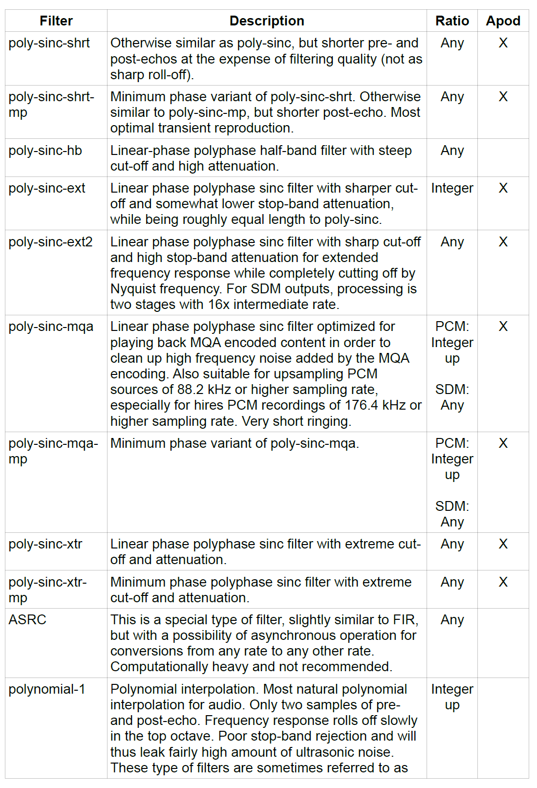

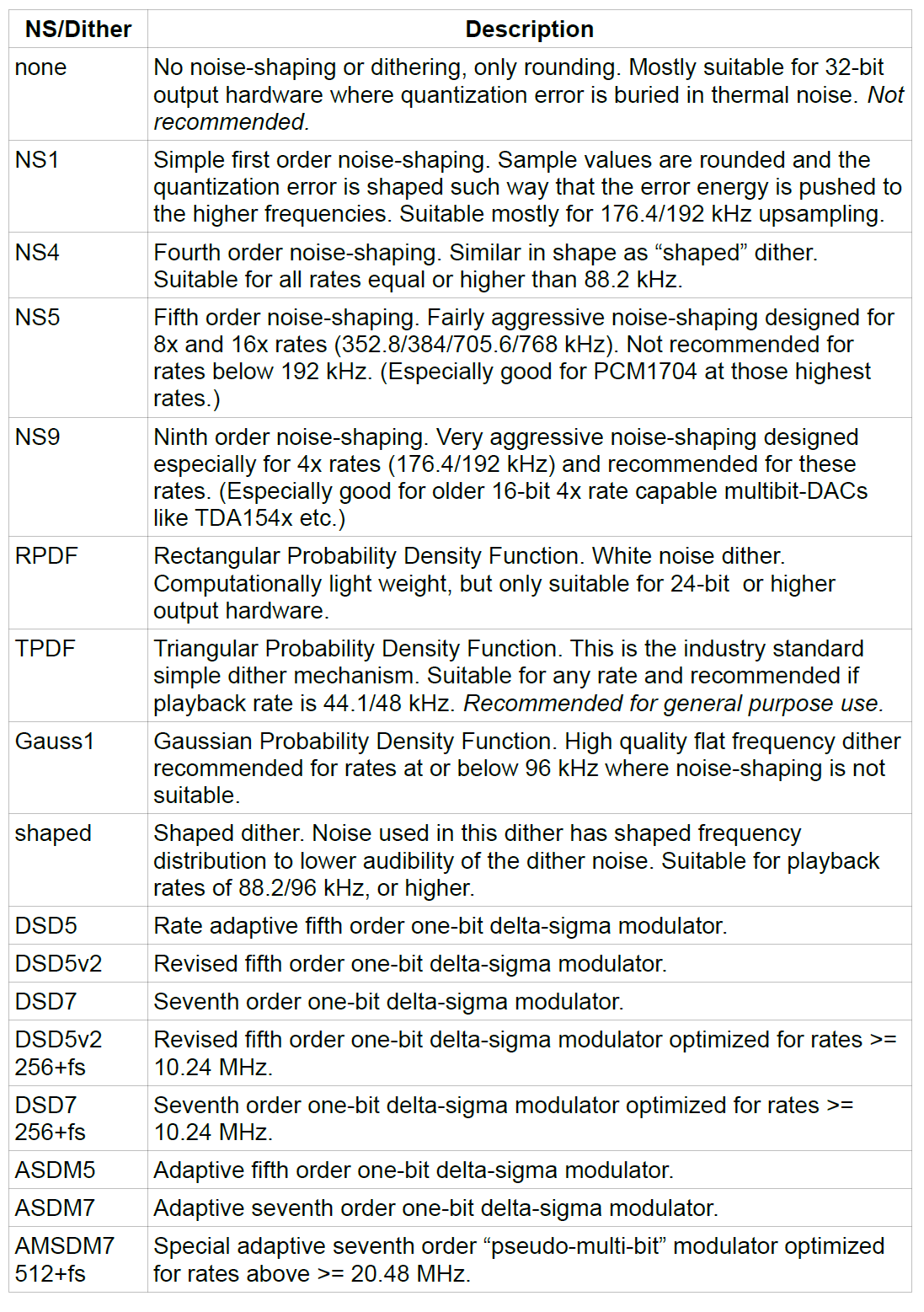

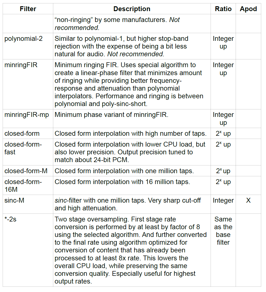

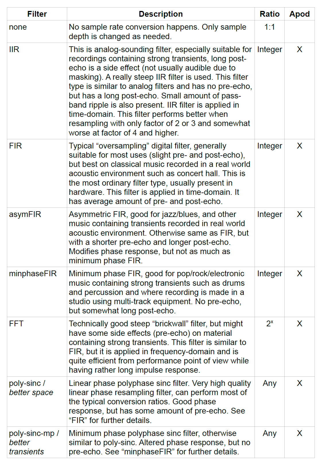

I came back with some interesting data. Tried Audirvana, turned out V3 is only for Mac. On windows only SoX is offered at 300k max tap. Disappointment. Together with the terrible GUI, I would hesitate to use the software even if they pay me the $100 listed price.
Then tried HQPlayer Pro (filters should be same as Desktop). I was amazed by the options offered (see attached manual for details). closed-form-M (16 million taps! Note the Chord Dave uses its own closed-form filter at 164K taps) had weaker bass than poly-sinc-xtr, and probably less natural too. They consume about 3% of CPU. sinc-m (1 million taps) is not recommended as it consumes more resources. Indeed, it actually offloads to CUDA every now and then. Consumes about 3% CPU plus the occasional GPU usage. Very well-constructed software. I couldn't quite hear the difference between sinc-m and poly-sinc-xtr, they're probably similar anyways in resampling performance. I didn't spend much time on other poly-sinc as they're probably shorter and they do appear to consume slightly less computation resources.
Now the most interesting part. Compared to fb2k SoX, the poly-sinc-xtr is clearly softer and more natural, in the exact same direction of change from the FPGA filters to the SoX filters, as far as I can tell. I would conclude that poly-sinc-xtr is superior by quite a wide margin. Can't find exact details on the filter construction but I would guess that it's in the 1M taps ballpark based on its similarity with sinc-m in the verbal description.
Used NS5 noise shaping because it seems the most suitable for 353/384Khz upsampling, but can't say I hear a difference. I trust that it's theoretically beneficial though.
Test track is Tchaikovsky Sym.5 4th movement by LPO/Mravinsky in 24/96. Instrumentally complex piece imo and sounds quite horrible with FPGA filters, relatively in this case of course... It's probably above average in the range of frequencies/instrument timbres that it showcases. Mostly used 3:00-3:30 and 4:00-4:30 in the A/B tests.
Unfortunately we can't use HQPlayer filters in Fb2k... the fb2k interface, though simple, is still miles ahead in my opinion...
Edit: more info on the filters by the person who wrote the HQPlayer manual: hqplayer resampling filter setup guide for ordinary person - General Forum - Audiophile Style

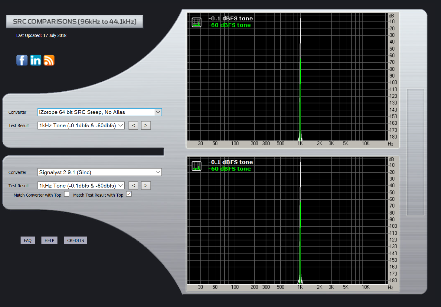

No need for superlatives; everyone has to try it out.
Latest version of HQPlayer Desktop is 3.25.2. You probably don't have to pay $150 to try out the sound, for as long as you want...
This is probably nearly perfect for FIR1. If DSD512 still gets converted to 384Khz PCM inside dam1021 then there's no point in giving your CPU extra work. 353/384Khz input is the best we can do.
Soren can you test this and see what you think? Also, could there be a chance that freeing up blocks from FIR1 duty can give FIR2 more resources to perform better? This is something that cannot be outsourced to PCs.
Now we might actually have a genuine advantage over regular R2R chips. I wouldn't trust PCM1704 to x8 oversample my 96Khz input. As for TotalDAC, we can ask to compare waveforms.:) Too bad Denafrips got way ahead in the THD game.
Btw, the reduced harshness allowed me to turn up the volume by ~4db without any discomfort, just realized I was set on -23db when I usually don't go higher than -27db after listening to an entire symphony... No doubt greatly improved dynamics. You Europeans need to wake up and try this...seriously

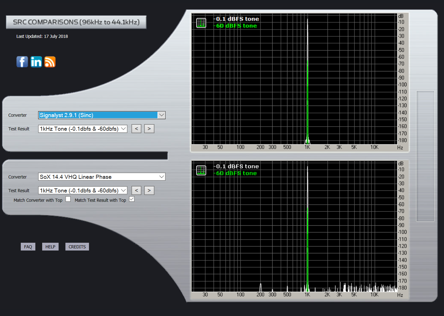

libsoxr is inferior, not suitable for Soekris products. :) Get a trial for HQPlayer Desktop 3. I shouldn't say this but Russians have posted cracked exe for it so feel free to try it out.
Dynamics is important but naturalness is the most critical improvement imo...dynamics kind of just follows... (who knows how these causations work anyways....:)) Check out violin performances or orchestral pieces with certain percussion or brass instruments etc. High frequency harshness reduces even further going from SoX to HQPlayer
Edit: you don't want this in your system...see picture. Signalyst is HQPlayer
Edit2: in HQPlayer, check "auto rate family" and choose 384khz as max for 44.1khz to map automatically to 352.8khz. Just found out about it.
