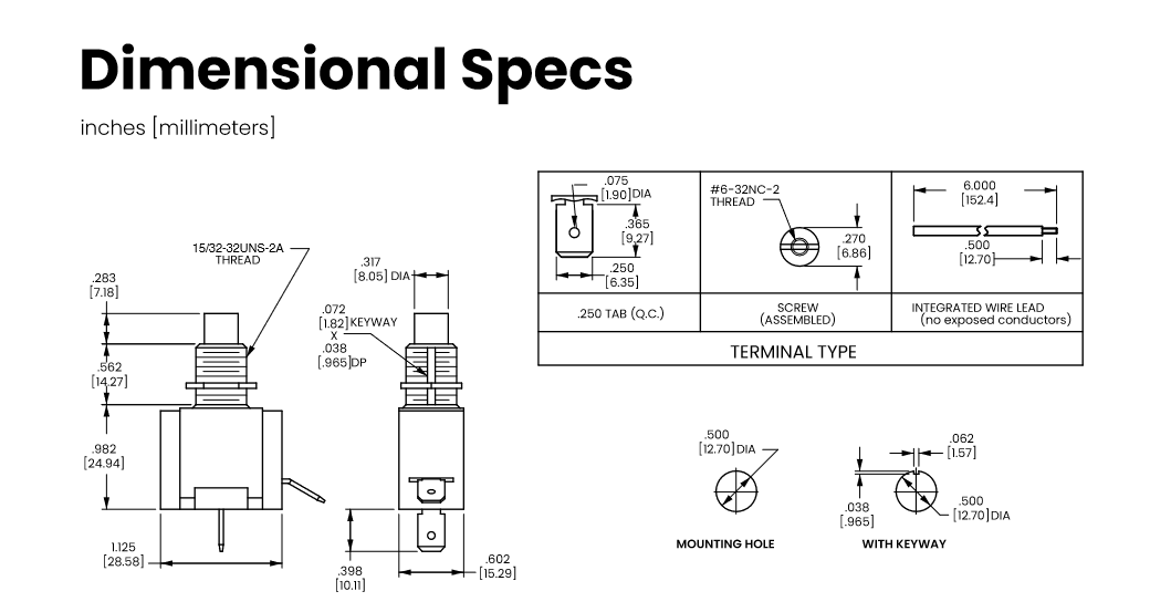

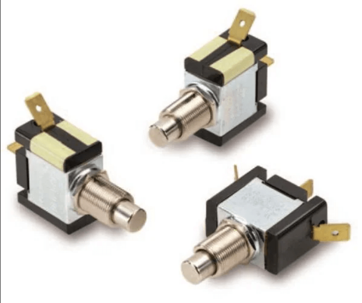

Thanks for all the replies. I finally found a phone# for EBC Electronics and called them. They apologized for not sending the email but said it will be shipped within the next two days.
How did your new switch work out, @henrylrjr ?
The switch itself looks indestructible to me, but the plastic button cap seems fragile...
