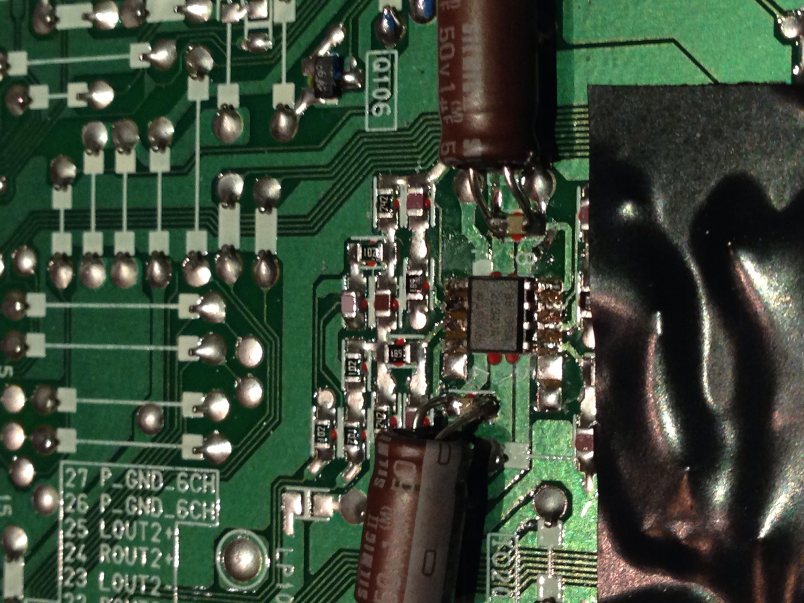

Hi all!
I just finished making the mods to my Sony NC650V
I just wanted to modify the primary stereo main outputs. I put in an AD1820 opamp to replace the factory one. I removed the 47uF decoupling caps and removed the BJT muting transistors. I also bypassed all the internal wiring and tapped off to my own new RCA jacks that I placed on the rear of the chasis.
All in all, I'm very impressed so far. The bass resolution and detail has dramatically increased, and the high end seems much more neutral. The rash sound in the midrange is gone, likely due to the removal of the caps.
For reference, the diagram is wrong in the Sony manual. It took me a while to figure this out. IC202 is labeled ast the "front 5.1" audio amp. The front channel 5.1 opamp is actually IC203, which is labeled as the rear 5.1 outputs. And IC204 which is labeled as the center/woofer 5.1 is actually the rear 5.1 outputs. And IC206 which is labeled as "audio amp" (presumably the main L/R outs) is actually the center/subwoofer output for 5.1. I should have learned to double check the labels by tracing the wires PRIOR to the removal of parts on the PCB, but... as they say, hindsight is 20/20.
So, to be clear, the main L/R output opamp is actually IC202. I removed caps C247 and C248 and transistors Q214 and Q215. I also ran a "jumper" wire across where the two caps used to be so that the original L/R RCA jacks would work if I ever wanted to use them at a later time. I tapped off these "jumpers" to solder some 30awg magnet wire to be run to the new RCA jacks that I mounted to the rear of the case. I also tapped off the collector pads of the two transistors to run a solid signal ground connection wire to my new RCA jacks.
My logic for adding additional jacks was that it seemed to be the easiest way for me to get around removing additional resistors (R239 and R240 - the 470ohm resistors serving as current limiters to the original muting transistors) and also the resistors in series after the relay switch (R307-R310). I was also to bypass the relay switch by adding my own RCA jacks.
I didn't, unfortunately, get to tapping into the Ever11 power supplies for direct, constant power to the opamps. The next time I open it up, I'm going to attempt making this power supply mod (thanks to Chad [HifiZen] and Dorkus). I'm also planning to add some/replace some of the power supply caps at the opamp pads. I'm wondering if just using the 47uF caps that I removed before as decoupling caps might work. Perhaps a just grabbing a couple nice SMT 1.0uF tantalum caps from work might do the trick too. I'm sure they have a much lower ESR and would probably provide better bass resolution than the old decoupling caps. I just didn't have anything here that would serve this purpose well this weekend, so I was trying to think of some alternatives.
BTW, thanks Dorkus for the info on the muting transistors. It makes plenty of sense now that you point it out. I never put together the fact of varying impedance through the Vce points on my own, but it now rings a bell. Perhaps I'll go through my physics of transistors book during lunch tomorrow to try to get back in shape on all this stuff. I wish I would have had some more practical appliations experience with this stuff... even with all the lab time I had, I didn't always get the whole picture...
OK - well, thanks Dorkus and HifiZen for the notes on your mods - hopefully mine will be ambition for someone else as well.

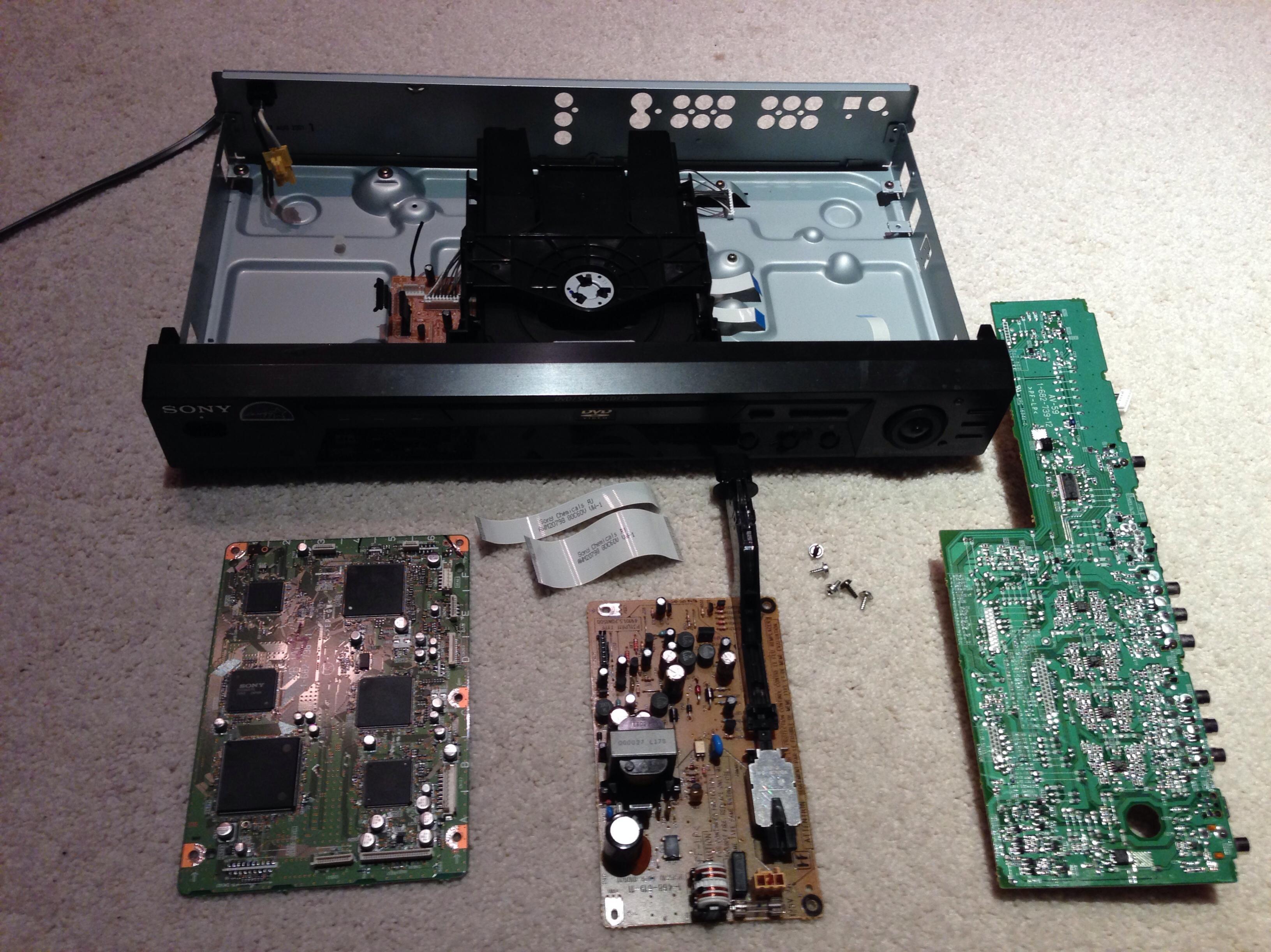

I started by completely breaking down the unit, and removing all the boards (not that it was necessary, I just wanted to get a look at everything). The bulk of the work would be done on the audio board, and here was my 7-step plan:

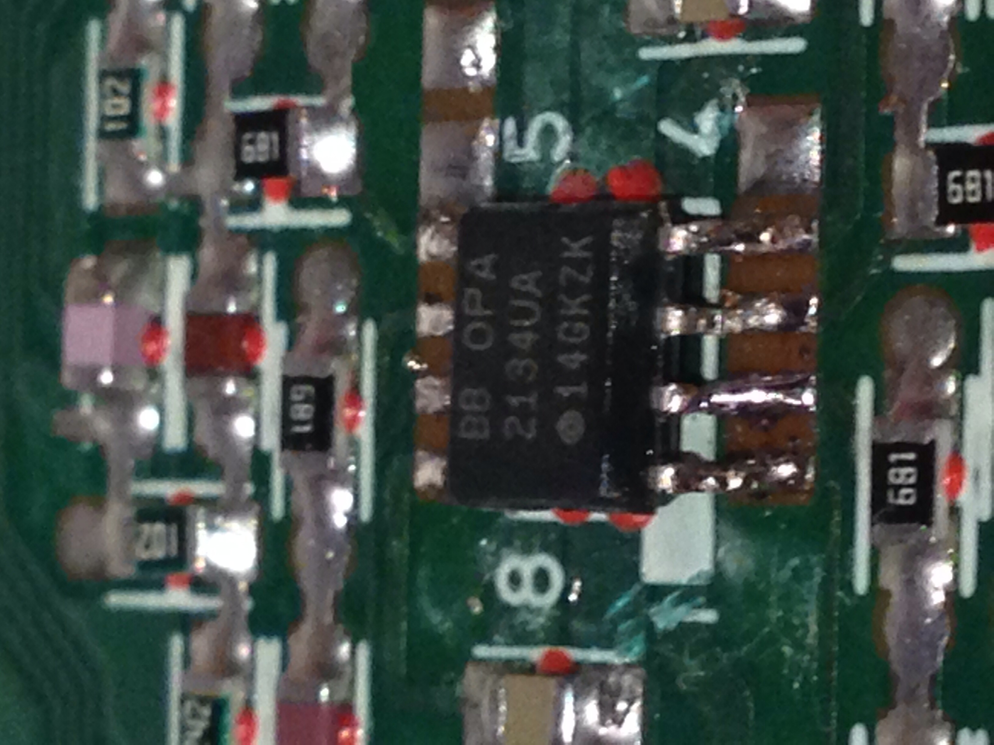

1) first, I patiently cut the pins of the existing opamp using a utility knife. Definitely not the right tool, but I worked slowly and was very careful. With the pins cut, as I was lifting the pins the IC just popped off. I was worried for a second that I broke a trace, but examination under the magnifying glass showed no damage. Whew!
2) Removing the existing stereo RCAs was very simple - significantly easier than on other units that I've worked with.
3) No for the tricky, delicate part - soldering the OPA2134 to the board. I tried to remove the remaining pieces of the original opamp pins using 30-watt iron, but was really worried about breaking the traces (as others have experienced with this unit), so after a few attempts, I just decided to solder the new opamp on top of the remaining pins. I cleaned the whole area with isopropyl alcohol, positioned the magnifying glass, and went to work. I first soldered the ground pin (BTW...I used very small gauge silver solder), just enough to secure the IC to the board. Then, I went to work on the other pins, again very patiently. It took about 15 minutes, but I got it done. It's not pretty, but it's good enough for my first SMD!

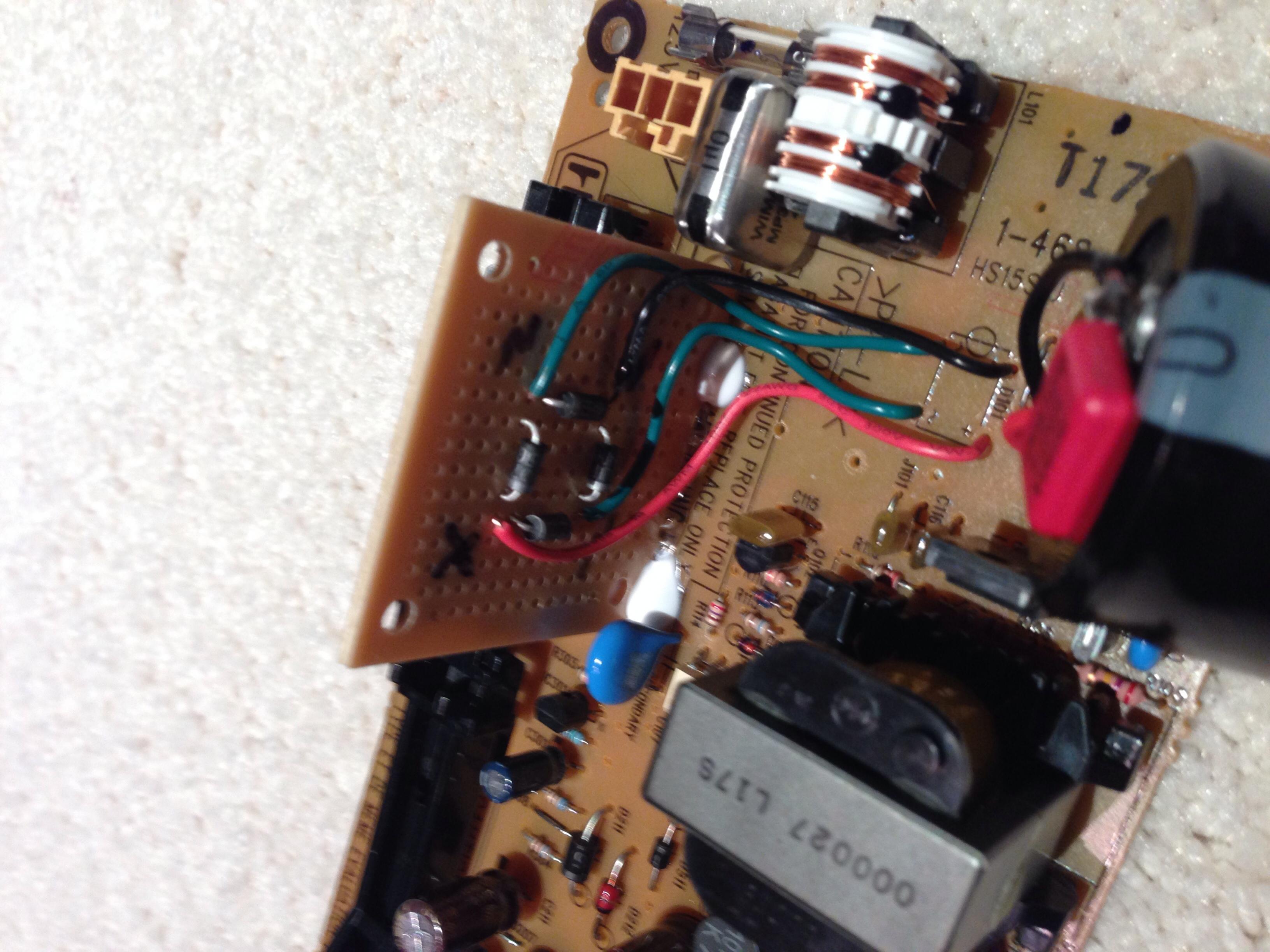

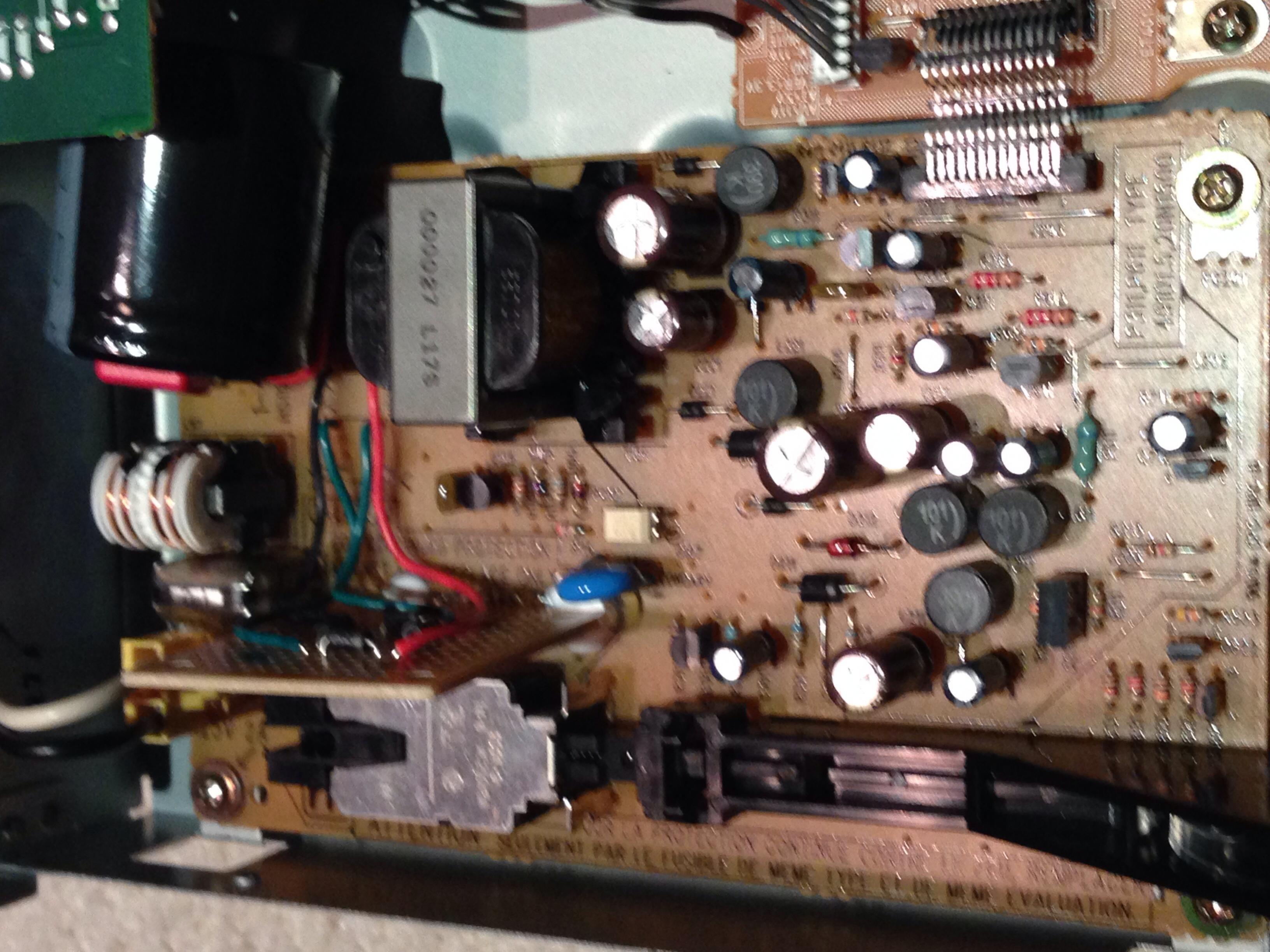

I had also decided I was going to make a couple modifications to the power supply, which everyone has acknowledged is the weak point of this player. I had some components on hand, so I came up with this plan (all on the primary side of the supply):
1) replace the input filtering film capacitor with Wima MP3-X2 type
2) replace the IC bridge rectifier with good quality, high-speed rectifier diodes
3) replace the smoothing capacitor with a 400v, 330uf monster
Here's how it played out:
1) easy enough
2) I created a bridge rectifier using the diodes on a small proto board. Had to mount it vertically to get it to fit. looks pretty good, I think.
3) the cap I used was pretty big, and it didn't fit, so I had to mount it horizontally, using lead wires. I also bypassed with a .01uf Wima.
Finally, time to put everything back together and test it out. Of course, in my haste, I never game the unit a good listen before doing these mods, so all I could do was compare to other players I had readily available. Overall, I really enjoy the sound. Very wide soundstage, great bass, really nice highs. But, shines in the mid-range.
