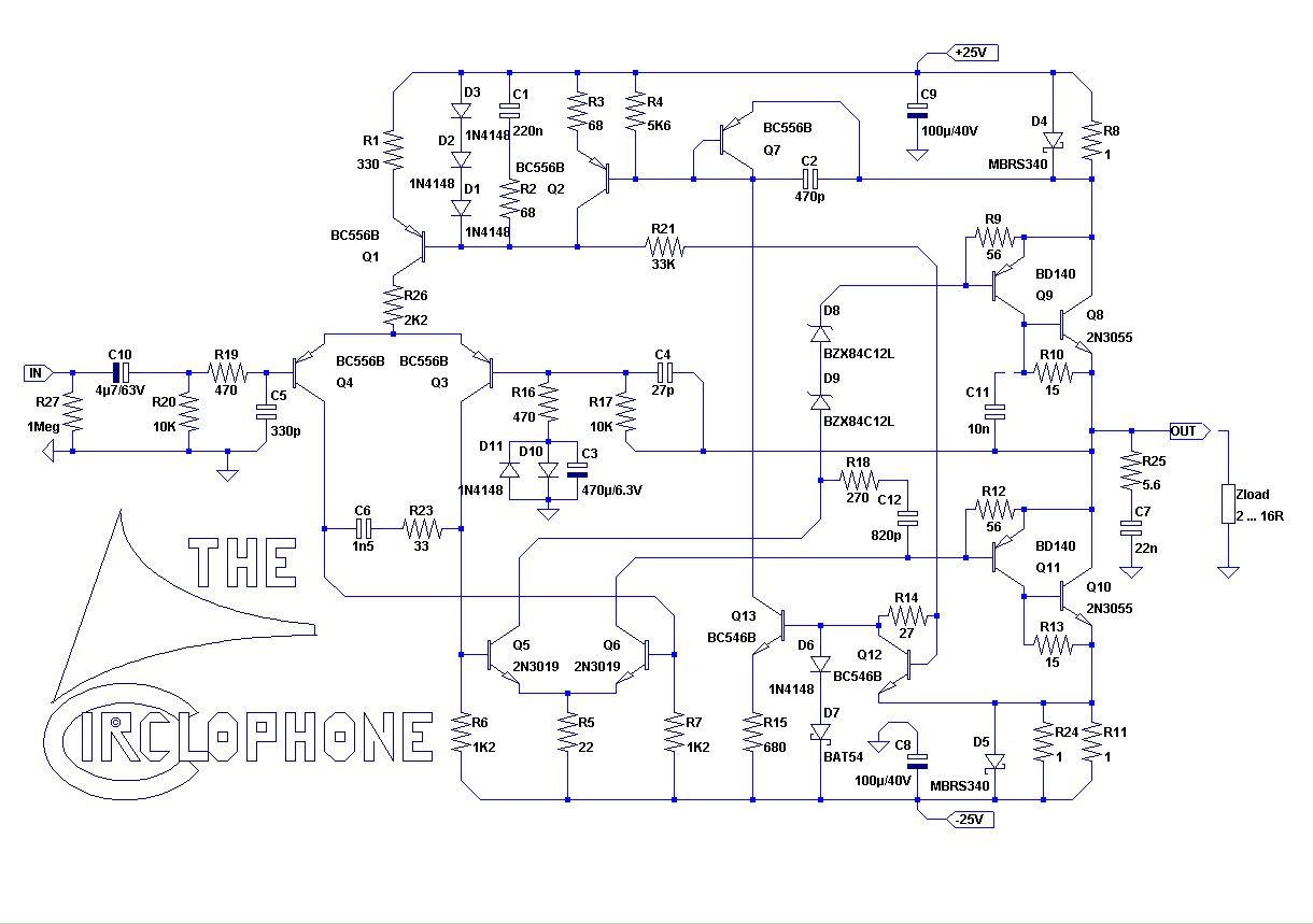

It is a small, unassuming amplifier project, but with some unusual features:
It combines a circlo output topology with an active bias servo.
The servo stabilizes the quiescent current, but it goes further: it actively controls the output stage so that both sides always remain active in a "warm" class AB, having most of the attributes of the full class A, including a complete absence of crossover artifacts.
It is extremely easy to build, offers excellent performance even with 2N3055's, requires no adjustment, no matching, no thermal compensation and yet has a rock-solid thermal stability.
It is also incredibly healthy, and behaves gracefully, even with loads lower than 2R.
In short, a nice little amplifier, not in the top-class, but with excellent all round performances.
Meet the Circlophone©!!!

Don't mind me asz-king, but what does the "Circlo" part refer to ?
It refers to the same-sex output transistors. It doesn't include the folklore of the original Circlotron, the floating supplies: it resembles more later versions, by Philips f.e., because there is no output transformer to worry about.
The drive is similar to that of a circlotron, and the power supplies and transistors could be rearranged in a more familiar order, but there is no advantage to be gained, rather the contrary.

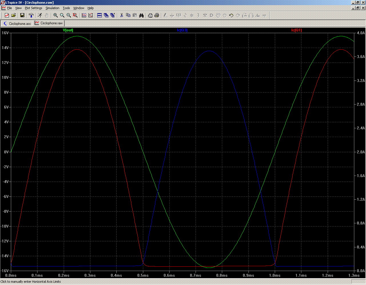

Here are some waveforms illustrating the operation and performances of the Circlophone©:
First, the output voltage together with the collectors currents of the output transistors: one can see that Ic never falls below ~75mA, and that the crossing current (Iq) is ~150mA (warm class AB).
Note that the "idle" transistor remains fully active: the active bias servo encompasses the whole amplifier from the input pair, and keeps all the transistors always active in a linear mode.

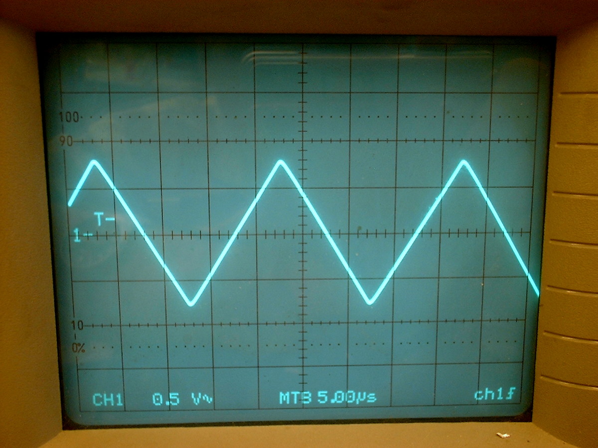

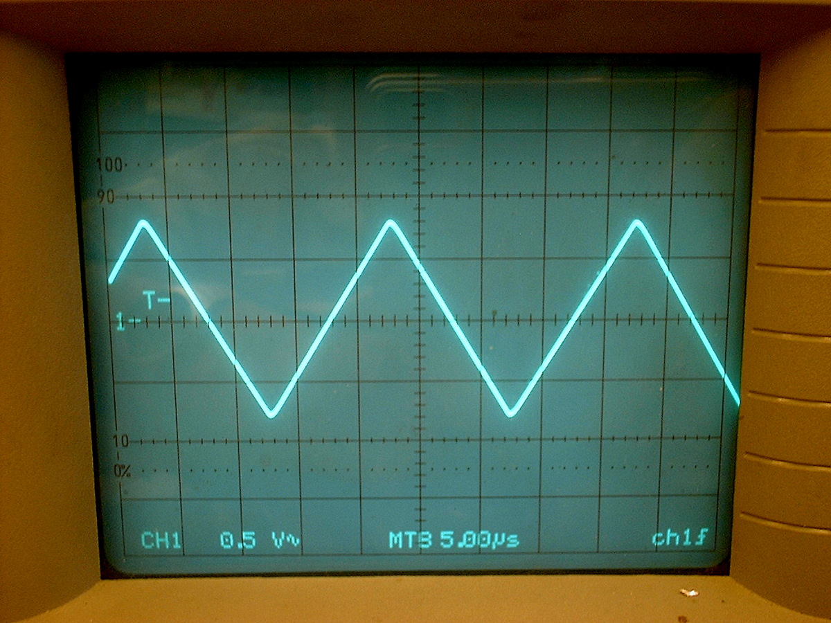

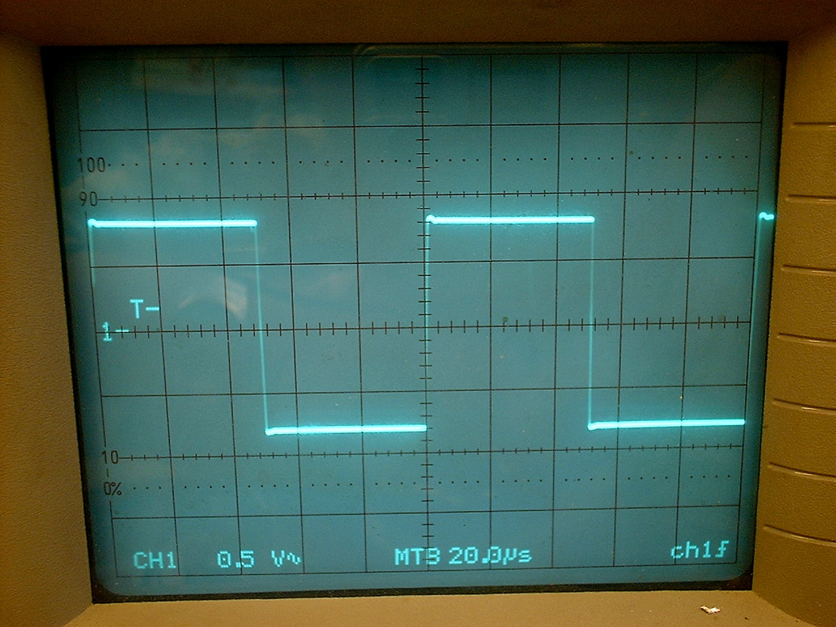

Next is the response to a 16V/10KHz squarewave on an infinite load impedance, followed by the same signal on a 3Ω load.
Then, there is a 16V/50KHz triangle wave, again on infinite and 3Ω loads.
Note: these pictures have been made with actual 2N3055's as output devices

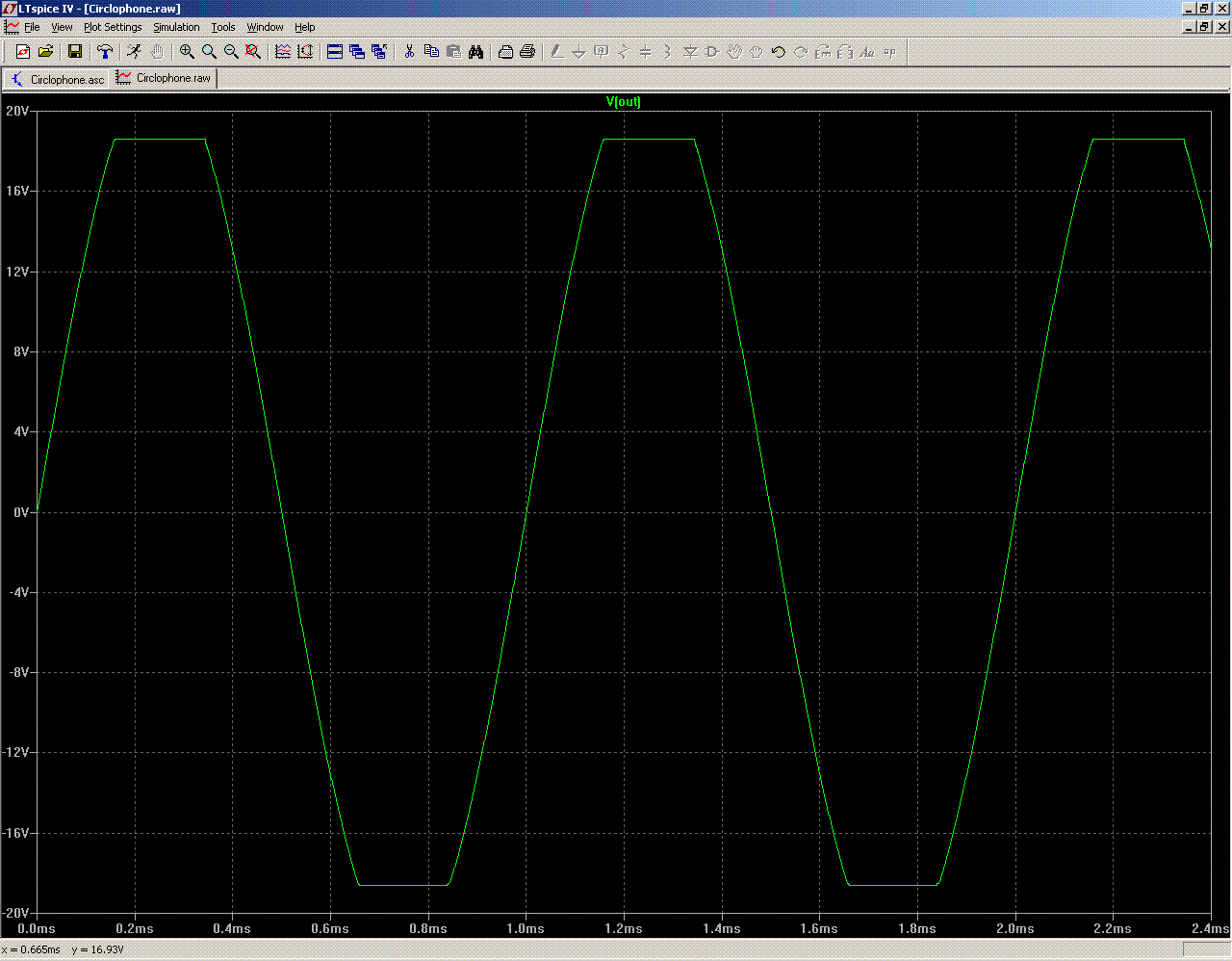

First the clipping behaviour, see picture.
It is shown with 20V supplies, the clipping occurs to within <1.5V of either rail.
It is a simulation, but the real life waveform is strictly identical.

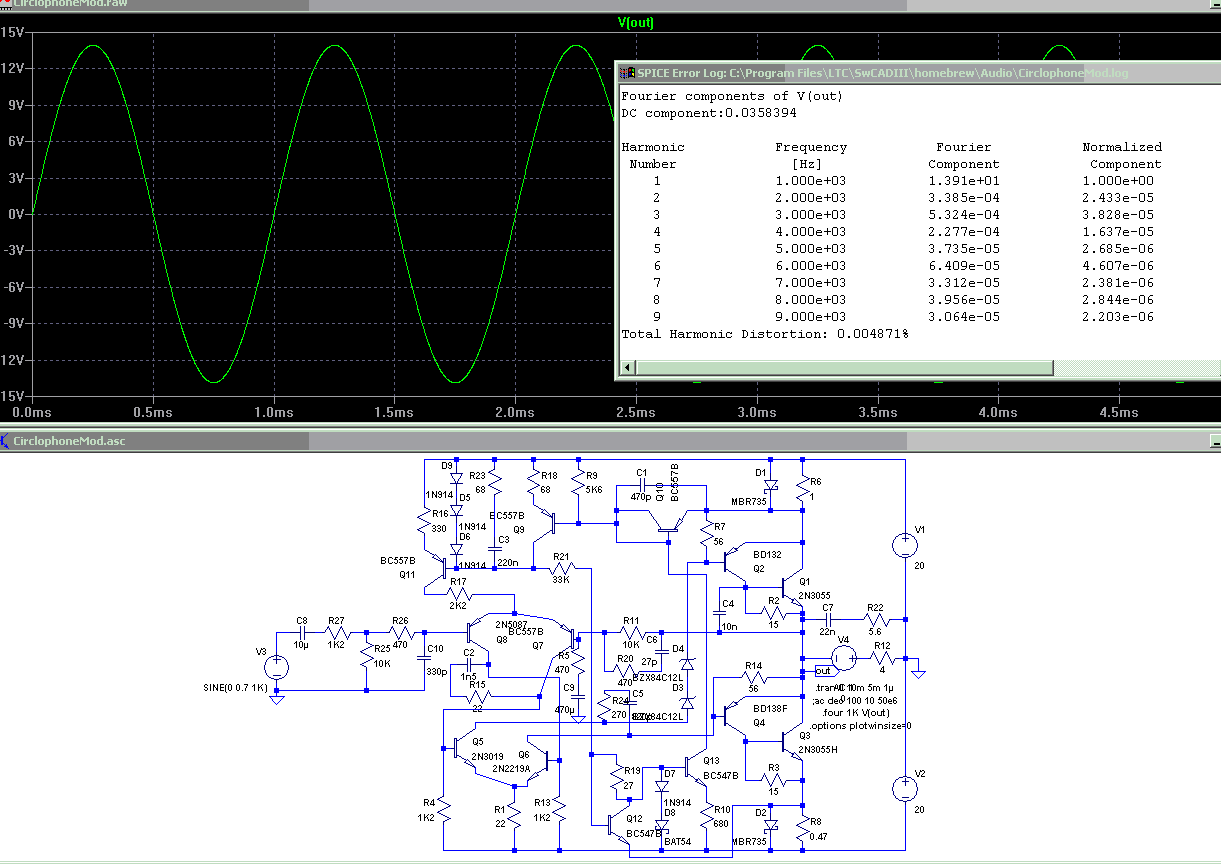

THD @1KHz and 0.9*Vmax is <0.005%

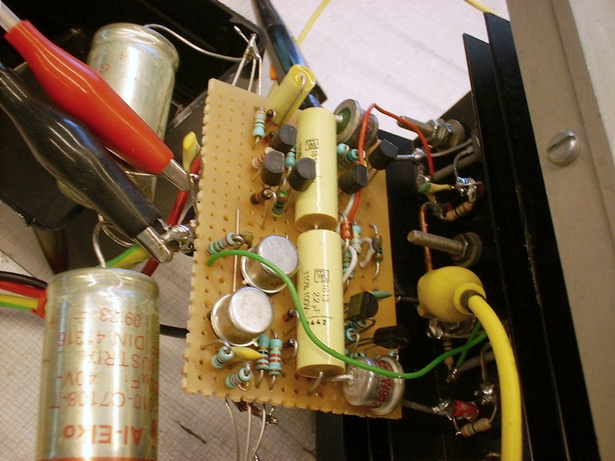

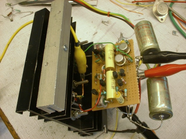

Here are some pics of one of the prototype:
interesting circuit. Looks a bit like that one about
http://www.diyaudio.com/forums/solid-state/162644-siliconix-siemens-nmos-amplifiers-3.html
especially the circuit by post #23 and #24. The second differential stage by your circuit uses additional two zeners (at whole 24V) to avoid different C-E voltages by Q5 and Q6 (unfortunately without bypass capacitor in parallel). This step I miss by the previos mentioned schematic.

I don't understand the aim of follow devices in the schematic of post #1:
1) R26 and
2) R2
The increase in the collector voltage of Q5 due the zener's dynamic resistance is so tiny that it has no influence whatsoever, and requires no capacitor.

Improvements are certainly possible, the goal here is not to achieve top performances, but a good trade-off between performances and complexity.
William T. Chater's approach for the bias servo unit looks also very intersting.
It is in fact quite different: Chater's system is sampled, whereas the Circlophone works in real time.
This is of great importance, because the bias processor can correct in real time (at audio speed) the transfer function of the whole amplifier, in particular the crossover region.
This is what gives it its class A attributes.

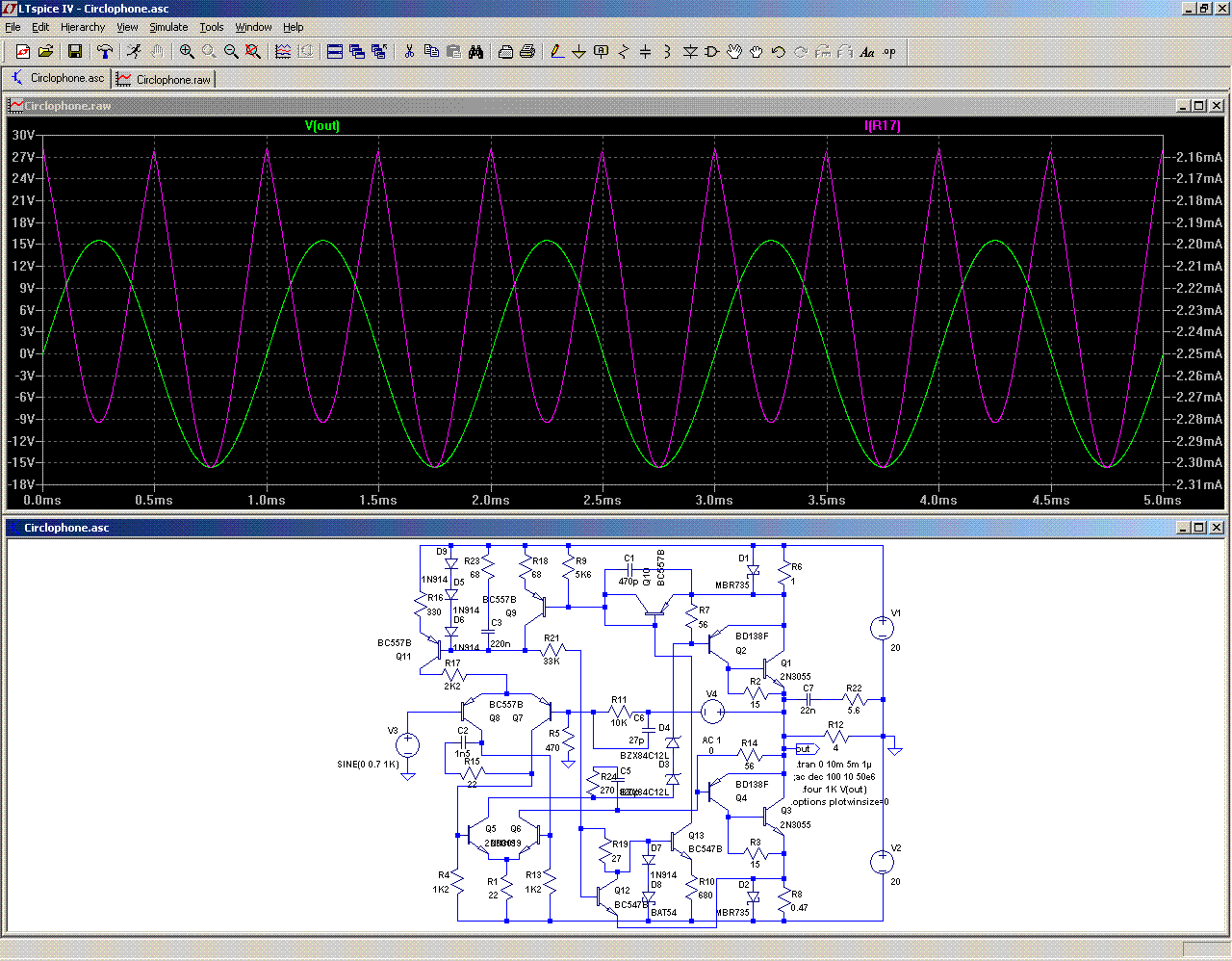

See below the picture of the tail current of the input LTP: you can see that it is continuously varying to the rythm of the audio signal.
This explains why the THD figure is approximately 10x lower than for a traditional basic amplifier having a similar loop gain.
1) R26 and
2) R2
R26 breaks a possible short-circuiting path from supply to supply, and improves the overall RFI tolerance by adding damping in the path.
It increases the resilience of the design in case of "unexpected events".
It could be omitted, it has no active role.
R2 is part of the main lag/lead network compensating the common-mode loop formed by the bias processor.

Regulated supplies are a luxury which the Circlophone can do without.
But it will work, of course.
This design has built-in component tolerance, and will happily accept almost anything you throw at it.

For Q5 and Q6, I have tried 2N3019, 2N2219, 2N1893, and I just checked with 2N5551, it also works, but I'm afraid they are a bit borderline: at 25V supply, the dissipation will be close to the 350mW abs. max. Pd.
The circuit is so tolerant, it will even work with fake or mismatched transistors, or even a different output configuration.
This is illustrated in the following pics:
The first shows what happens when everything that should be matched has been deliberately sabotaged: it still work perfectly.
The second has a darlington substituted for the CFP: the distorsion is bit up, but it remains pretty good.
There are some things to keep in mind, though:
The compensations have been optimized for 2N3055's, and if you use very different transistors, there might be some slight differences in the dynamic behaviour: with 2N3772 or 2N6259's, the slew rate is somewhat decreased.
Also, if you use fast (Ft>5MHz) transistors, the capacitor C11 shown as optional on the schematic becomes mandatory to remove local instabilities, and the circuit becomes more sensitive to the lengths of cable to the transistors.
Your 2SD1718 falls into that category, with an Ft=20MHz. It is pretty similar to the BDY58, which has been tested and works fine with C11 (without C11, there are low level VHF oscillations).
Also, a general remark, the value of C12 at 820pF is probably an overkill, and 180pF should normally be enough in practically all circumstances.
Finally, Q5 and Q6 should have a low enough collector capacitance, less than 15pF.
Most of the TO5/TO39's are suitable, including for the dissipation.

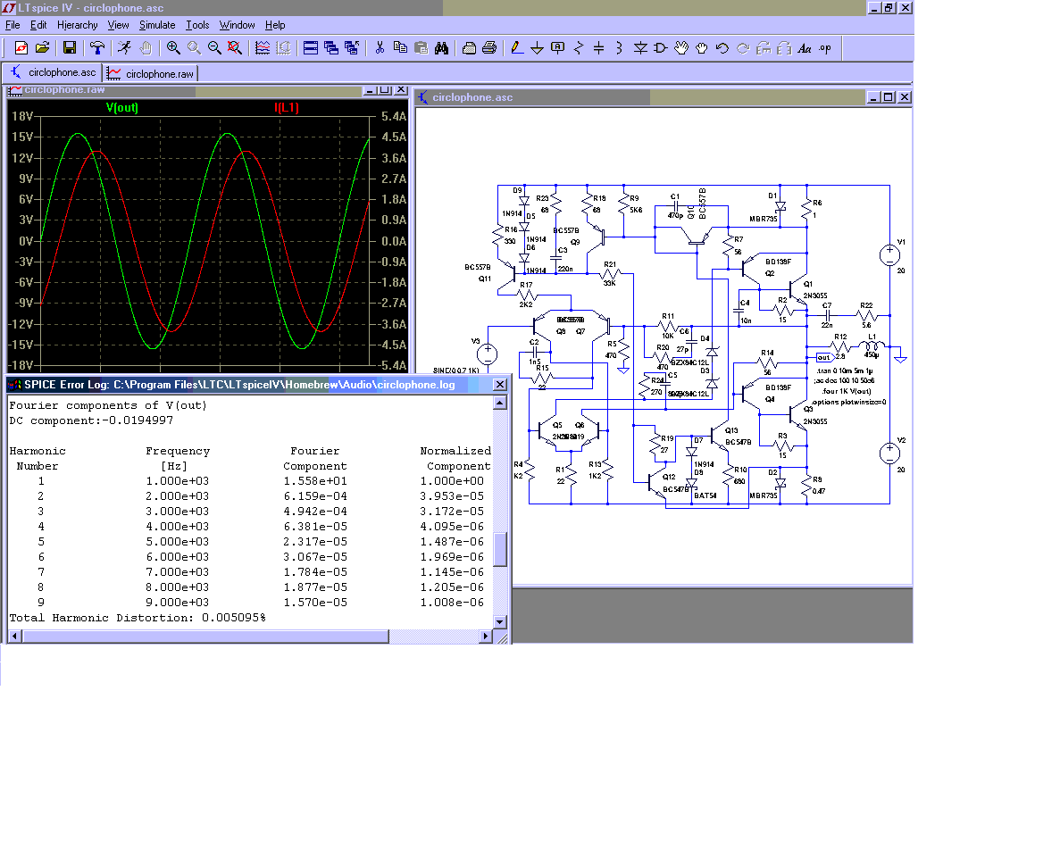

The virtual class A mode of operation is more than mere marketing words, and this is illustrated by the following:
Class B amplifiers normally have a substantial increase in THD when driving reactive loads, in particular inductive ones, whereas the THD of a good class A amplifier remains almost unaffected.
As shown below, the Circlophone© has its THD practically unchanged on a strongly inductive load.

A word of warning for those attempting to simulate the circuit:
The DC and low frequency operation is fairly realistic, including the functioning of the bias processor, but the high frequency dynamic behaviour diverges completely:
In reality, the full power bandwidth easily exceeds 100KHz regardless what brand of 2N3055 is used, but the sim shows problems as early as 20KHz.
I don't know whether this is an inaccurate model problem, or a more fundamental limitation of LTspice.
