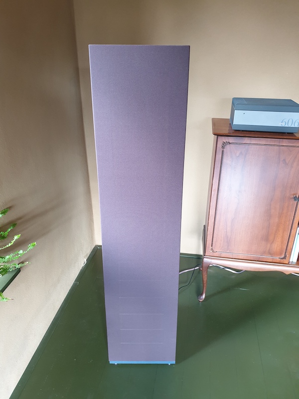

Hi, last week I finished my fifth pair of electrostatic loudspeakers. (see attachments #5 and #6) I think it's the best effort of my five attempts.
Sensitivity is around 86 dB / 1m / 1 VA / 1 kHz. Outer dimensions are 40 cm x 150 cm. Diaphragm (mylar) thickness is 6 micron and dimensions are 23 x 130 cm. Stator / membrane spacing is about 1,6 mm, a little less than I used in previous models. (about 2,4 mm). I'm aware this limits maximum excursion, but has the benefit of improved sensitivity. I use a custom made 1:125 full range quality setup transformer.
I use loudspeaker screen on the front because otherwise the panels don't fit esthetically with my room. This dampened the fundamental resonance frequency with 5 dB. After fitting a mesh damping screen with a rather low rayle number on the rear stator (on the inner side of the wire stator in order to damp resonances in mid range as well), I got around 2,5 dB more damping, resulting in 7 to 8 dB damping. Resonance frequencies of both panels are 62 and 76 Hz. I guess they will lower a bit after breaking in. I hope they will stabalize around 50 Hz.

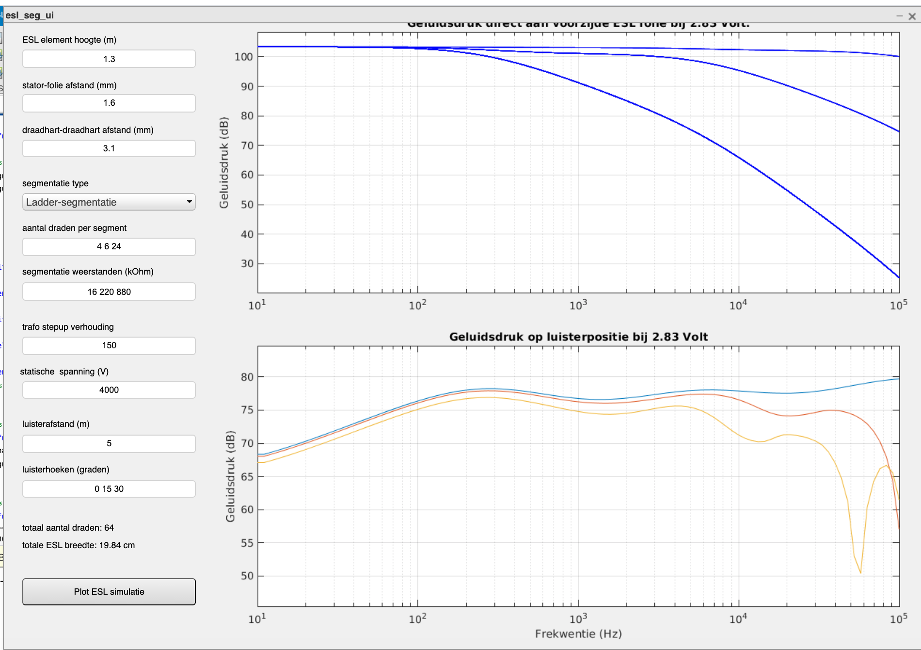

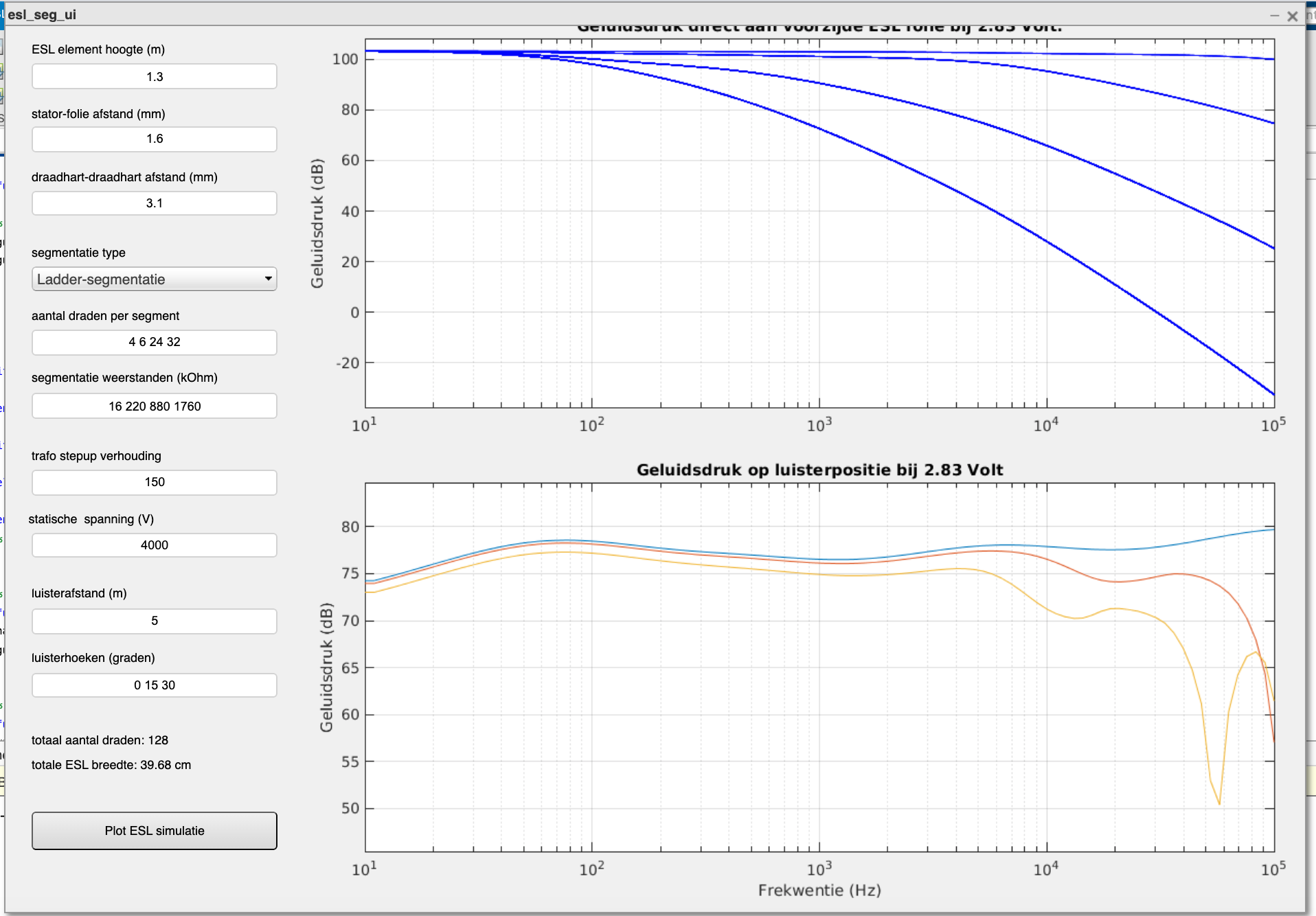

I used the software "esl_seg_ui" by Edo Hulsebos to simulate / calculate the electrical segmentation. (see attachements #1)
In the simulation I included the 1 Ohms series resistor between amplifier and audio transformer.

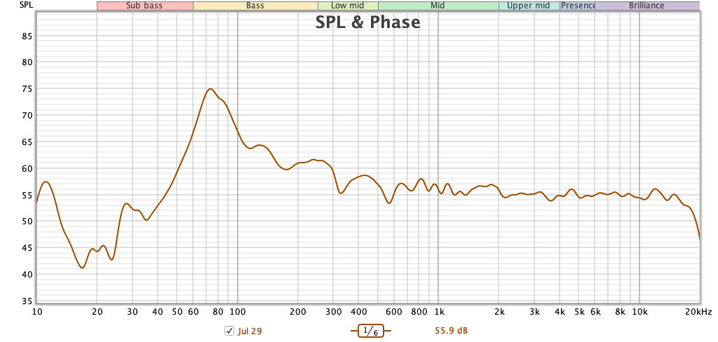

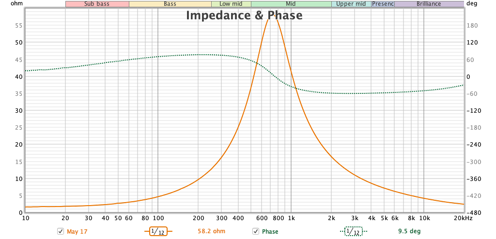

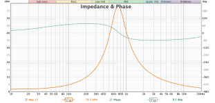

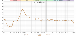

For frequency and impedance measurements, see attachements #2 and #3.

#1: segmentation simulation for current panel
#2: impedance and phase measurement in REW, using a custom 1:125 step-up transformer and a 1 Ohms series resistor
#3: frequency measurement in REW with microphone close to front stator (about 3 cm)
#4: segmentation simulation for current + new bass panel
#5: rear side of new panel
#6: front side of new panel

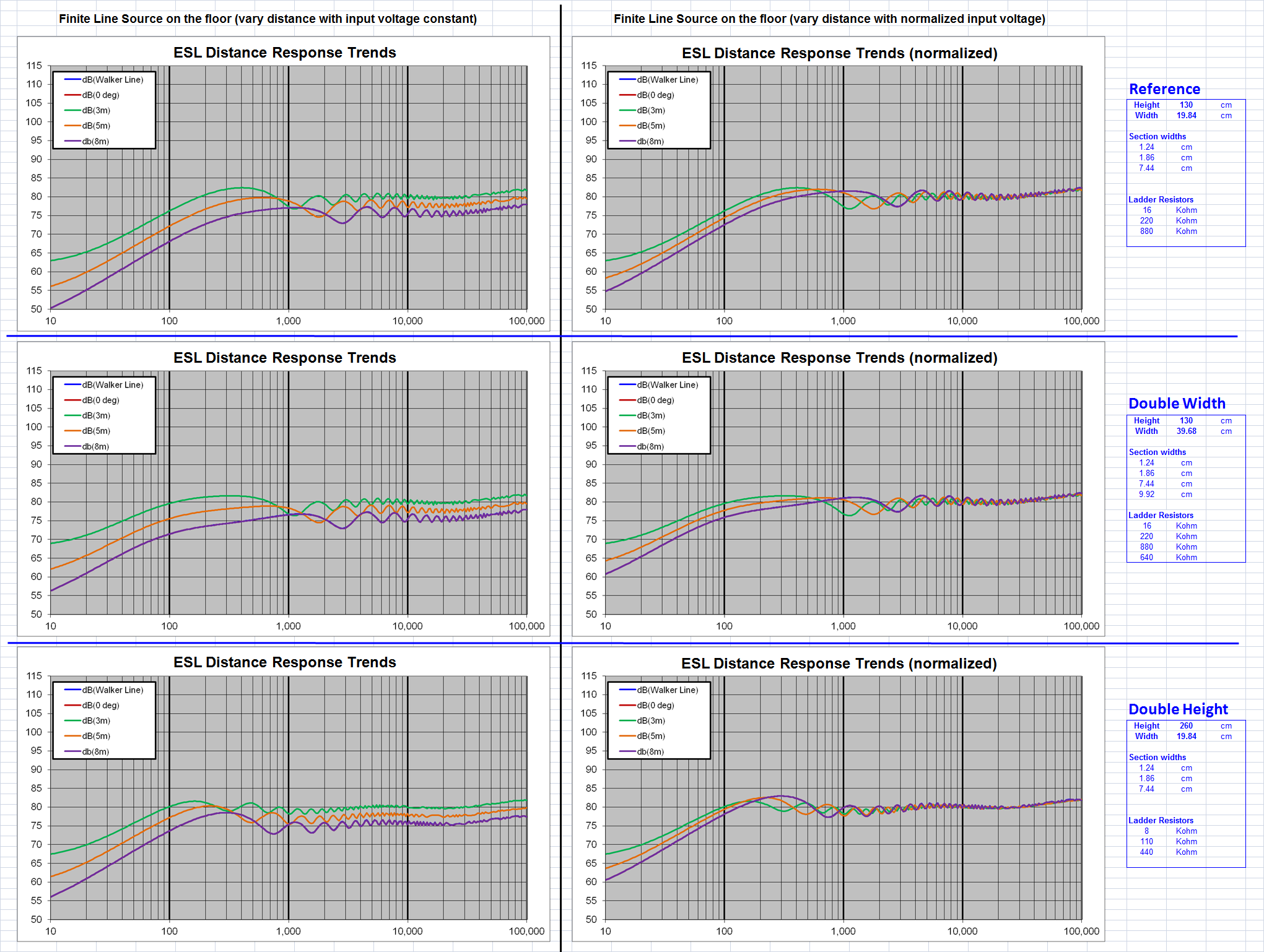

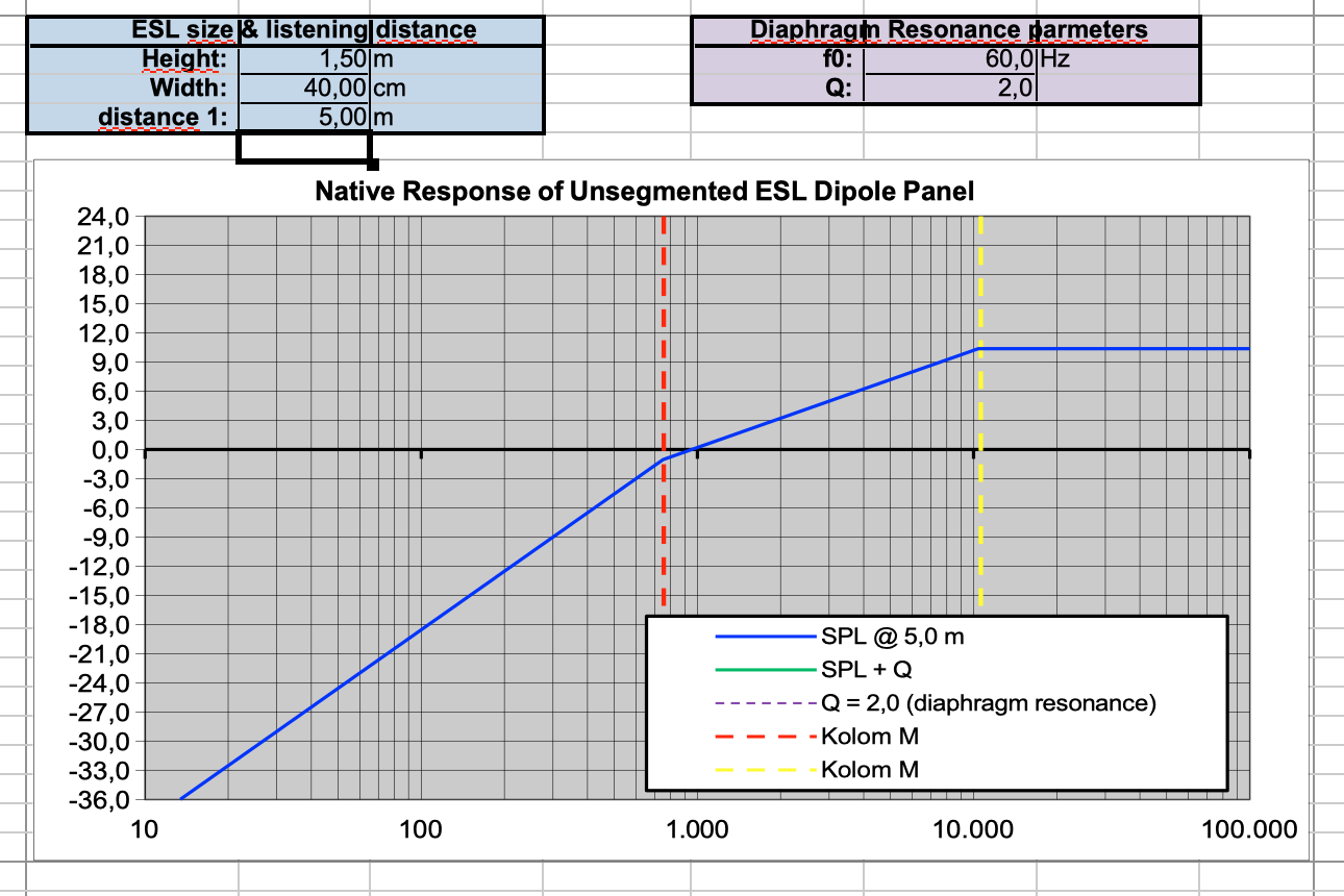

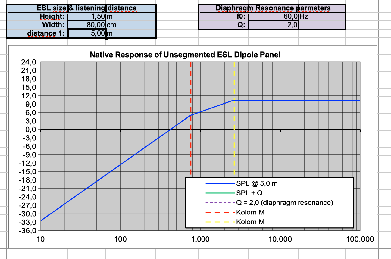

In addition to my previous post, I found an very useful excel sheet by Bolserst to calculate far / near field, and intermediate field. Although I was aware of this sheet, I never seriously applied it. See post below:
https://www.diyaudio.com/forums/planars-and-exotics/206816-segmented-wire-stator-esl-simulator-esl_seg_ui-2.html#post2913884
Tonight I filled in the dimensions of my latest stats (I used the outer dimensions of the panel, not the diaphragm dimensions), see attachement #1. I used a listening position of 5 meters as this reflects my current situation. In this case the intermediate field ranges from 756 Hz to 10625 Hz. So that would result in a -3 dB/oct slope below 756 Hz, as I used electrical segmentation calculated / simulated by esl_seg_ui. Resonance frequency at around 60 Hz corrects this dip a little bit. Above 10 kHz there would be a +3 dB slope, but LC resonance of audio transformer + panel, and weight of the 6 micron mylar will compensate for this raise in output at higher frequencies.
In order to extend low frequency range, (it's not a big deal, but I would think this would make an improvement because of the increased listening position) I'm wondering what would be the best option, if I want to build a second panel per channel: put it next to the current panel as described in my first post, and use this panel as a bass (only) panel, or just copy the current panel (and it's segmentation) and put it on top of the current panel? In the last case, this would get closer to a line-source.
Widening the panel would result in a graph in attachement #2: the near field (yellow dashed line) moves to the left, resulting in a field transition point at 2656 Hz. So, assumed I apply segmentation as suggested by esl_seg_ui, as proposed in my previous post, I would get a +3 dB/oct slope from 2656 Hz upwards. The -3 dB/oct slope in the far field region doesn't change. To me, this seems not answering my wish to extend low frequency range, but rather boost mid / high frequencies.
Doubling height of the panel, and keeping width the same would result in a graph in attachement #3: this lowers the field transition point (red dashed line) down to 189 Hz and keeping the other transition pont (yellow dashed line) at 10625 Hz. This would increase low frequency range with approximately +6 dB. (two ocatves @ 3 dB/oct: 756/2/2=189Hz)
I'm not sure if I made any errors or forgot things (like core saturation, etc.), but at the moment I would conclude that stacking both panels vertically would be preferable as this would extend low frequency range and would come closer to a true line source?

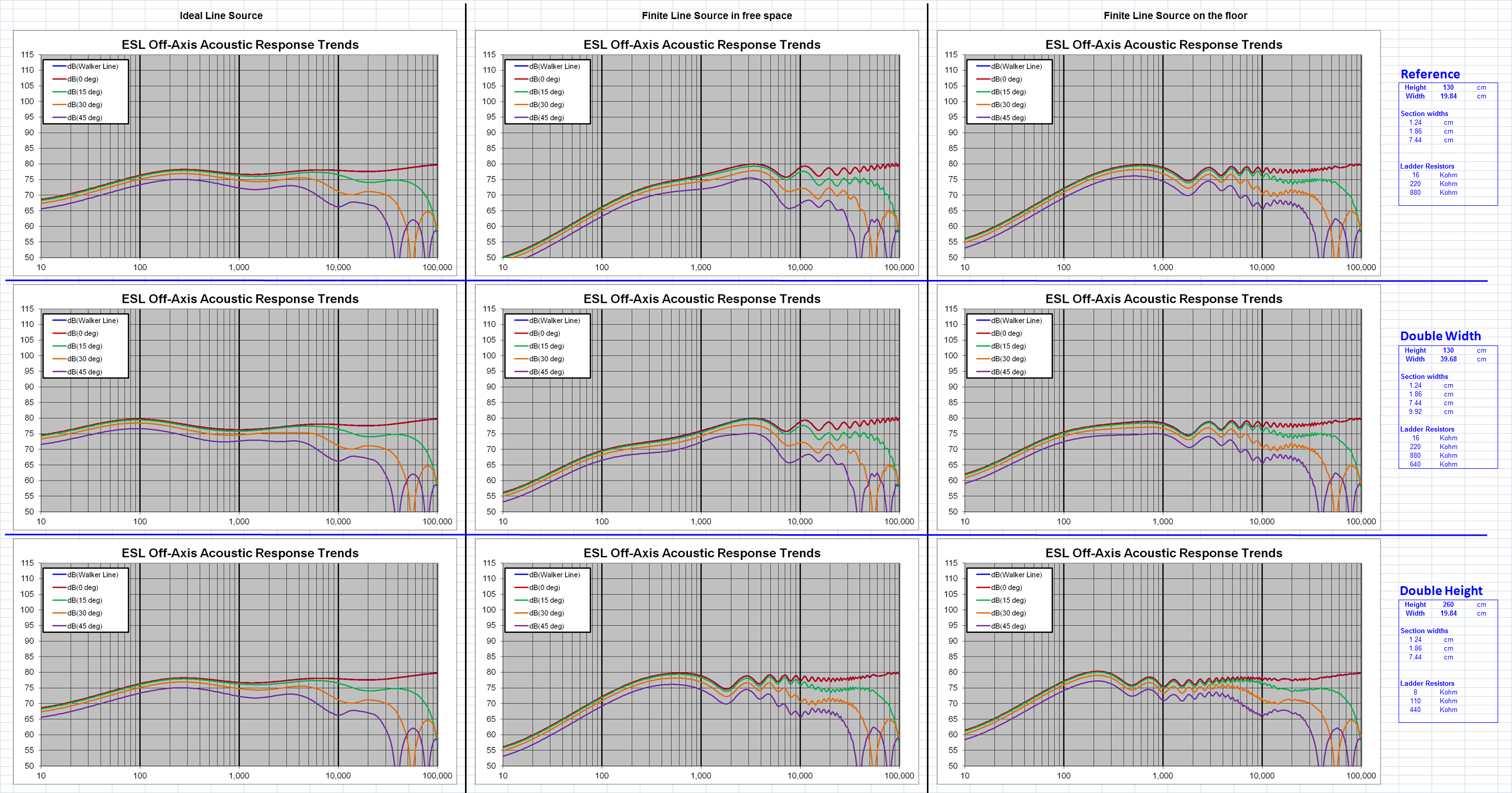

Since the spreadsheet is calculating field transition break-points for an unsegmented ESL far away from any room boundary, it can be difficult to draw conclusions for segmented ESLs in a room. To get a better idea of the difference between adding width and adding height, we can compare a theoretical infinite line with a finite ESL line source, as well as a finite line sitting on the floor receiving contribution from the floor mirror image source. I believe the 3rd case is closest to what you have.
Attachment #1: This set of plots shows response for the 3 line source models (ideal, finite, and finite-on-floor) for your original panel, and then with doubling width, or height. For the double width, I used a lower ladder resistance value that you had so as to lift the LF response for the finite-on-floor. For the double height, I hooked the segments together, so same segment widths but twice the height requiring the ladder resistors to be halved. Both doubling width and height can provide improved LF response with little effect on the HF polar response.
Attachment #2: One other thing to look at when evaluating adding height or width, is how the response changes with distance from the ESL. Adding height reduces the variability of the LF response(<200Hz) with varying distance. This is one of the reasons I prefer to add height rather than width. It also happens to take up less floor space. But some people feel the added height makes them dominate a room's decor, and so prefer a shorter, wider panel from an aesthetic standpoint.

I agree on your conclusion that making a panel taller seems preferable when looking at your simulations, although it differs "only" a few dB's.
The only thing I'm wondering is when making the current design taller, let's say about 2.5 meters tall rather than the current 1.5 meters (as 3 meters is a little too tall maybe), capacitance will raise and LC resonance of panel and transformer will lower in frequency. I tested this by connecting 2 panels in parallel to 1 transformer and measured 5 cm in front of one stator and I can see a reduced high frequency roll-off.
In order to keep high frequency range about the same, would proportionally increasing d/s distance compensate for this? (as panel capacitance will be the same as the smaller panel)?
Yes, if capacitance from 2.5m tall ESL is an issue for your transformers, you could reduce capacitance by increasing d/s distance.

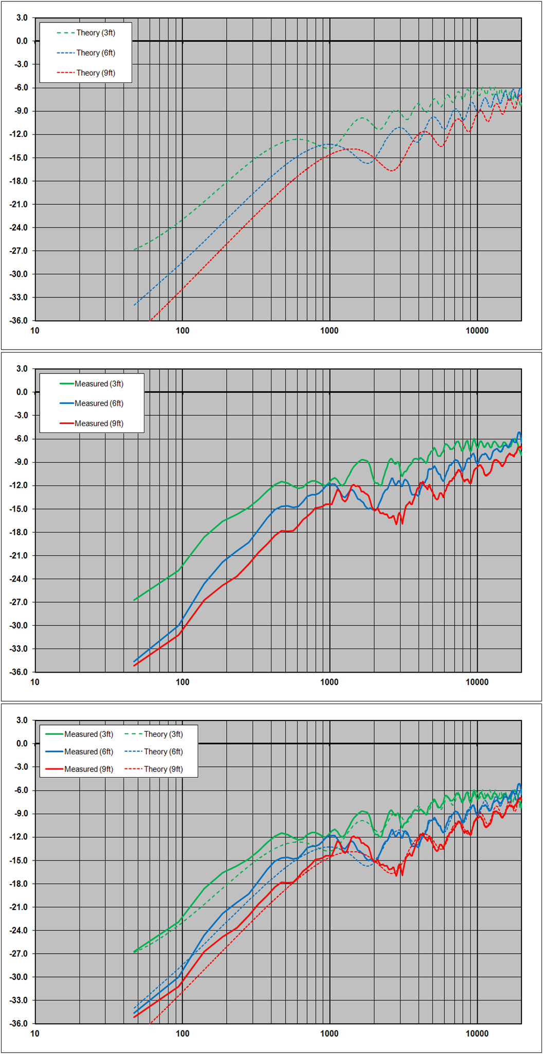

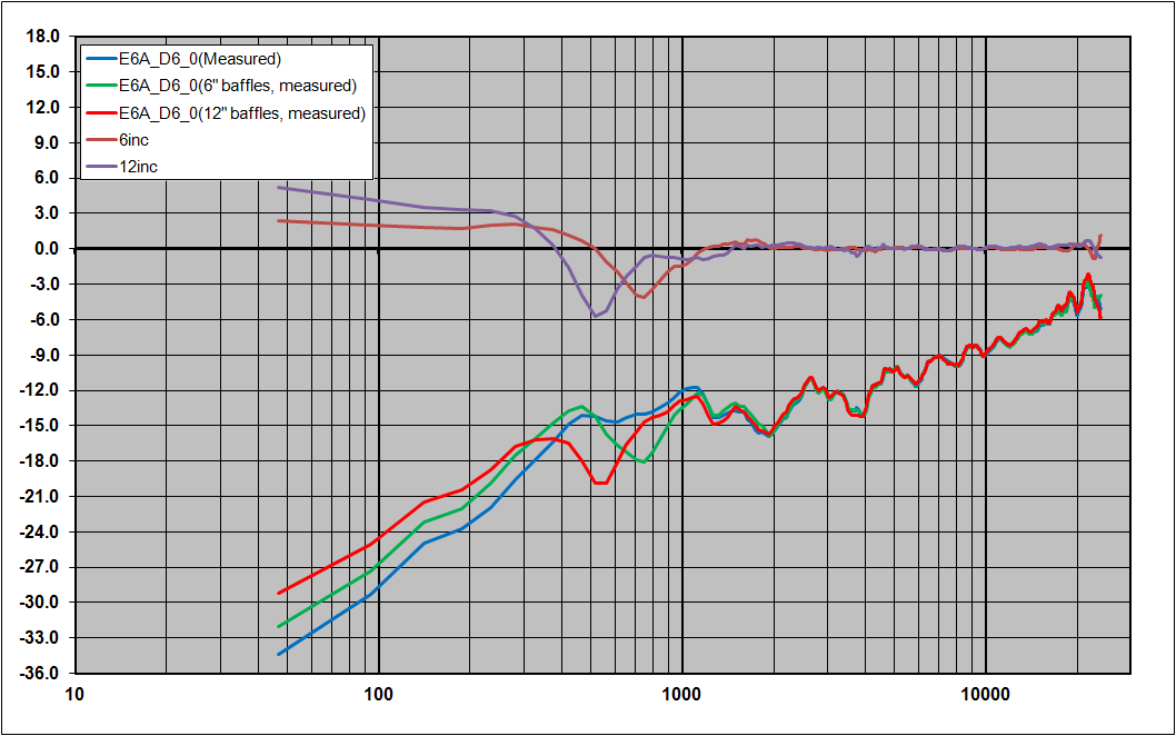

Attachment #1 is a comparison of theory and measurement for a 64” x12” line source measured at 3ft, 6ft, and 9ft.

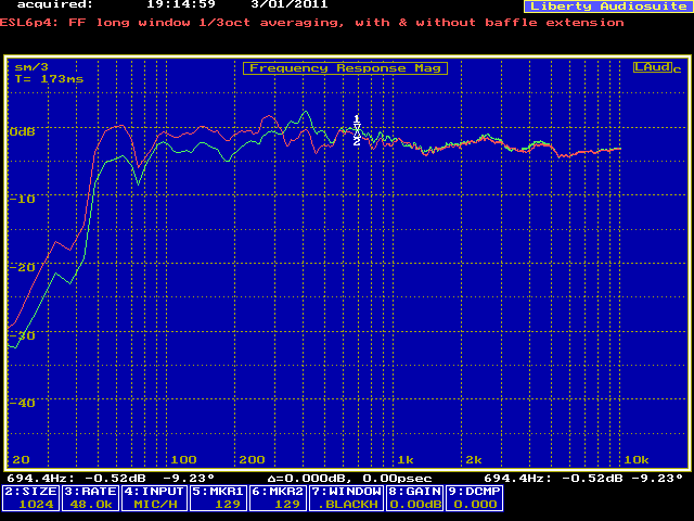

While looking for that measurement, I found another one where I had measured the effects of adding wings to an ESL panel.
Attachment #2 shows measurements and calculated increment for adding 6” and 12” wings to a 12” wide ESL.
So you get a nice LF boost, but can start impacting the midrange if taken too far. eAudiostatic baffle step filter
I thought you had tried wings previously and didn’t like the results…but I could easily be confusing you with another diyAudio member.
Attachment #3 shows room average response with and without wings from a while ago.
The LF boost is as expected, and the midrange notch shown in previous windowed measurements is not quite as prominent since its frequency and depth changes with off-axis angle and smooths out in a time averaged room response.
Some years ago, Capaciti posted a similar measurement for his Element 160 with Plexiglas wings. Some questions on ESL dimensions
Although he didn’t post a picture of the ESL, I had saved an image from his website which I included here as Attachment #4 .
