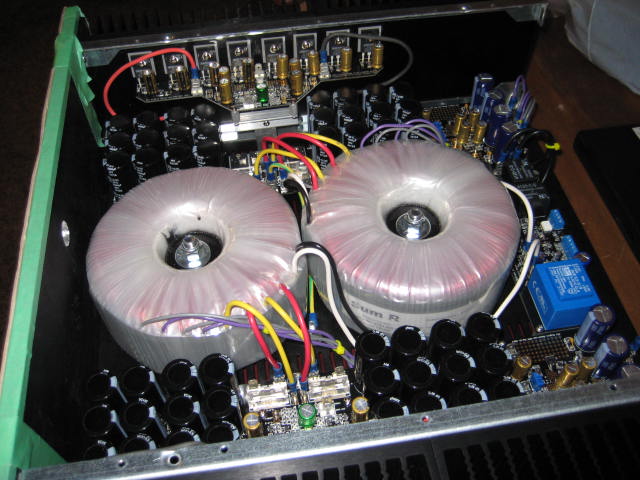

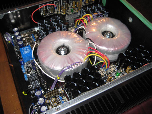

Here is the config of my amp:
2 x NXV500L modules
2 x NXVPSU-Two modules
2 x NXVolt One R2.1 modules
1 x Power One R3.0 AC mains controller
Chassis - ModuShop Chassis from Italy

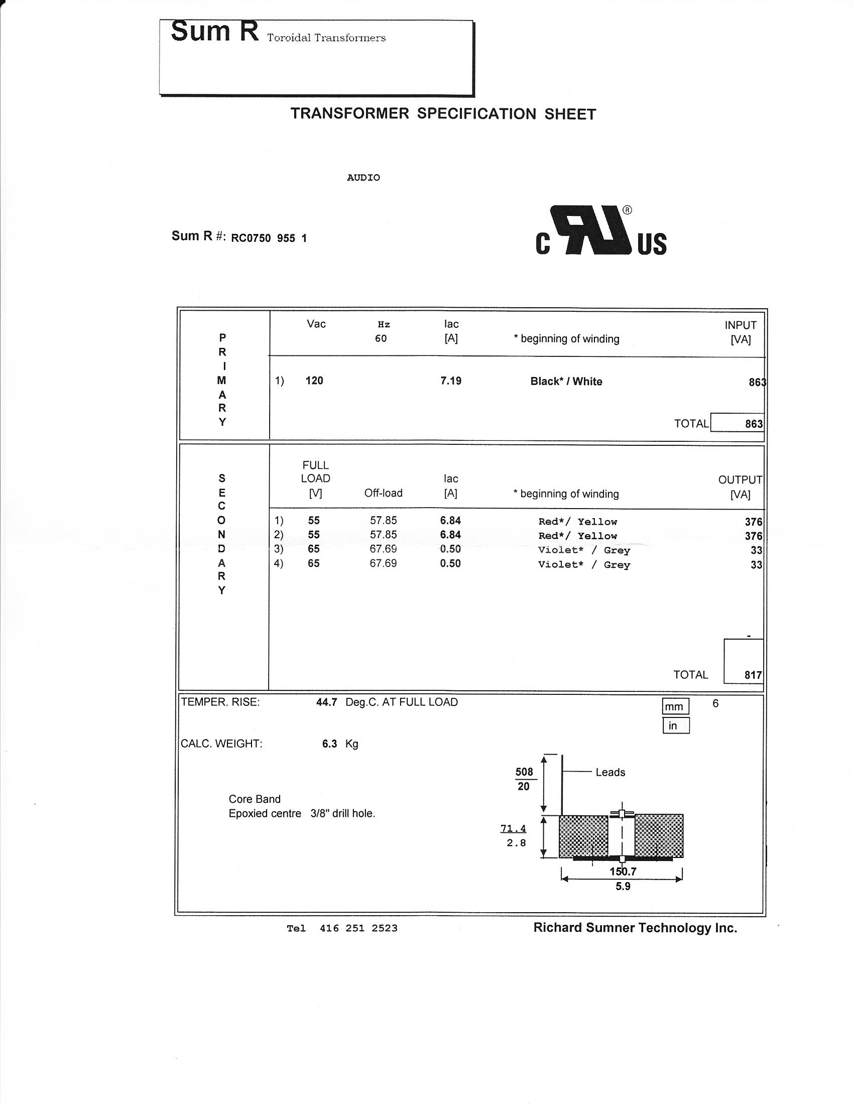

Transformers - 2 x 800VA from SumR made locally near me around Toronto.

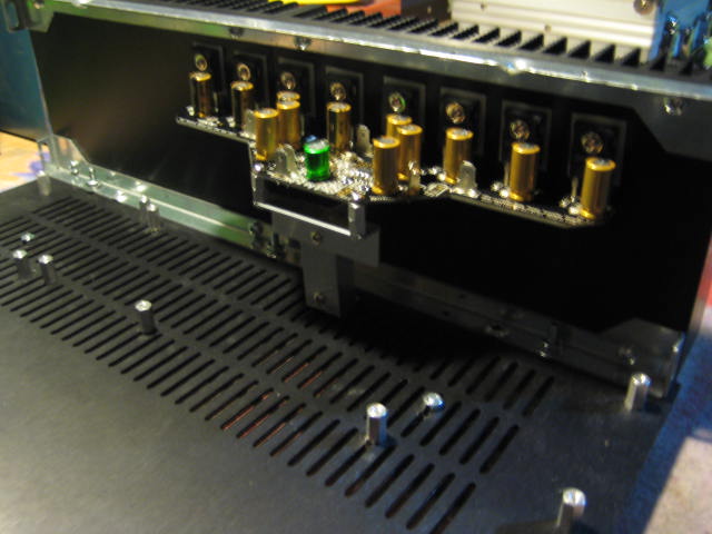

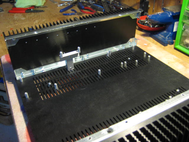

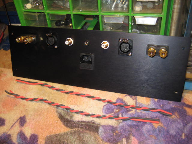

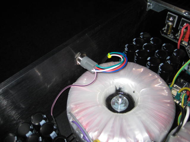

I wasn't prepared for all the drilling of holes in the metal chassis, especially without owning a drill press. Also, I should have ordered a larger chassis, fitting everything in a single chassis was a challenge, but after making a brace to raise the 500 amp boards, it all fit. Got that idea from someone else on this site.

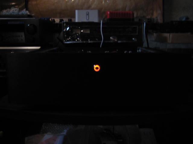

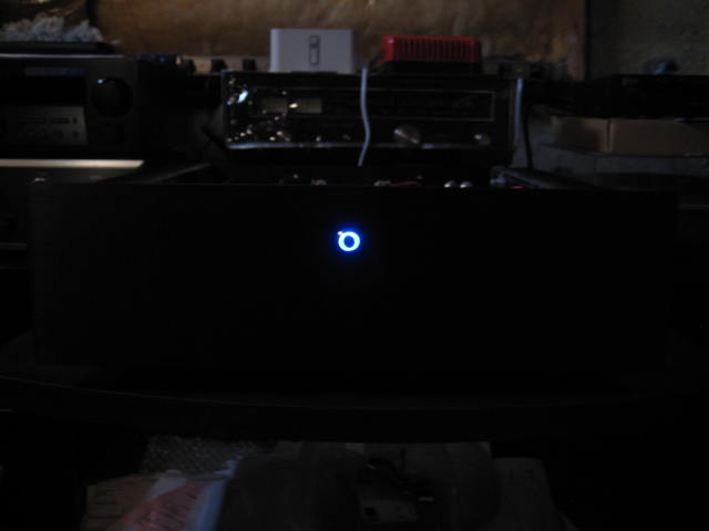

Here are some pics of my almost finished amp. The quality of some photos is not great. The LED power button I like, it's blue when not on, turns red when manually turned on, and is a kind of pink when turned on via the 12v trigger. It was hard to get a nice photo of the LED lights. I also included the specs on the transformers I ordered, with guidance from Anthony at Holton.

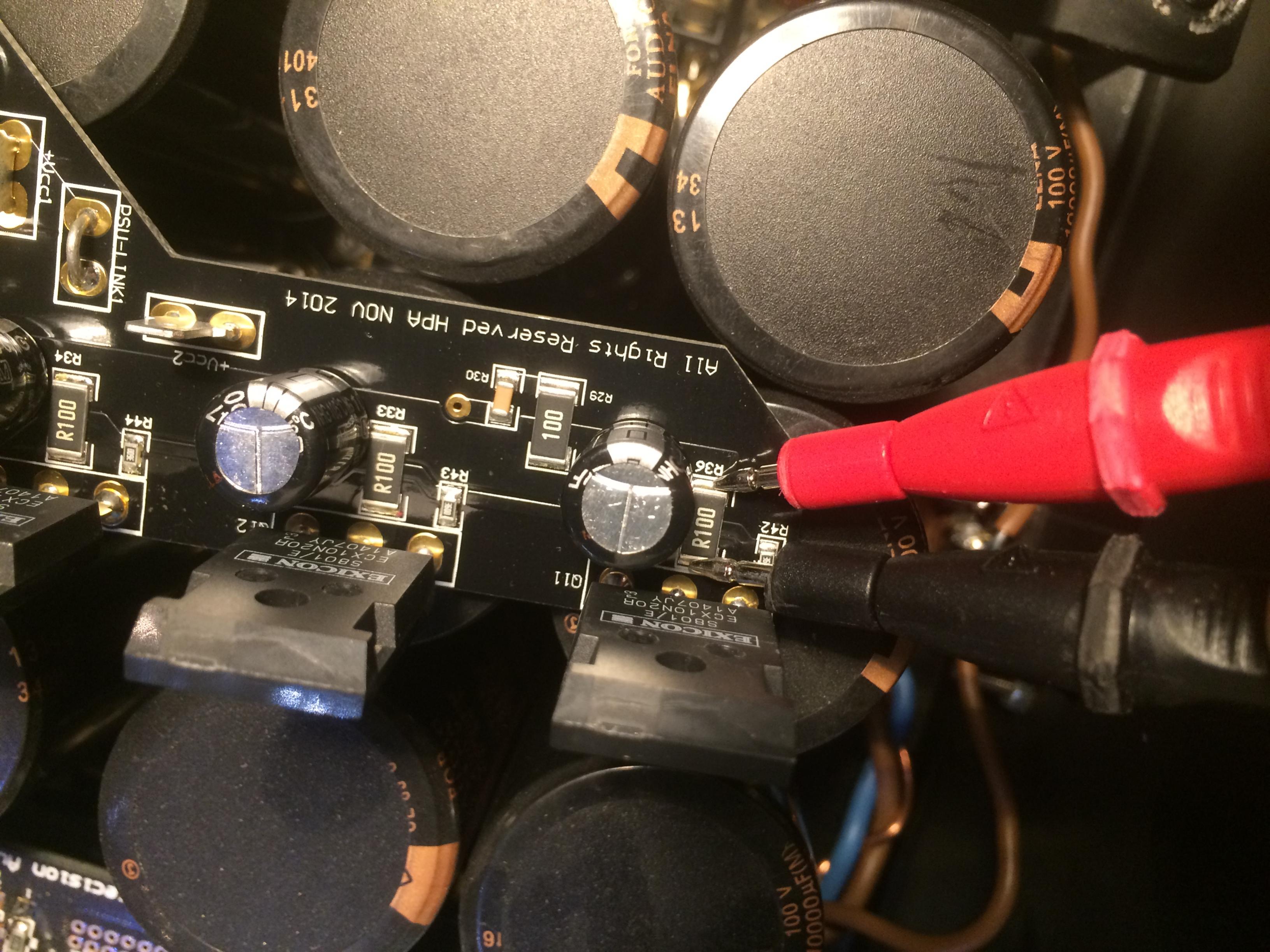

BIAS Help
I could use some assistance on my 500 amp completion.
Would anyone who has done the bias of the 500 amp modules tell me where they put the positive and negative leads of their meter on the modules to make the voltage adjustments with the VR2 trim pot.
If you can tell me the exact location or component address on the boards, that would help me a lot.
I'm not sure how to complete this last task.
Thanks, Bill

I have the little nvx200's, didn't get any documentation with them.
I measure over the 100K sms resistors on the end of the amp board. You should read mv
0.4-0.9 depends on how good your heatsinks is 🙂
Leikis, thanks for the photo, it really helps confirm the location of the resistor on the module. I'm not very experienced at this.
In the past, when trying to measure the resistor, my meter lead shorted across the mosfet pins and there was a spark.
So, I don't know if this is the cause of not being able to adjust the bias. Could one blown mosfet be the cause of the issue?
When I measure the resistor, I get no voltage reading.
The PSU on the channel keeps blowing the fuses at V1+ and/or V1-.
When trying to adjust for bias by turning the VR2 pot on the amp module, there is no change in voltage, it stays at zero volts.
I hooked up a speaker to the amp, and it's very distorted.
Any ideas what might be wrong, or what to check for?
Grab your meter put it in beep mode to see if there are any shorts, Then put black into screw hole on the heatsink, then touch every transistor lead and see if any beep, NONE should if one does, then you have a short between the heatsink and transistor, maybe a metal shaving or something..
