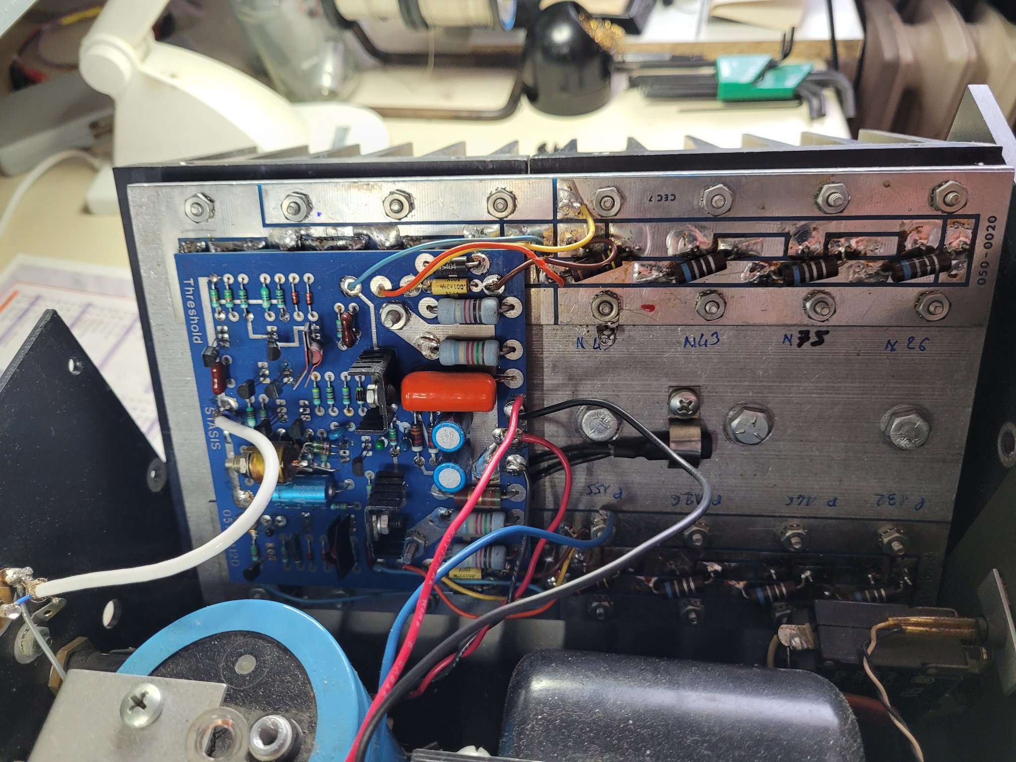

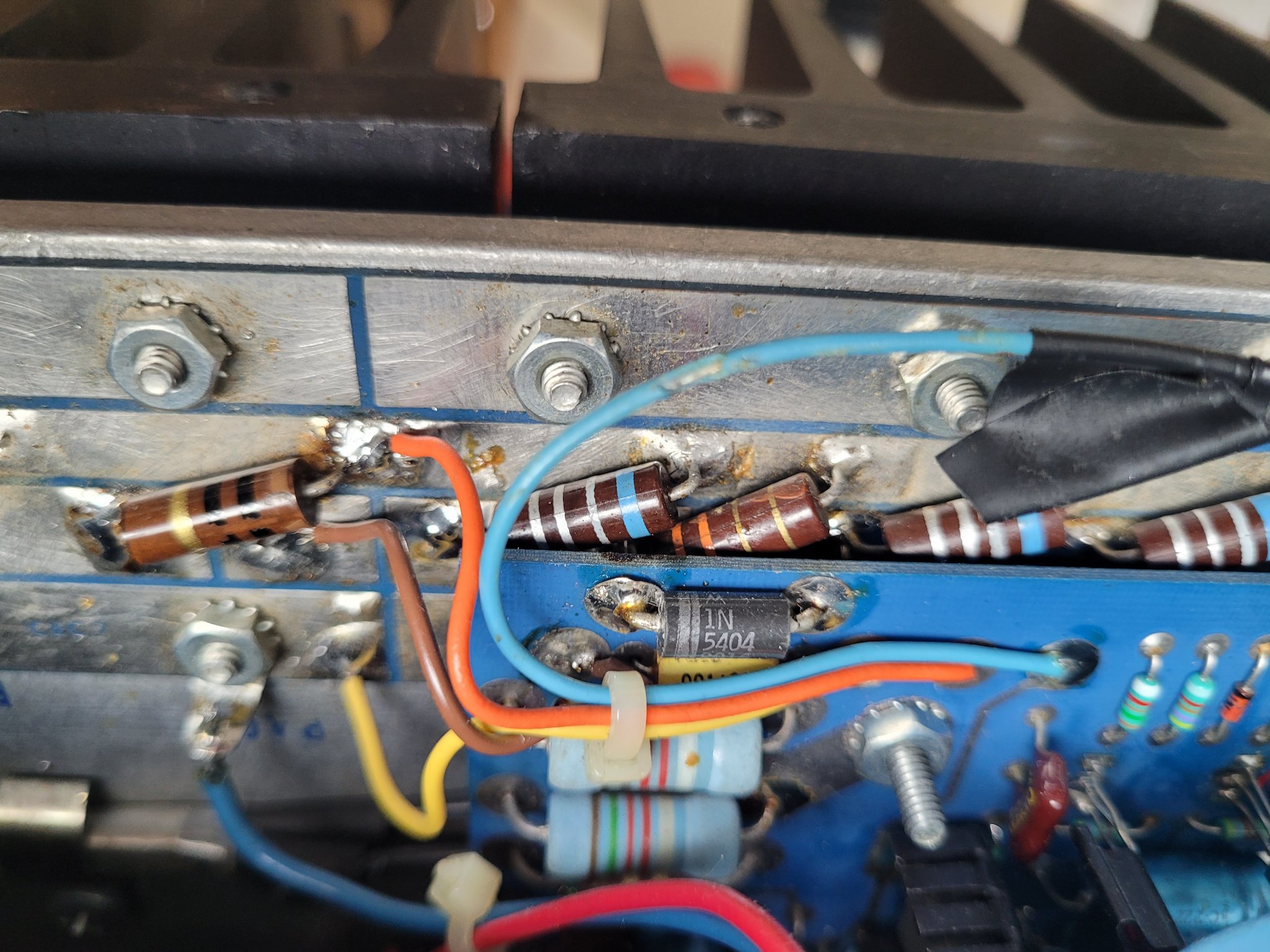

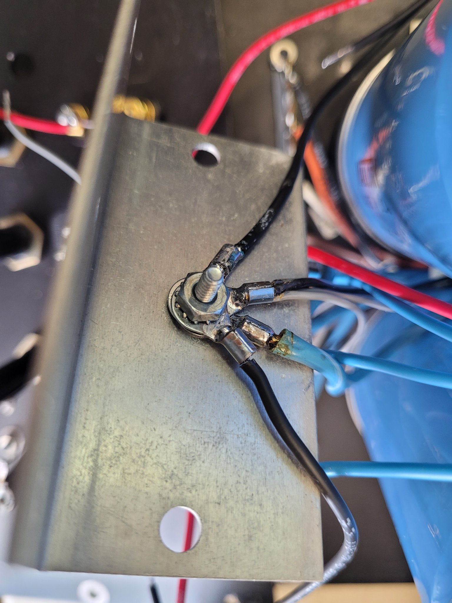

I knew this amp had been professionally repaired, but what I didn't know and didn't see was that the job hadn't been done very well: some wires were melted and the circuit boards were damaged.
At that moment, I regretted opening it!

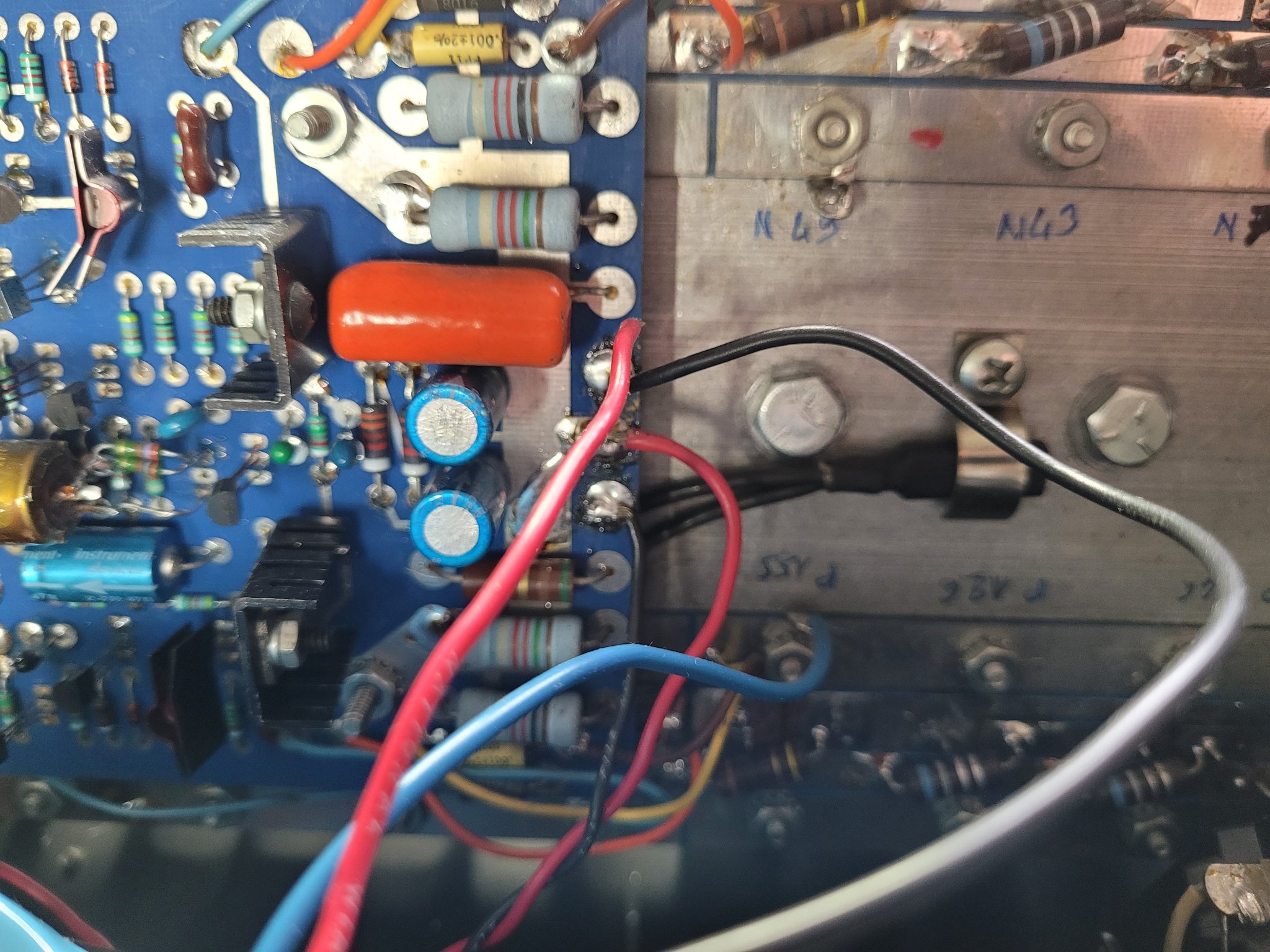

The RCA cables had been replaced, but they were too stiff and had bent the leads of an MPSA42, making contact with each other. Luckily, these leads were already in contact on the circuit board, so it didn't change anything!

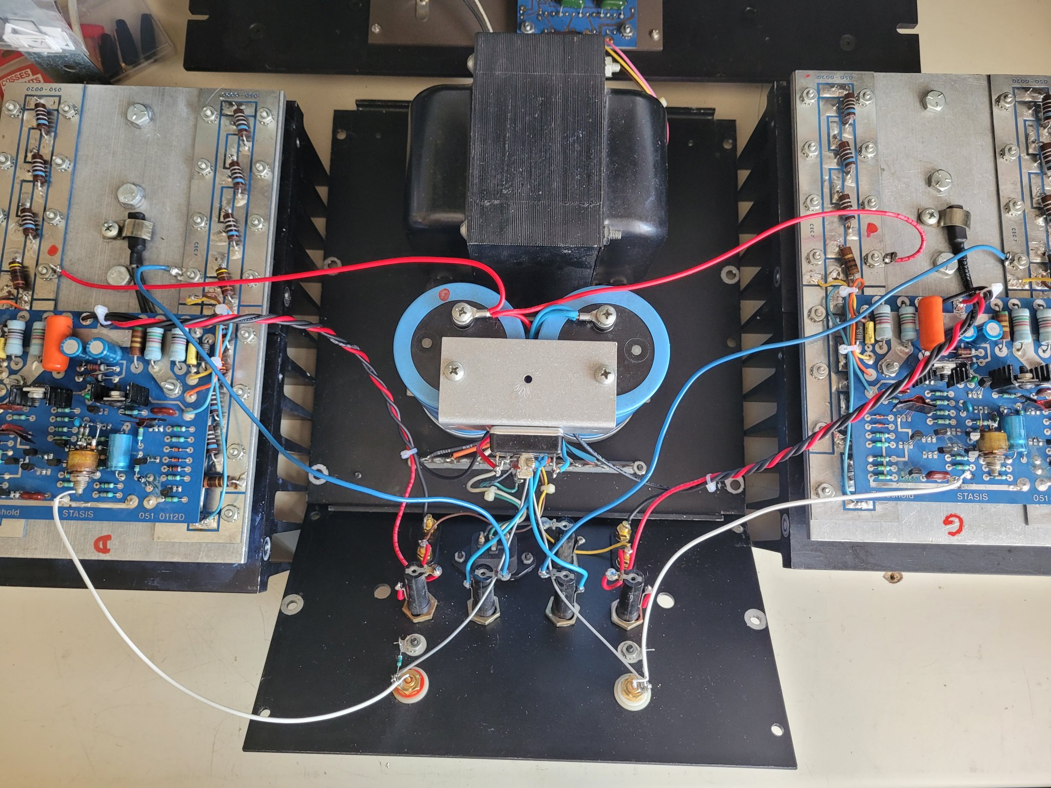

So I completely disassembled the amp to rewire it.

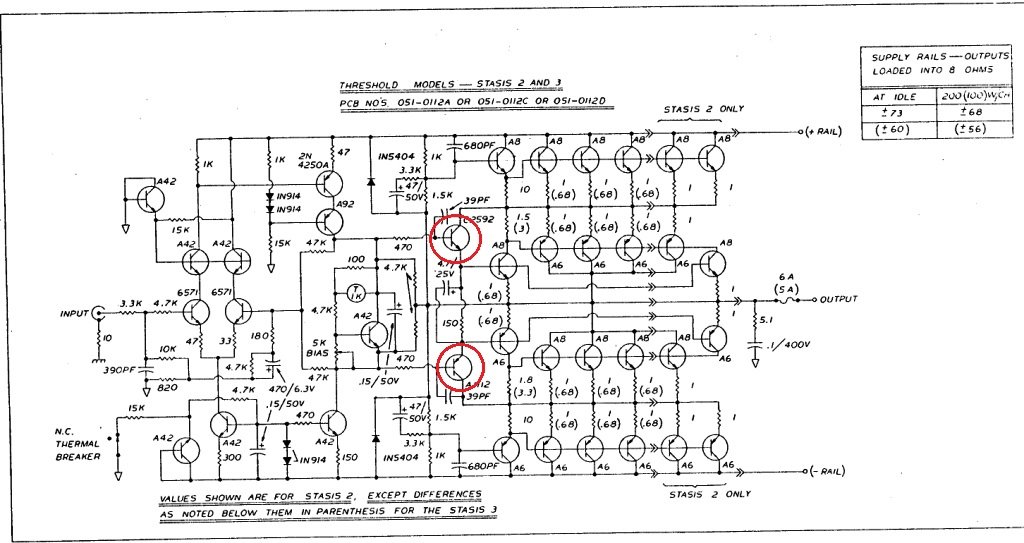

While cleaning the circuit boards, the leads of a 2SA1112 were cut off flush with the case. I was lucky here too, because since I listen very loudly, they could have broken from the vibrations.

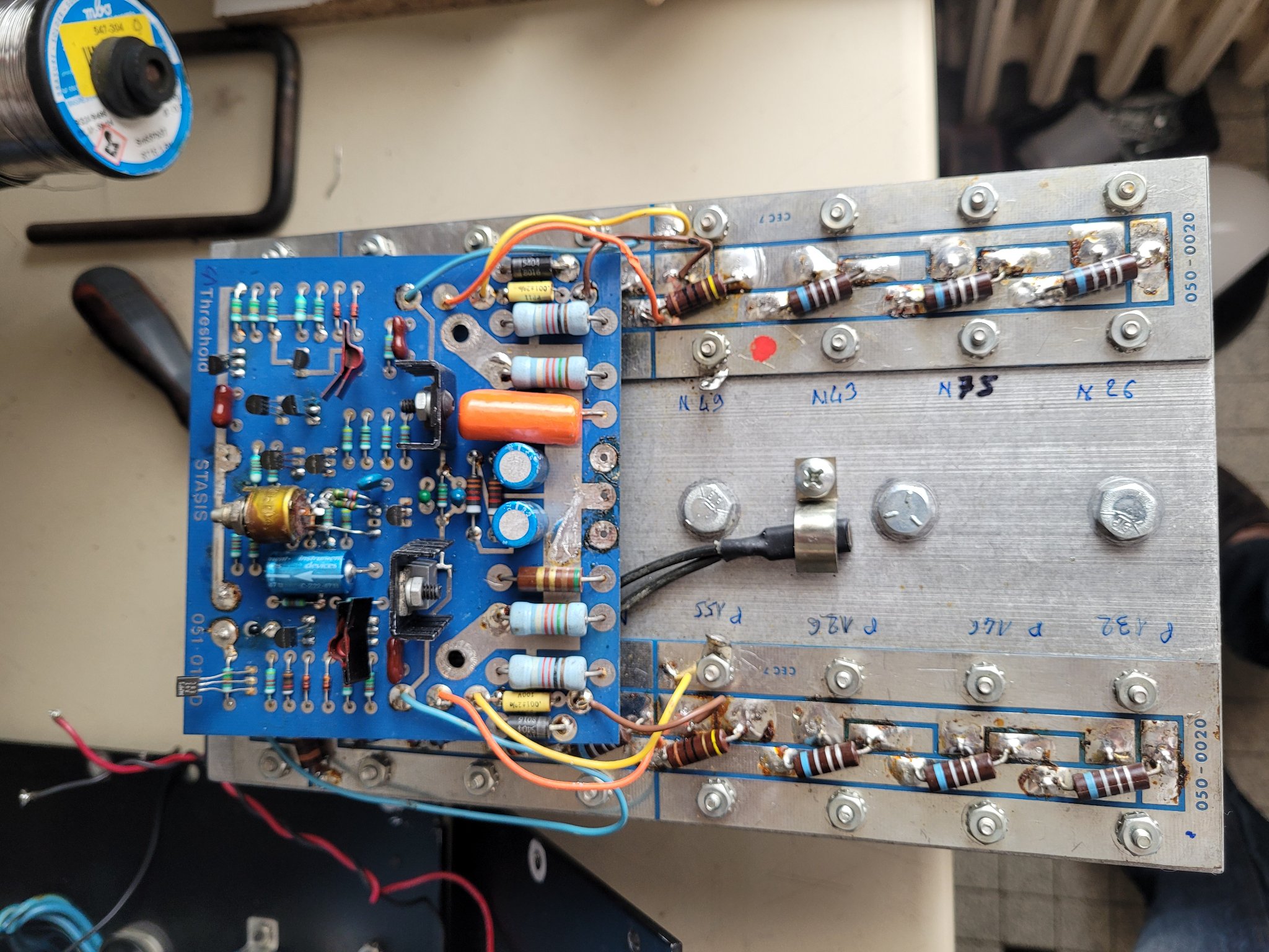

So I was right to take it apart, without knowing it. I replaced the 2SA112 and 2SC2592 with MJE15033G and MJE15032G, which I had in stock.

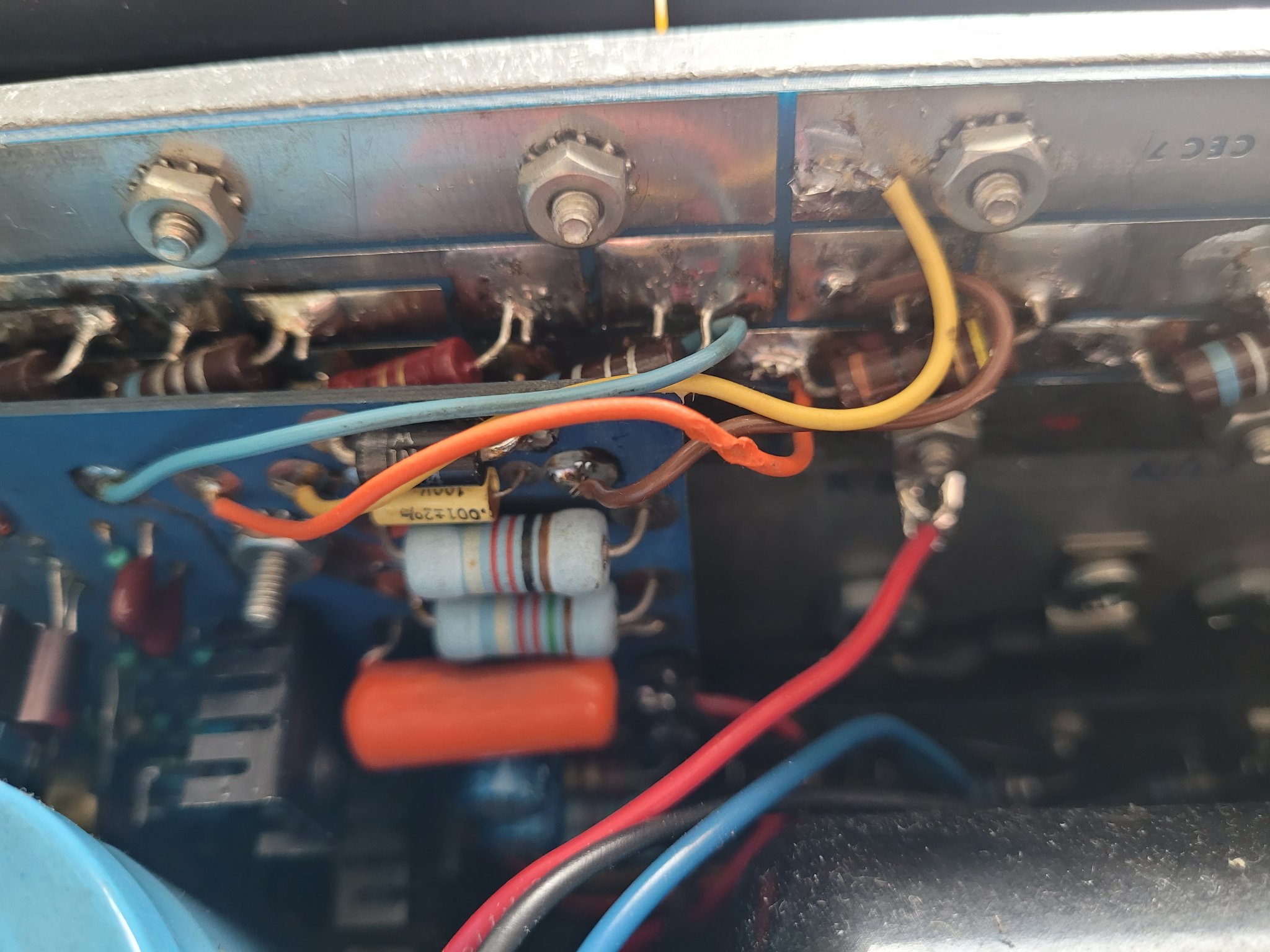

I rewired it, changing all the ring terminals and lengthening the wires so I could keep it open without unwiring anything. I also changed the banana plugs.

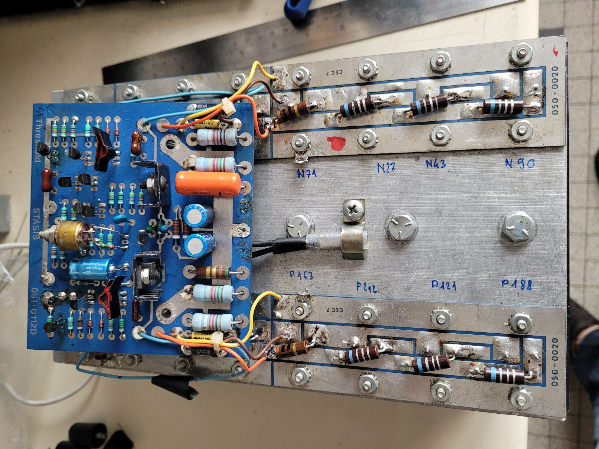

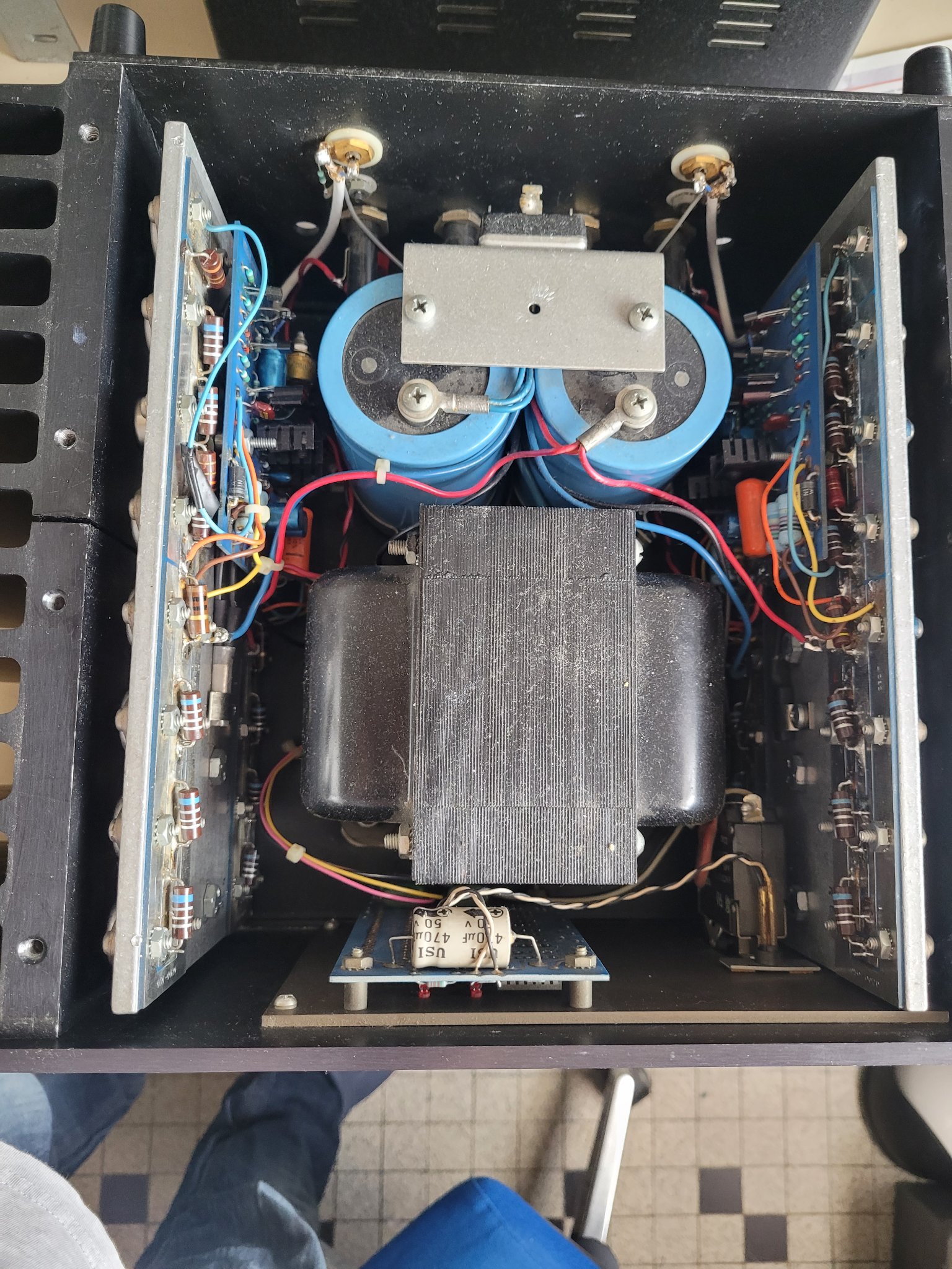

Here's some photos before my intervention:

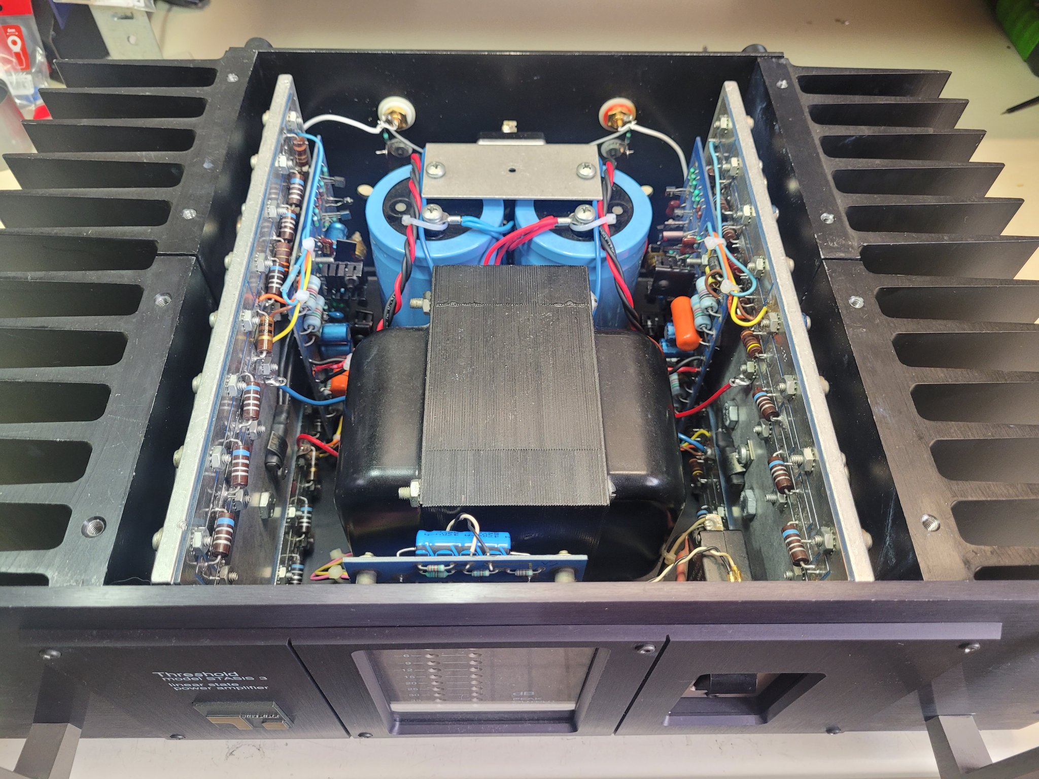

After my intervention

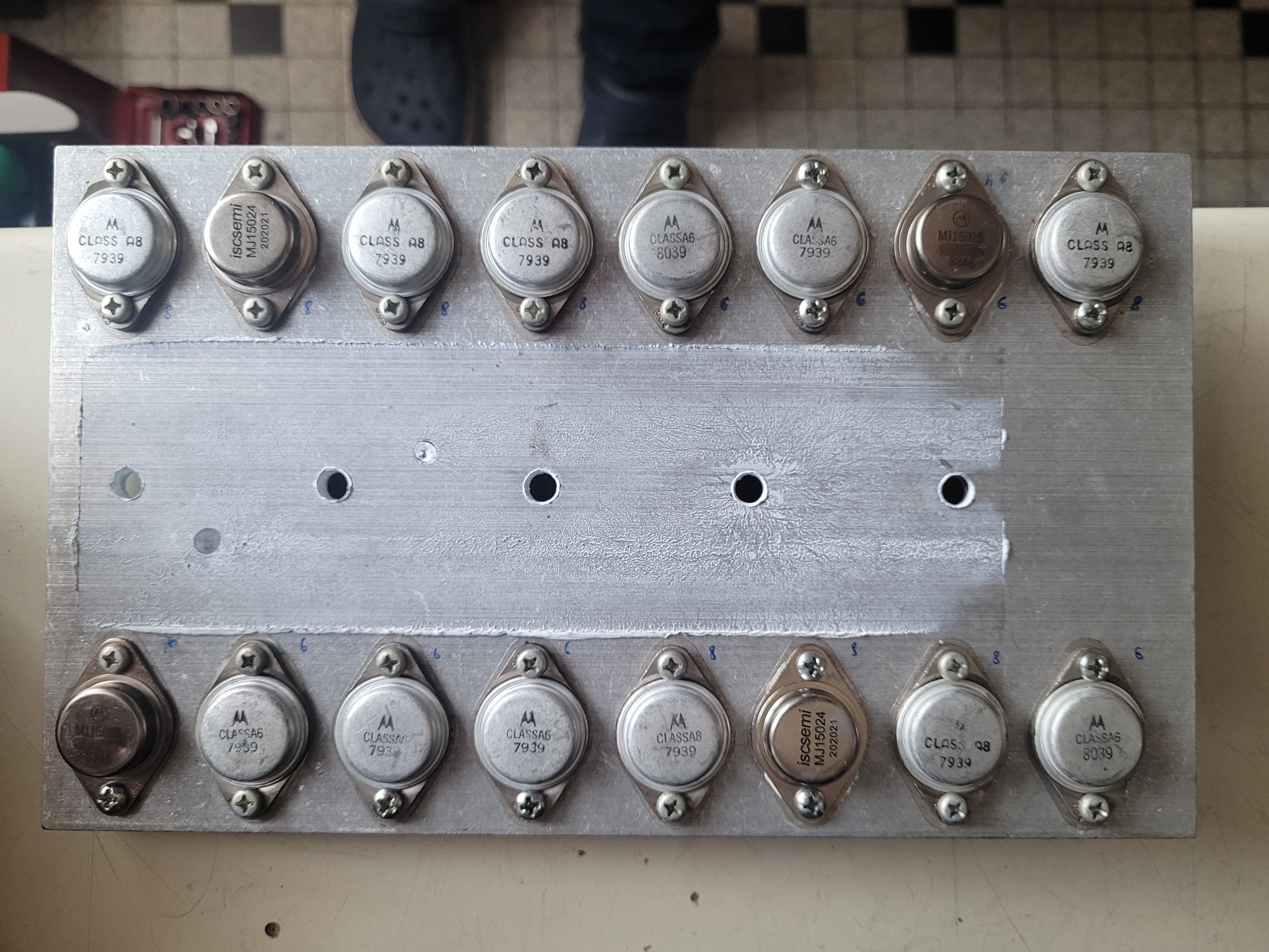

On one channel, only one TO3 was replaced, while on the other, four were.
I only removed the heatsinks on that channel to see which transistors were installed (MJ15024 and MJ05025) .

I just checked the voltage across the emitter resistors.I was at about 130mV, I lowered this value to 110mV on both sides, or 169mA per transistor.
But I can't measure this value on all the resistors, since it's wound up and few are safely accessible.I'm now waiting for it to stabilize.
If it doesn't heat up enough, I'll raise this value.

The number of TO3s is impressive!
