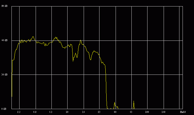

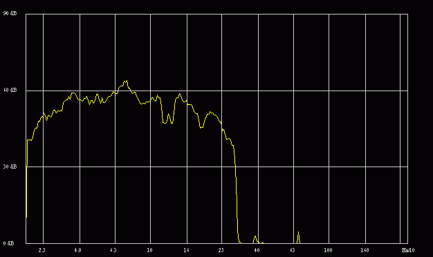

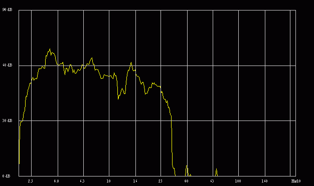

I recently read where someone at Peerless(?) broke in a speaker and stopped every minute and measured Fs and plotted the change. It initially changed fairly quickly and then after about half an hour was within maybe a percent of it's final value.
I did actually do a break in. I set them on the bench with 50Hz applied so I had about 8mm p/p cone excursion. I left it going for about an hour and a quarter, so if what I read has any validity then it should be broken in. I suppose I should have measured before and after. But 60Hz is a long way from a claimed 39Hz. Maybe the original samples where, and then somewhere along the way the manufacturer just quietly changed something for something else cheaper, or maybe one of their suppliers did with them. Who knows?
Anyway I'm not totally unhappy or anything but it does underscore what Francois said in another thread "I am also a fan of "doing great things with cheap drivers" but I want to remind you one thing: measure your driver with speakerworkshop. The driver alone might sound very good but one fact about cheap drivers is that the spec are not accurate. Try to find the real T/S parameters, you will be surprised how different they are". How true.
Anyway here is a comparison between advertised specs, measured specs, and measured again after I had decorated it with weights.
- Nom impedance: 8ohm
- Power handling: 30 watts RMS
- Frequency range: 31Hz - 3500Hz
- Sensitivity: dB 86 86.81, 79.01
- Voice Coil Resistance (Re): 7.4ohms, 7.05 7.05
- Resonant frequency (fs): 39Hz, 60 35.3
- Mechanical Q factor (Qms): 3.203, 2.89 3.747
- Electrical Q factor (Qes): 1.296, 1.29 1.58
- Total Q factor (Qts): 0.922, 0.89 1.111
- Equivalent Volume (Vas): 40.31Lt, 17.9 17.9
- Cone Area (square metres): 0.0203
