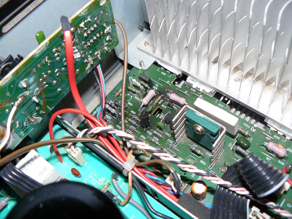

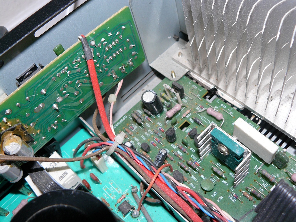

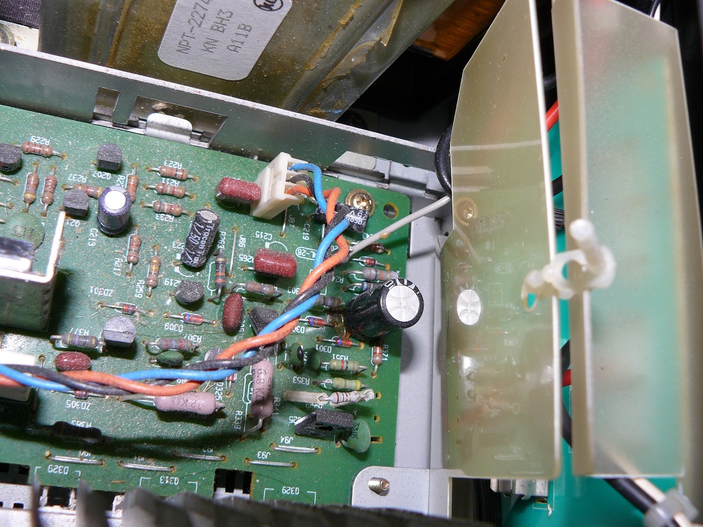

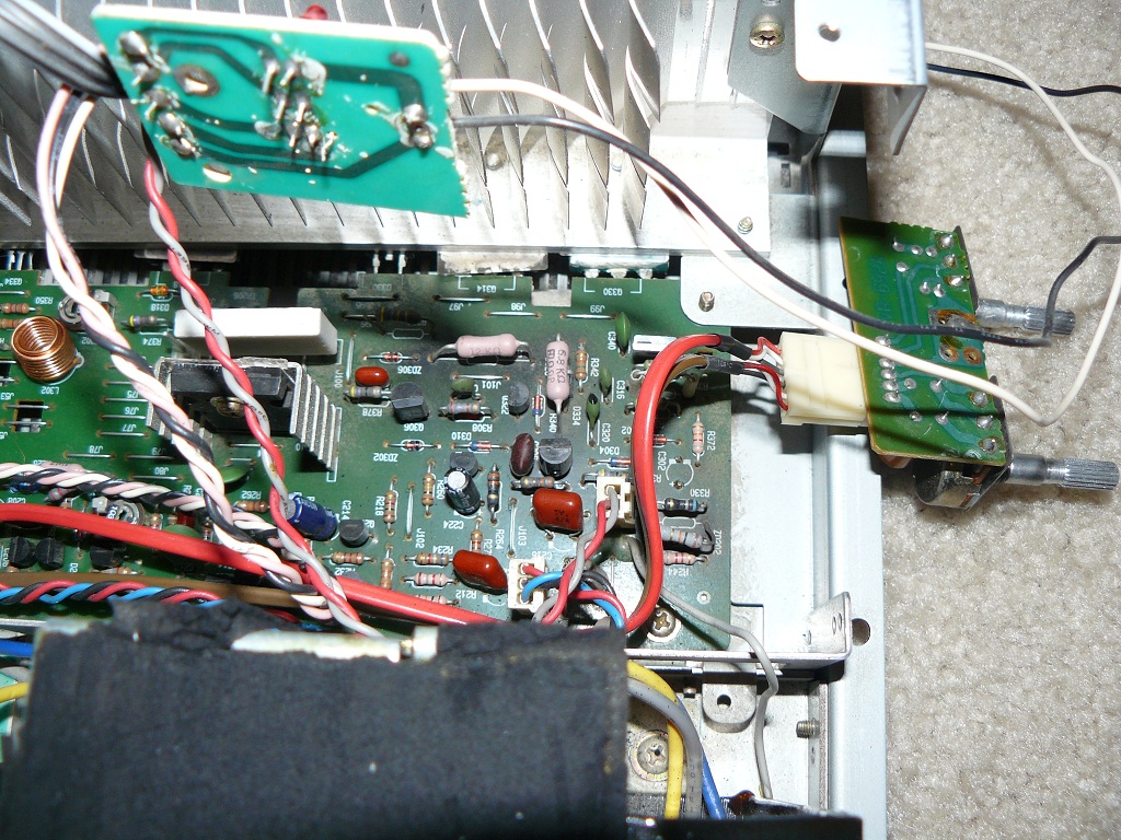

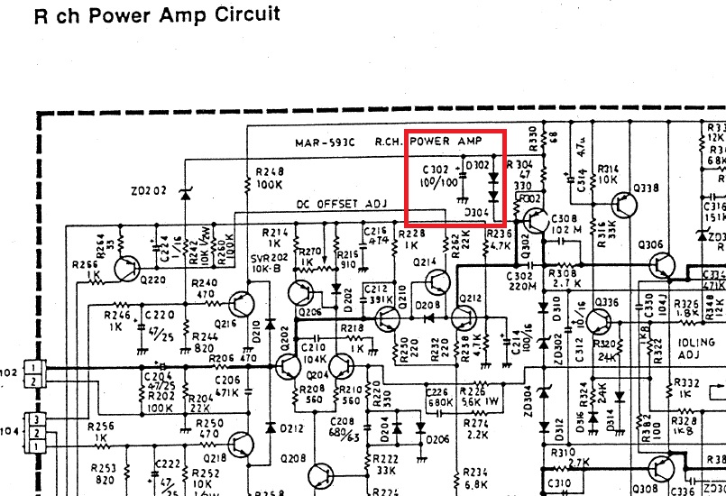

So, when I got home tonight I cracked open a liquid therapy (Beer) and decided to open up both of my amps, the broken one and the working one to compare and contrast a bit. A little background, I bought both amps used, including the non-working one in "non-working" condition, the current problem was described before the purchase, but the person I bought it from claimed to have no idea what the problem was. Both of the Amps are the exact same model NAD 2700THX, about 400 digits in the serial number separate the 2 amps.
Attached are come pics, where all 4 of the C300's caps are missing on the broken amp. I have not a clue what these caps do, and I am not sure if this was a design change, I am hoping from the pic's and the attached screenshot of the service manual some one can tell me if this could be related to the problem.
Thanks again.
Thanks again.
An old thread but who knows maybe you or somebody else kept the amp. You can clearly see the remains of the legs of the cap still in the holes, so somebody has violently removed the cap.
