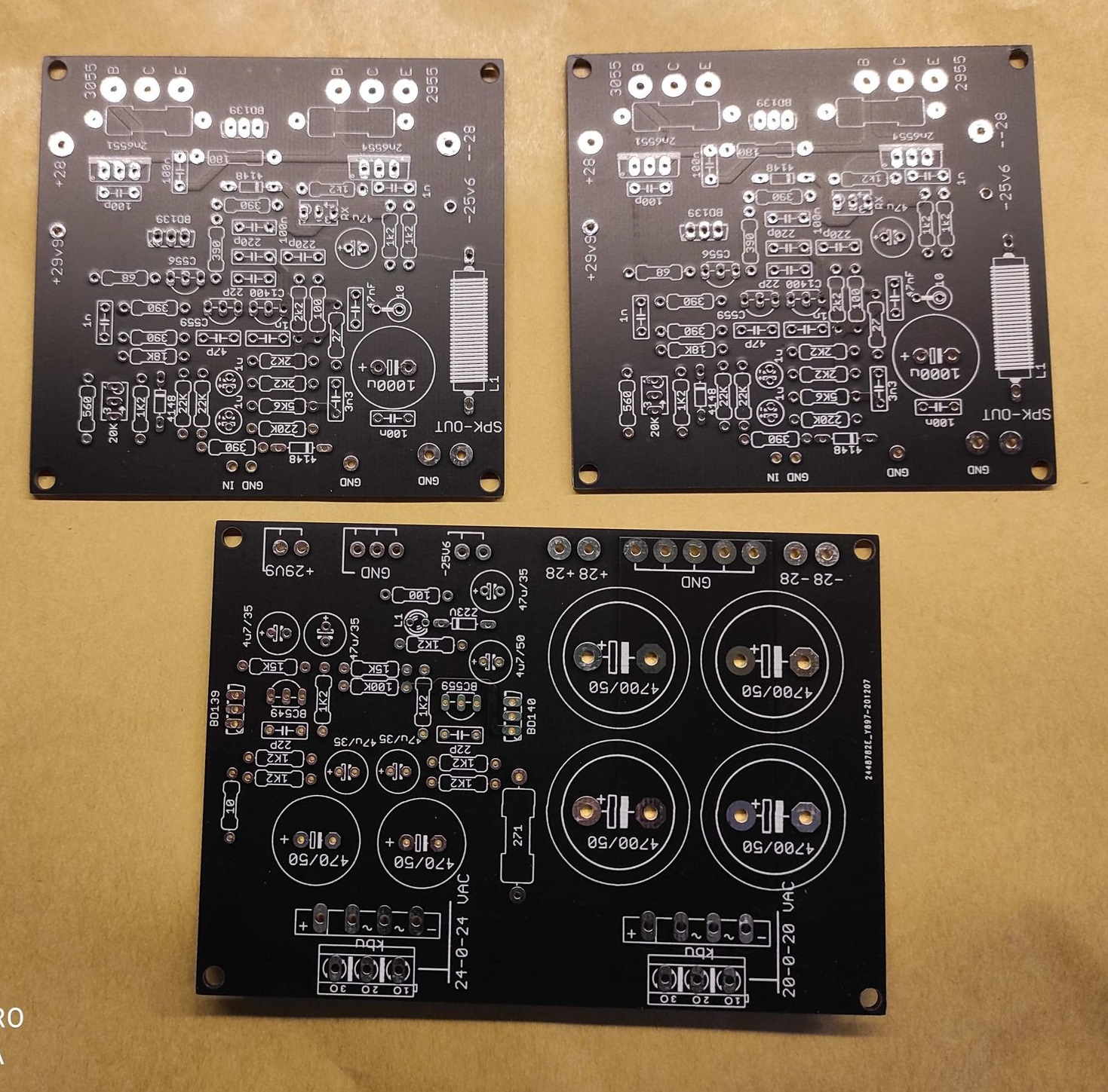

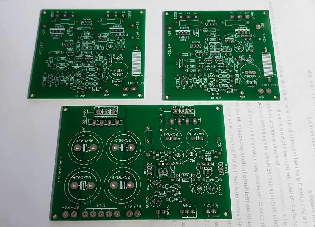

the sale in the link below a kit consisting of 3 pcbs for the construction of the final stage of the Nad 3020.
https://www.ebay.it/itm/275392868133
somehow agree Jan, but as this is a really old amp and you cant get a new, I would think it's ok ..... could be considered a tribute to this game changer of an amp :)
The 3020 was my first amp ... and man it was remarkable :) Good sound even driven to max, and very reliable.
I actually used 2 in bridged mode in the early 80's for DJ work ;) ... driving a pair of Cerwin Vega .... those where days :)
Questions scafas:
  • you have omited the output relay ... why? .... will get you a bug umpf at turn on/off ..... also there was a Over Temp sensor connected ... securing the relaiability
  • The DB139 must of course be mounted on the heat sink
  • Did you consider going for SMD to make a tighter and less noise prone setup?
  • could have been fun to change the output transistors as well .... but will need some simulation ..... actually updating the transistors to new and available types would be fun and helpfull ;)
  • You also left out the soft clipping circuit ...

Well unless you can find real 2N3055/MJ2955 output transistors, you'll for sure need emitter resistors.
The pair used in NAD 3020 is rather unusual in this respect. (Old 2N3055/MJ2955 where homotaxial types whereas modern types are epitaxial)
All modern output transistors will need emitter.
Would be fun to do a tribute anyway, using SMD components where possible, and maybe cranking up the supply voltage a bit .... but yes it would not be a NAD3020 .... ;)

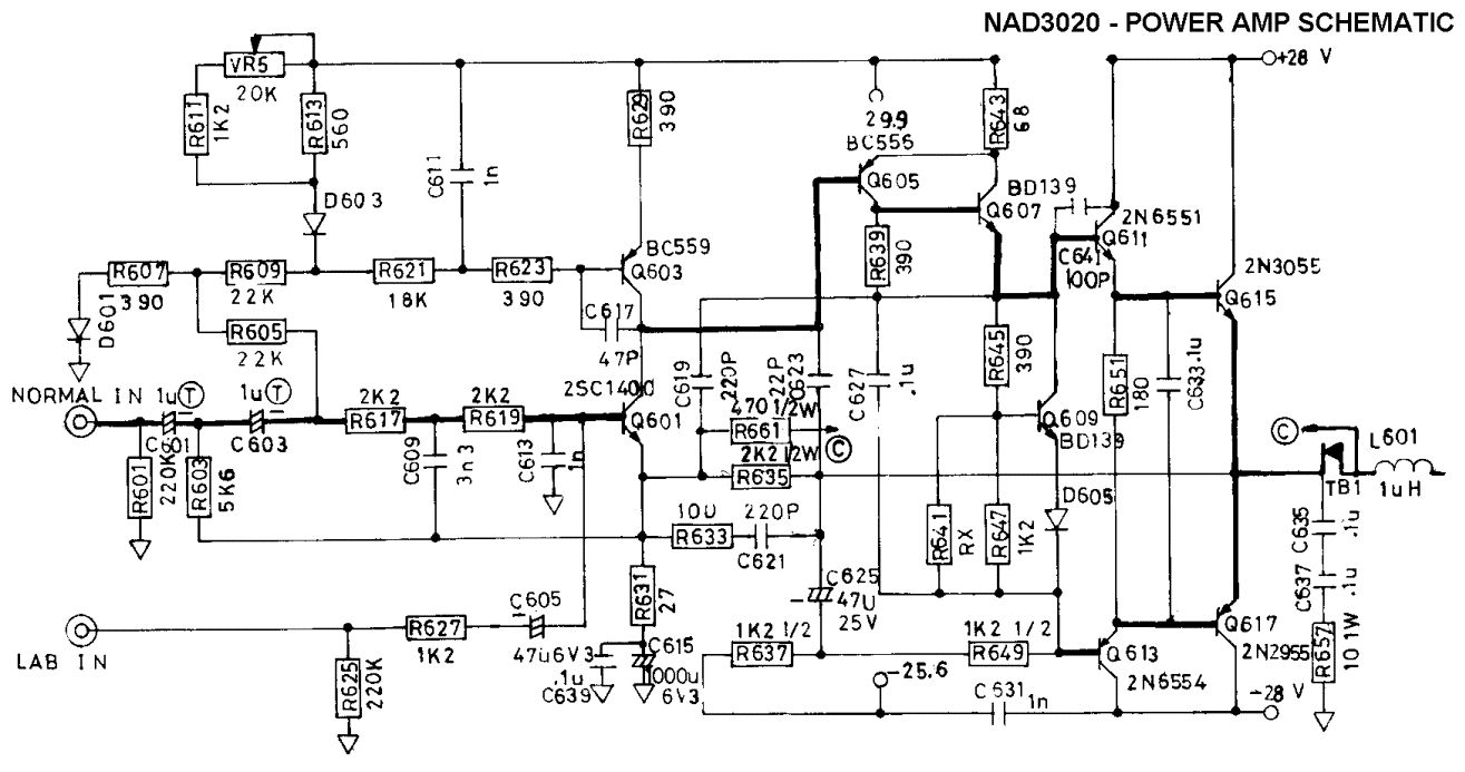

I once went down the rabbit hole and did a spice sim of the original design, and also made an improved version. You are welcome to try it out.
I think for a tribute amp to make sense today it need to be able to do at least 100 W. Speakers today are not as sensitive as in the 70's and 80's, and why would you bother the effort if it would not really fit the purpose.
Looking at the improved circuit today I would even suggest to use a pair of ThermalTrak output devices to simplify design and improve performance (would allow for SMD drivers, and no bjt mounted to the heatsink for bias).
The tribute part would be the single-ended input and the VAC section.
Anyway if an amp works well and within it's given parameters I think you should not be able to hear any difference.
But on the other hand this would be a good nostalgia trip :)
Rename the transistors.txt to transistors.lib and place in same dir as the .asc files for simulation with TLspice

And Jan you are of course right in attacking copying others work ... fully agree.
... forgot to mention that the PSRR of the original circuit leaves much to be desired .... probably why the input section needed a regulated supply.
My changed version has good PSRR for the negative rail but not good at all for positive ( only 28 db) .... so development would still be needed to get that improved .... and you would of course get further and further away from the original design ;)
