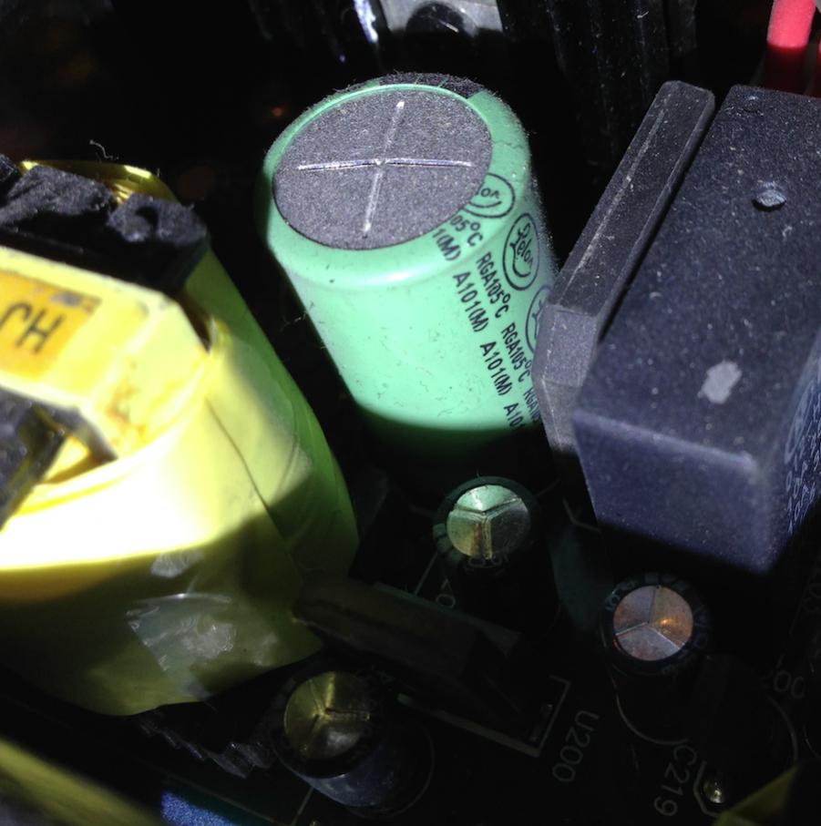

If it has never had it's capacitors replaced, there is a good chance that they could be the problem. If you are comfortable taking the top case off the amplifier you could then take a look at the capacitors (the small cylinder shaped components) in the PSU-B board and see if any of them are bulging at the top. They should have flat tops so bulging indicates a problem. You call also check the capacitors elsewhere on the other boards. If they are bulging they have to be replaced anyway, even if that is not the ultimate fix for this problem. It is a good first step.
In the attached image, notice the big green capacitor and two of the smaller capacitors are bulging. They are bad.
Due to it being an intermittent issue, it might also be a problem with bad solder joints that need to be re-soldered.
There are a lot of dangerous high voltages inside so while it is ok to take a look at things to look for obvious problems like bulging capacitors, since you mention "I'm a total layman within electronics" it may be best to get an electronic repairer to do the actual repair. You could show them this thread. Up to you to decide if you can do this work yourself or not.
