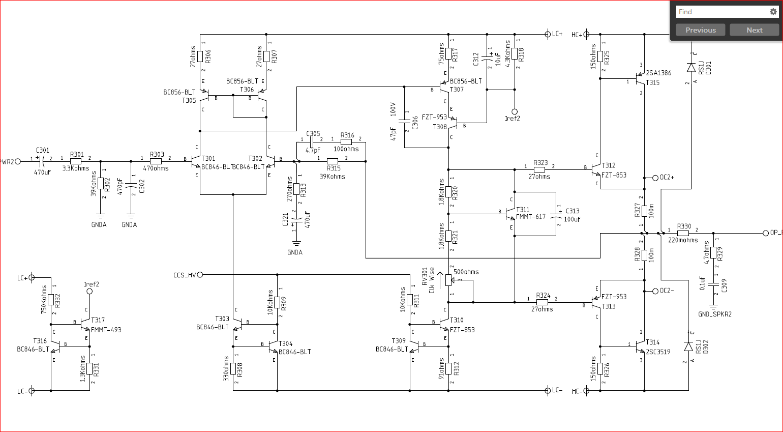

It doesn't surprise me that the Nait 5i sounds dull. That's predictable from the circuit design. What does surprise me is that Naim made this circuit. Did the recipe get lost when Sells was put in charge? Weird.
Schematic the Nait5i more different with Nait3 and Nait5
Nait5i/5si/super/Xs have a different input and output design.
Output is not quasi :))
About Steve design...
“i'm an artist i see it that way..”
nait5 schematic (I believe :)
Joined 2010
Yes, the above schematic in #4526 is the 5i design (2003) - same as referred to earlier. The missing schematics are the earlier Nait5 (2000), and Nait5si (2013) which I haven't found on the internet yet. Perhaps the Nait 5 was a work in progress at the time and the new management team wanted to start afresh - leaving the product as JV intended.
It seems the Nait5 had problems from the start, which at least the new management team must have realised, with 2 significantly improved versions already. So the question I'm actually asking here is; what were those "improvements"? Just more power, standard RCA connectors and complementary output stages? I think that the beefier XS integrated amplifier also went through 2 revisions or "i=improved" versions at about the same time, maybe that's also relevant.

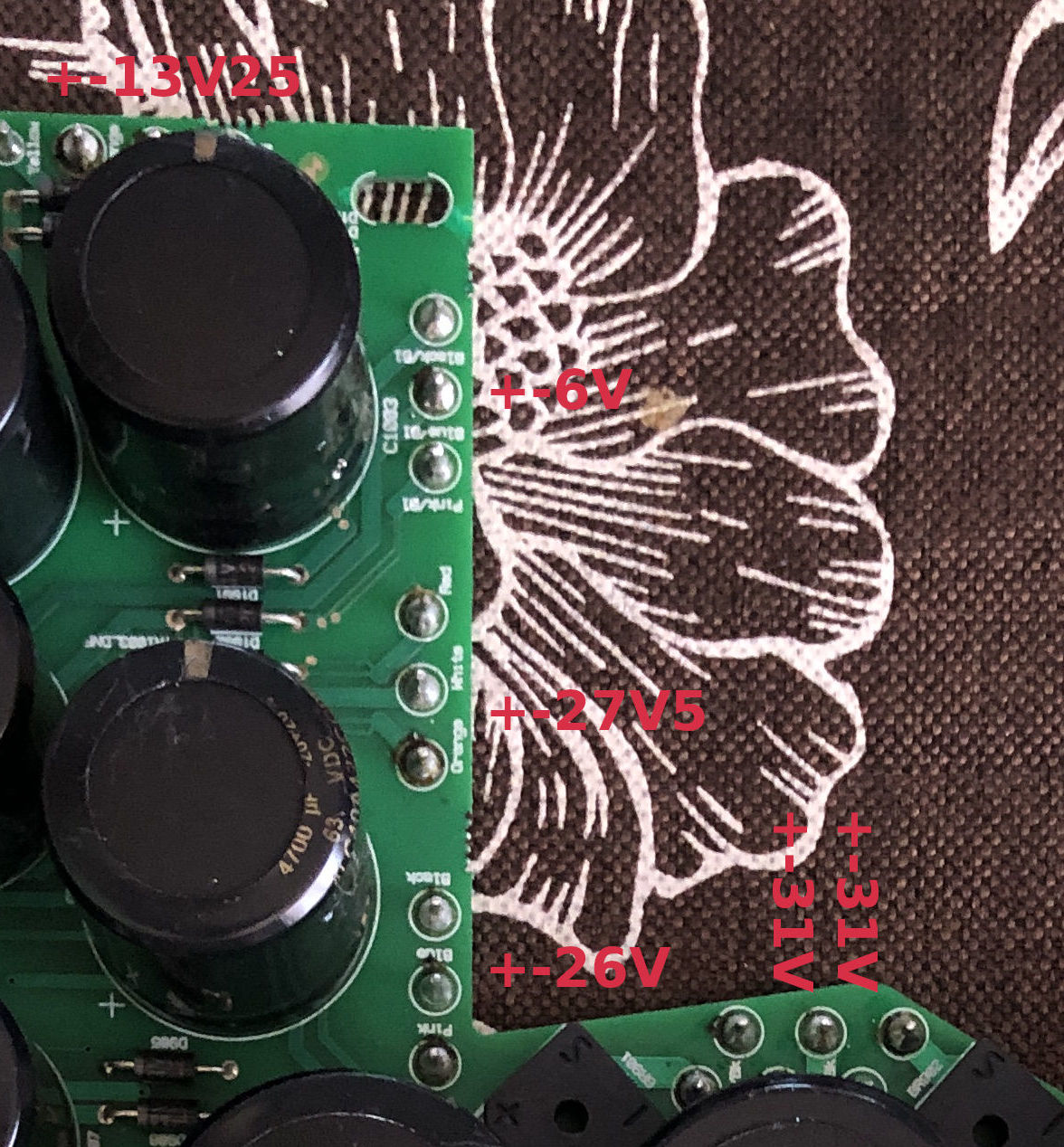

My friend JPK checked for me Supernait inputs voltages
And 31v-G-31v AC Is very HI power output to speakers :)
I think the Supernait2 have a same voltage but I not sure. Maybe Supernait2 have more power.
My schematic has named as Nait5ii / 2012.
Reactions: 1 user
Joined 2010
I may have missed something but the 5i and 5ii amplifiers seem to be very similar if not the same design, at least as far as the power amplifier sections are concerned. Apparently, the original Nait 5 was rated at 30W/channel/8R though a couple of reviewers believe it is more capable than that. The Supernait is rated 80W/8R and Nait5 ("i" and "ii" versions) are 60W/8R). I guess those differences are mostly due the sizes of the power transformers.

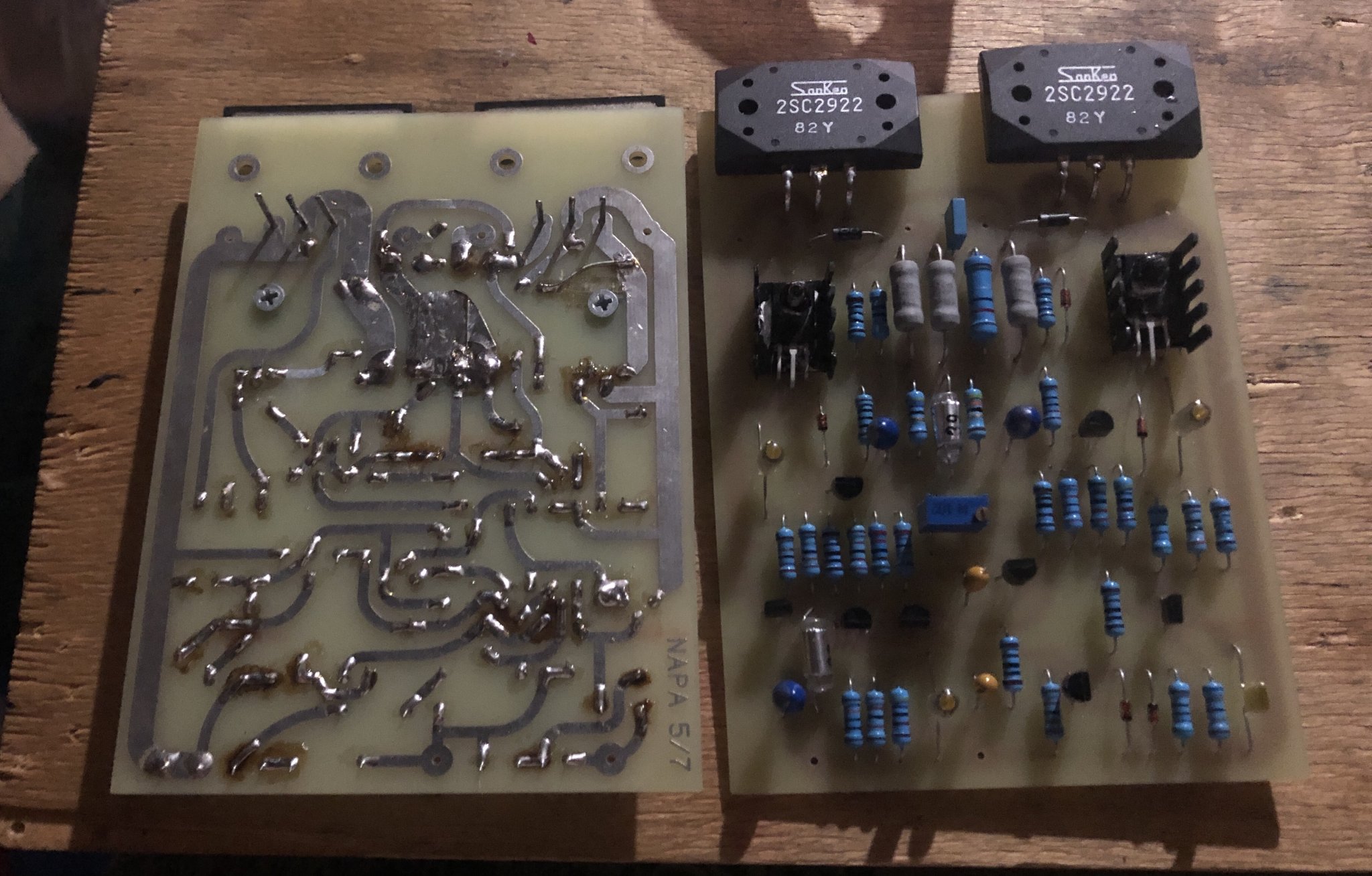

If you want to make great experience, you can try to make a DIY Naim stuff. It's really difficult to find real naim sound. Perhaps, you can find real values and material and you can finish with very good sound. But, like me if it's difficult to find real Naim material like transistors, capacitors.. you have to try many different materials and may be spend too much money and time :) NAP140's material can be found and like me you can get real sound after perhaps one year after :) after trying many power transistors and capacitors, diagrams. But, if you don't want to spend much time for this. It's easy to find a second hand Naim. You can renew some capacitors and use it. Very very simple and perhaps cheaper. Also, note that at least Naim has 5-6 kg toroidal transformer :) Also, note that if you make a naim diagram you will get an amplificator, not difficult.
