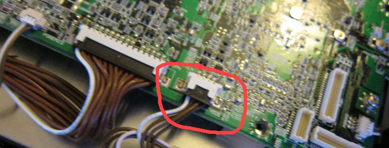

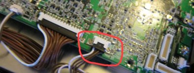

Just beginning my first foray into modding projectors to run with LEDs. I've got a pile of them and have picked a GT-950 to start.
It's a BIG projector so lots of space inside to work with.
So far I've removed the ballast and worked out which wires to join to defeat the lamp check. I can project my desktop to A4 in pitch black just using a cheap LED torch so now.. I need to sort out the light source.
I've ordered a CREE Q5 LED w/Driver HeatSink.. DIY UltraBright CREE Q5 LED w/Driver HeatSink - 12v on eBay (end time 07-Apr-11 11:31:17 BST) to get me started. I realise there are higher brightness ones but am still reading up.
Anyone any tips or input to help me along the way?
Here's a pic of the wires I joined to defeat lamp check..

I joined wires 2 and 3 (middle two)

I am not sure if your projector would have this, but I am sure it should, but if you look down the light tunnel towards the engine, at the entrance where the lamp light begins its journey, the light is filtered through a set of lenses, a metal mesh, a brick of something that looks like a bodged together lines of snowy glass and a few more lenses. remove all that crap except the last lens in that batch before you reach the mirror that split the light. The metal grate will cut off half the light from your LED, removing all that crap should help a lot.
If you can upload an image, I can explane more of the light tunnel, be careful not to remove the other mirrors and lenses as they are still needed.
