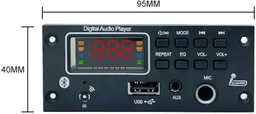

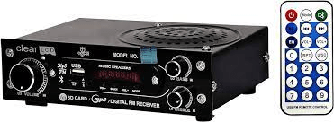

Look for FM radio module...they have player built in.
$5 and up with remote here in India...
No OS, plays MP3 only, no others like FLAC or Ogg Vorbis, they do play .wav files... module needs 5V 50 mA supply...battery charger from old cell phone is good enough.
Or build one, the FM module (with Bluetooth, SD and USB player, and external input) included, costs like $1.50 here, and you can add amplifier.
Be creative, here some are built into portable fan / light...same battery!

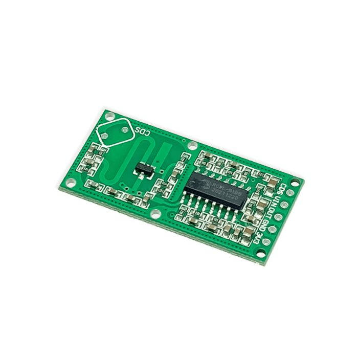

As for the presence detection side of things, I've used these microwave boards with good success in the past:
Microwave Presence sensor (RCWL-0516)
They are cheap and easy to implement, have a wide input voltage range and a 3.3v Hi/Lo which can usually interface directly with a microcontroller board.
