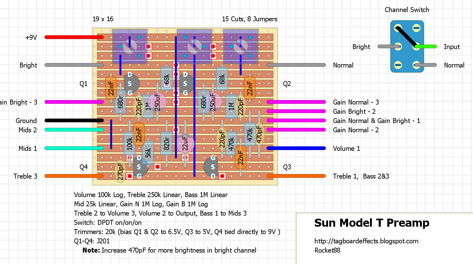

My main idea is modify the diagram of the model t preamp diagram and turn it into a practice amp. But with my lack of knowledge (maybe ignorance) I could not figure out how I could modify this diagram and build the final product.
The challenges for this project:
The amp will drive the 4ohm 3W exciter,
It should be suitable for bass guitar and
I want to use saturable reactors as a gain component.
Basically i do not know how to set the output for 4ohm 3W. I know I need to select input and output capacitors a little bigger for making it bass guitar friendly but is there anything else that I need to tweek? Last but not least is it a stupid idea to try to create an amp based on a preamp circuit?
I shared the diagram for the Sunn Model T preamp that I want to modify. I will be so glad if someone can help me with this project.

The active devices (tubes, transistors) are restricted in what they can do.
Some are more suitable for a preamp. Some are more suitable for a power amp.
Even the topology itself (how the parts are connected together) can be more suited to a preamp or power amp.
Start with the speaker that you want to use, and its drive requirements.
You can begin the design with a blank sheet of paper (if you have the experience and knowledge),
or else with a known circuit that closely approximates what you need (if you don't have the knowledge).
But that preamp is not close enough to a useful circuit to start with, for driving your speaker.
Maybe you could start with a Sunn amplifier instead, but it would probably have much more output than 3W.

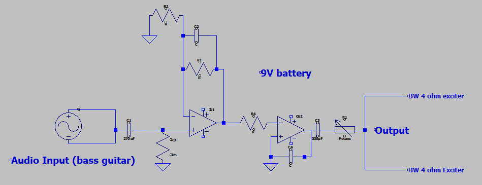

I made my first design with what i understand from other circuit diagrams.
I have found lots of JRC4558, I heard they not so good for audio but I have a lot of them right now so I wanted to use them.
For speakers I have 2 cheap speaker exciters (3W 4 ohm each) which I am planning to use both in the same panel.
Last but not least, if the circuit can work with a 9 volt battery it would be perfect.
Now I can not calculate the component values for driving the exciters. I don't know how to calculate the output wattage. As far as understand i need 6W for output. I could not find a dual opamp in LTspice so I drew 2 op amps in series.
If you can help me with reality check again i would appreciate it.

Still the same basic problem, a 4558 can't drive a 4 ohm speaker driver.
You can possibly try a many-in-parallel opamp solution but not sure that's a good idea for a 1st project.
Do you have anything in your parts drawer that might be an alternate solution? Either some kind of power transistor, or maybe one of those ubiquitous 100 ohm paper tweeters?

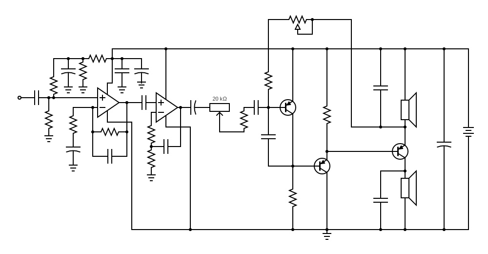

i have lots of voltage tranformers if they are relevant. i can salvage some power transistors from old laptop adapters or led bulb drivers or some old car electronics. Also i have some pnp and npn transistors like A42 or A92 or 2n5401 etc...
I can try to add preamp stage and AB class power stage to this i guess

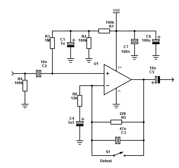

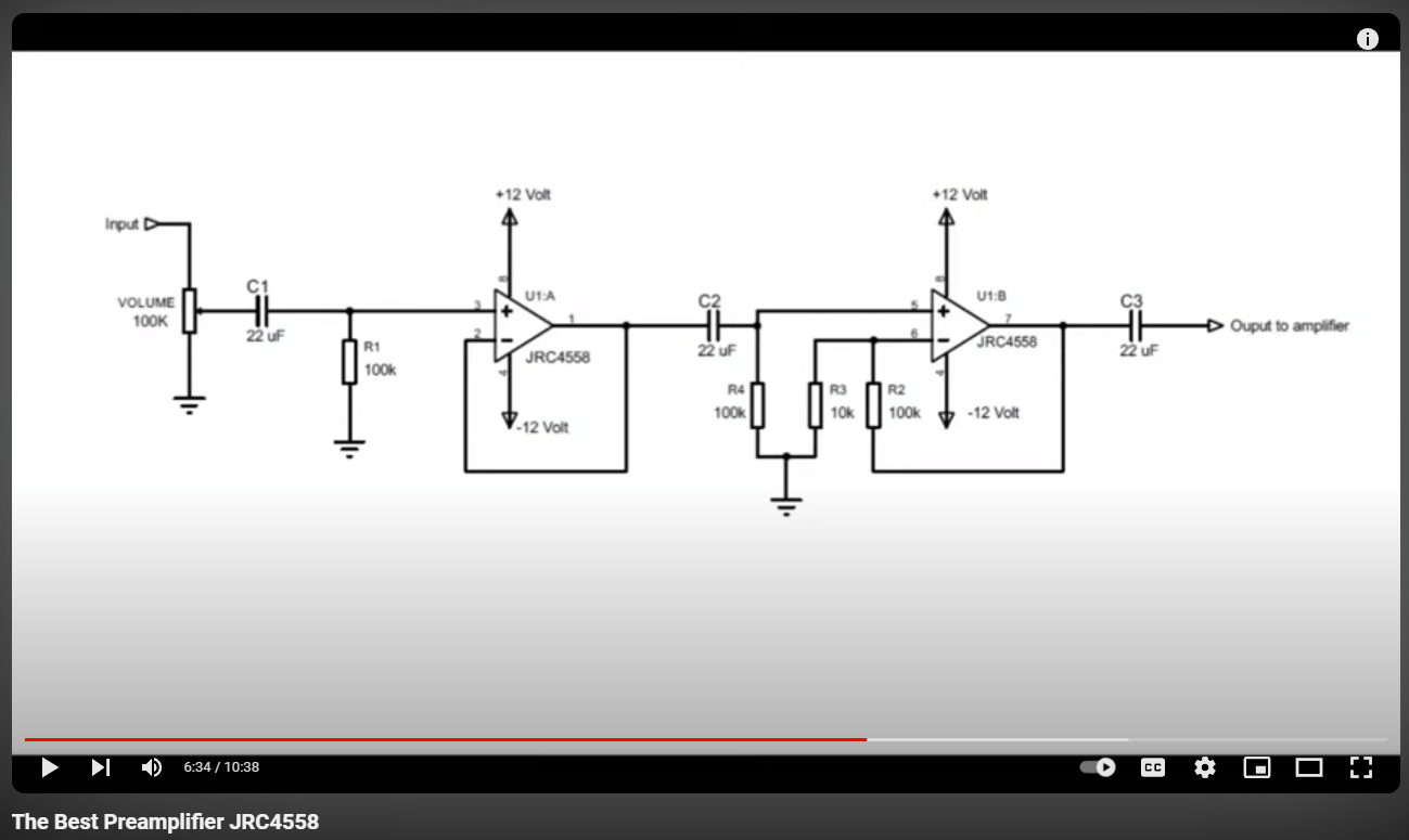

After I searched a bit more I found some circuits that I think I can use as reference, then I tried to put them together. Only addition that I made is a low pass filter at the second stage of the preamp to cut above16kHz.
I attached the reference circuits also in case I made a mistake while trying to redraw them.
What do you think? Can this idea go somewhere usefull?
