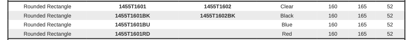

hammond 1455Q1601 (160x125x52) will probably fit the preamp power supply + amp + iec inlet w/ fuse.
Yep. That should work. You may have to put the power supply and the HP-22 side-by-side, which would push the volume control off-centre, but there is enough room in the box for everything as far as I can tell.
One option for those who won't need or want the 3.5 mm output is to cut off the part of the connector that extends past the edge of the EVM. This would allow you to mount the HP-22 by the nut on the volume pot. Then solder wires to the EVM output for the off-board output connector.
I may buy one of those boxes and provide drill templates for it. That'd be neat.
