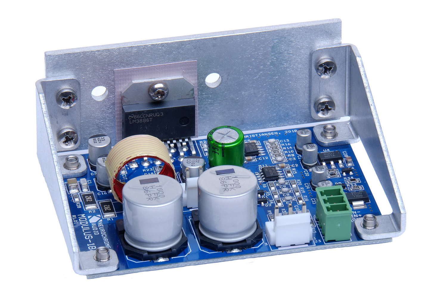

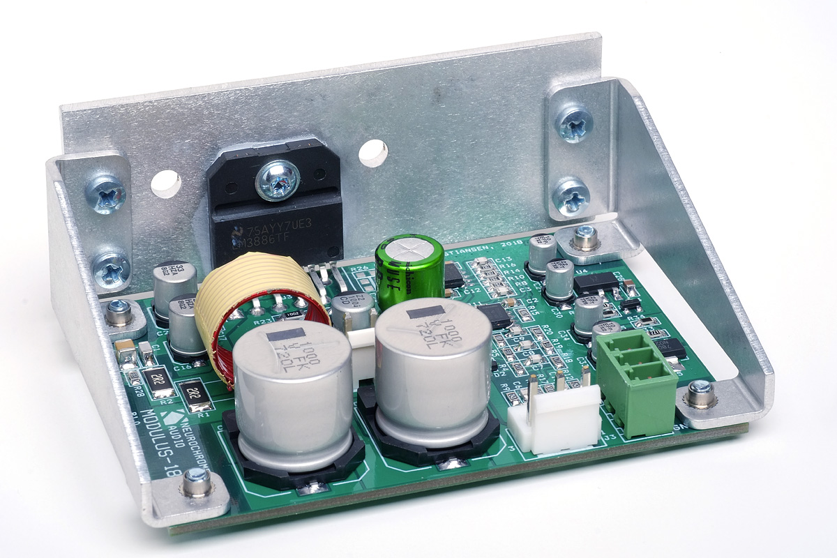

The Mod186 doesn't look like it works very well if you would like to stack boards over each other to share a heat sink. All the connectors face upwards and the megafit is rotated 90 deg from the Mod686. You can use a vertical plug for the megafit, but the wire to the plug has issues on one side with the standoff and on the other with wires from the adjacent connector.
Neurochrome.com
Joined 2009
It depends on how tightly you want to stack the boards. I'm putting a Modulus-286 into an enclosure that has a mezzanine plate (for the power supply) located 36.5 mm above the chassis bottom. The plate overlaps the MOD286 board (which uses the same connectors as MOD186. The MOD286 is located as low on the heat sink as possible. This puts the bottom of the PCB at 9.9 mm above the chassis bottom (there's a bracket below the board) and the LM3886 about 1/3 up on the heat sink. There is enough space to get the connectors in there. You'll definitely have to bend the wires at the connector, but I think it'll work.
Of course if you want enough room that you can unplug the connectors within the board stack, you'll want more like 50 mm between boards. That won't work on a 2U heat sink, but should work on a 3U heat sink.
You can also rotate the boards 90º on the heat sink and "stack" them along the long dimension. You should be able to fit at least three boards on a 300 mm heat sink. The Modulus-186 is 3.55" wide, so you'll have to use a 3U heat sinks for that.
You are correct that going with a horizontal connector would make it easier to stack the boards. Unfortunately, that eats up valuable interior space in the chassis. Most builders seem to be more concerned with the additional space required for the horizontal connectors than eating into the space above the boards, so I went with vertical connectors. If you don't like it, you can always de-solder the connectors and solder the wire in directly.
Tom
One could also install the top board 'upside down' with the bottom of the lower board close to the bottom of the chassis and the bottom of the upper board toward the top of the heat sink. That would maximize space between the boards, the downside being somewhat less tidy cable routing.

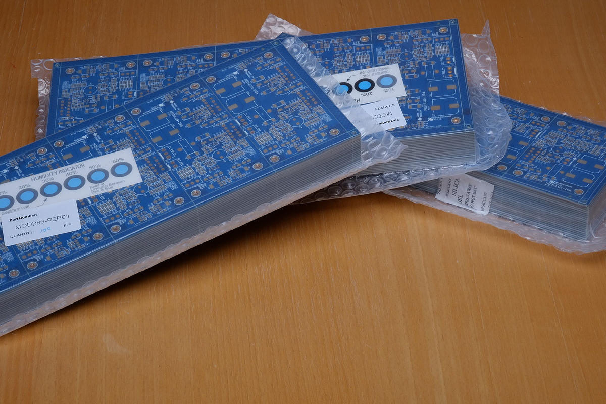

Shaping up... This is still a prototype. The real version will feature a blue circuit board and be professionally assembled.
I took delivery of the blank circuit boards today. 8 kg worth!
Tom
