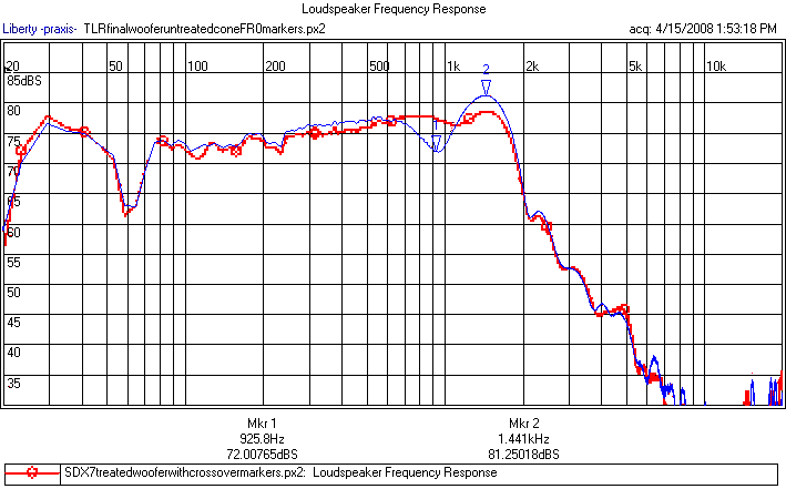

The original goal that i proposed when Ryan took these away was to see if we could get them to match-up with the natural roll-off of a treated SDX7. The red curve. The tweeter with wave-guide goes so low we might have to choke back the top of the SDX7 a bit. Might well work in conjunction with flattening the top of its range.
attachment.php
dave
