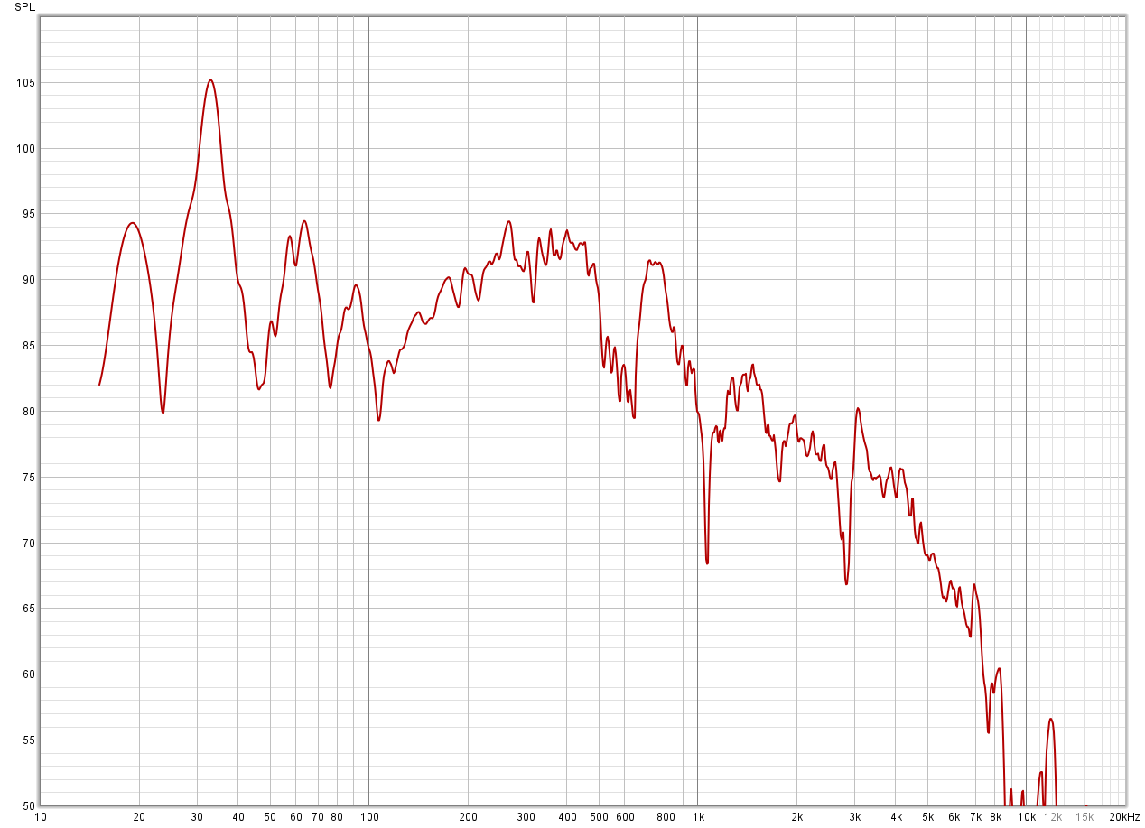

That's probably THE benefit of closed enclosures! Did you ever do room measurements and/or a subwoofer integration?What's the benefit to use it sealed with EQ?
You quickly get +-10dB just for resonances and Problems the room introduces. And SOME of these you can fight with EQ - and that really helps.
The good thing about closed speakers - they produce plenty of SPL under their resonance frequency! So when boosting 6-10dB you get to really low frequencies (just use one woofer more - which is then about the same volume as one woofer in reflex). Then add the behaviour of the room and you can easily go to 25-30Hz linear with such a system.

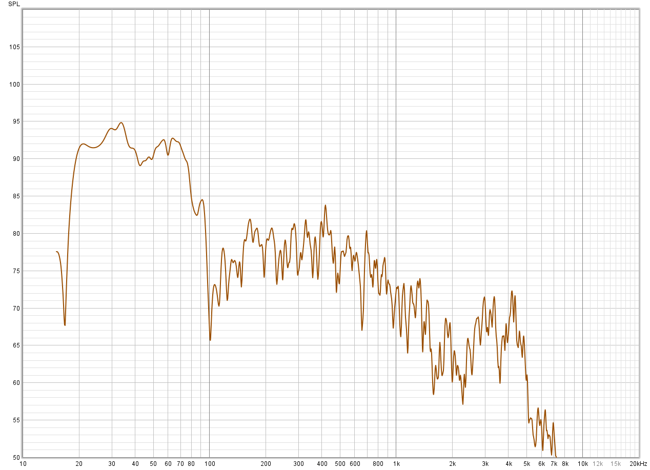

That's the FR of my subs in my living room home cinema near the subwoofers. (6x SB29NRX75-6 closed. The room adds a lot at low frequencies!)

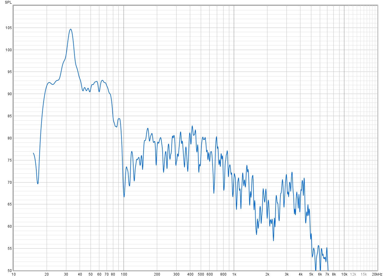

Followed by the FR at listening positions (which is way better) without and with ONE filter for the 32Hz resonance.
A reflex woofer down to 20-25Hz would be totally nonsense in this room and position.
