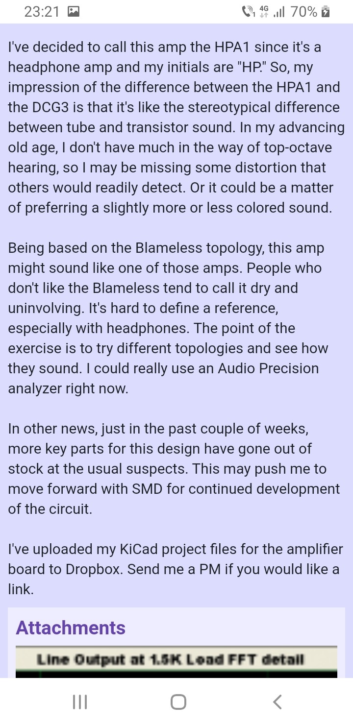

As you offered some hints to Stereophile having your amps as their new refference and HPA-1 is a name that's probably having a patent on it, I don't see any legal way for you to change Nelson Pass's HPA-1 with yours.I think you made a serious mistake if you wanted to compete NP this way cause once you're on the market and not in the diy community you can be sued with the name of your choice and believe me...the money you get on your Rolex won't be enough to pay the lawyers for such an issue against NP.:

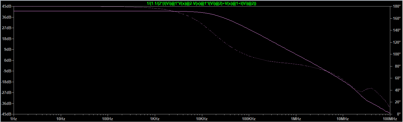

I noted earlier that the HPA-1 has low feedback because the driver stage is heavily loaded. I confirmed in SPICE that it's easy to tweak the A3 to have the same gain-bandwidth profile as the A4. This is an A3 Bode plot with the two driver load resistors changed from 4.7K to 200K, giving 100K in parallel, like the A4. I doubled the feedback network resistance to bring the loop gain back down to 40 dB and lowered the compensation capacitor accordingly.
The theory is this may make the A3 sound more like the A4. To my ear, that would be an improvement. We will have to see. Assuming a good result, it may be that the same tuning would not sound good in a production HPA-1. Different amps, different tradeoffs.
