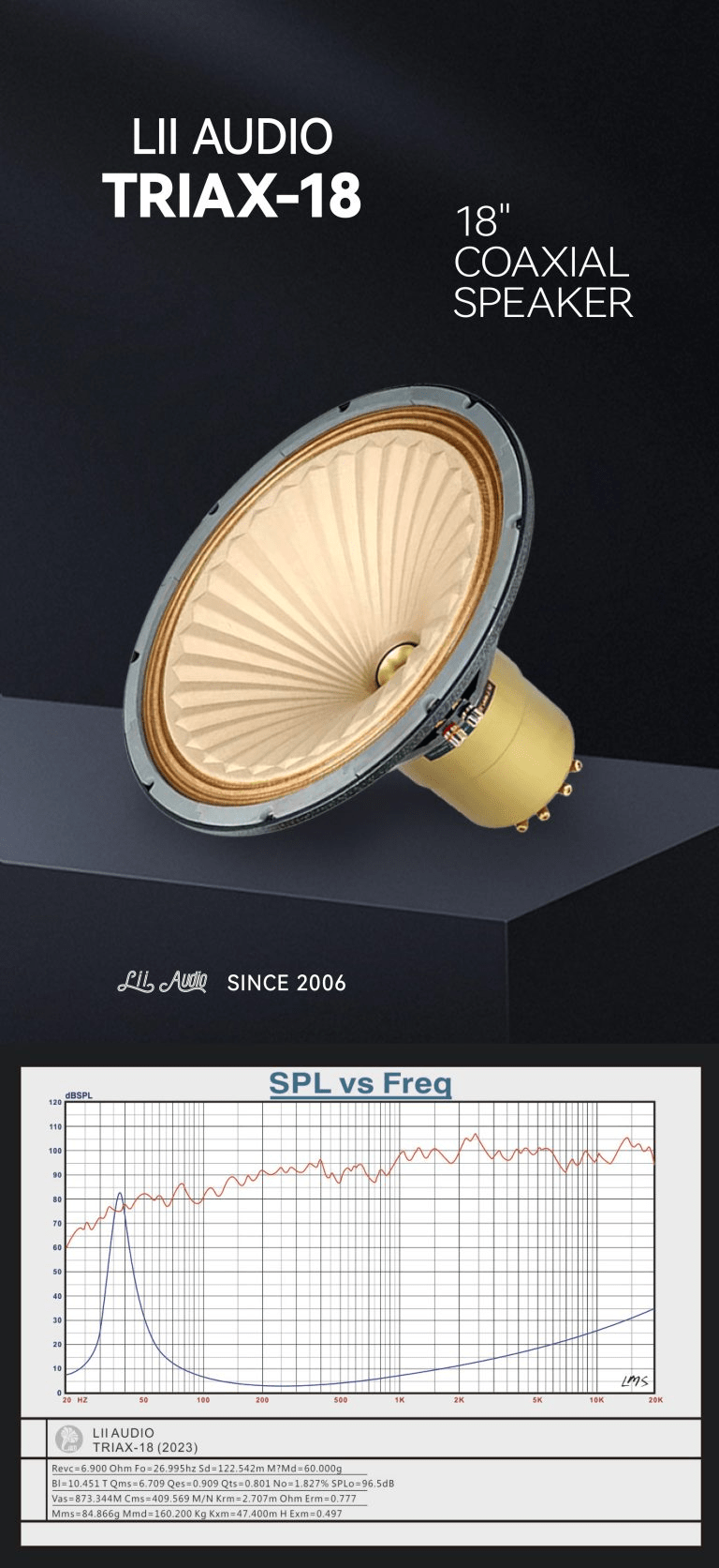

imagine what the triax 18 would be like, OMG!

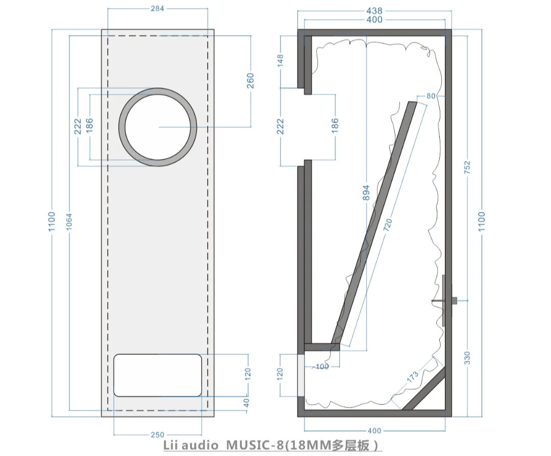

Hi complete noob here with very little understanding of speaker/hi fi builds. However im willing to learn and seriously keen on building some lii AUDIO based open baffle speakers. I've been looking at the lii song site for ages but want to go with the lii Audio not least to support the original founder and due to what i've discovered on here also they seem far better. I'd like to build a pair of speakers with hopefully 18in baffles paired with something like the music 8's or some other full range. I'll be building a class D amp based on an ICE power1200as2 as its pretty much plug and play and achievable with my skill set plus its got plenty of power
2 x 700 watts at 4 ohms
2 x 620 watts at 8 ohms
Minimum load2.7 Ohm
Efficiency80%
Distortion0.005 % THD+N
Gain25.8 dB
Input impedance38 kOhm
Do you think this speaker/amp combo is a good choice and will it be easy enough to have someone design and build crossovers? I honestly know nothing about the tech side of this just a lover of good music and quality sound mostly playing Jazz records and occasional electronic music and reggae. Also did you buy yours on Alibaba ? I found this link not sure on the sellers authenticity though. https://www.alibaba.com/product-det...offerlist.normal_offer.d_title.59e11342wUnRLE cheers. PS he seems to have LII Audio and Lii song on offer so buyers beware before you bite the bullet.
Reactions: 1 user
Hi. I personal would just build the recommended folded horn with the music 8. It'll get you into high 20's - low 30's with room gain. No crossover, just the box build.
Here's a plan to consider.
I bought through ali Express with a seller called "queensway." Also the "official lii audio" is legit. Before you purchase show them what it is you are interested in and ask to see the packaging. Queensway package very well with triple boxes with very nice protection. They were also very communicative. The "official lii audio" seller is also very good with communication and exclusively deals lii audio. If you can't find them searching by name just type inlii audio music 8 and check the sellers.
It's important to ask to see the packaging because one seller sent me packaging of a totally different product because they don't have the speaker in stock and we're going to delay things with ordering and then shipping to me after. It would have added two weeks to the order. Queensway used dhl. It took three days for the PayPal to clear then three days to receive the order.
As far as your amp goes, up to a hundred watts of probably fine. You could use your mega watt just be gently on the volume dial. The music 8'are a delightful speaker to enjoy.
