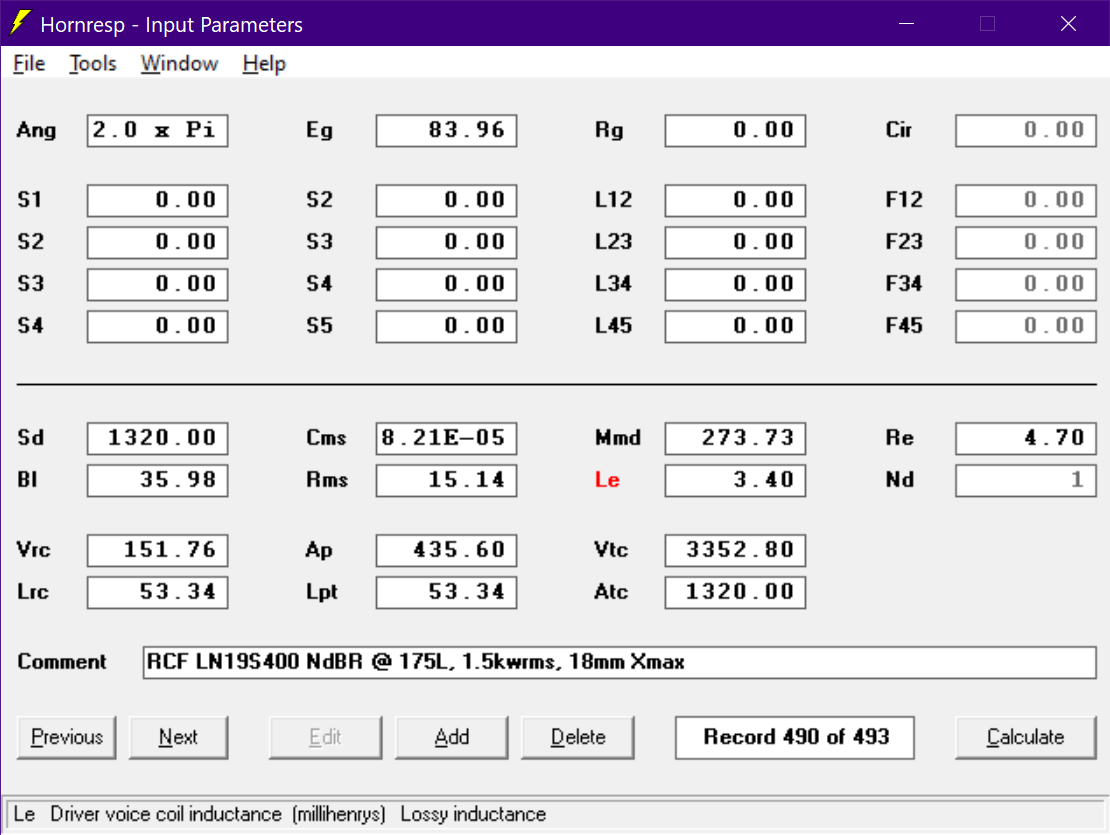

RCF recently released new high excursion drivers LN16S400 and LN19S400.
To me it looks they did right with the suspension what B&C didn't, but oh well 4" CCAW voice coil doesn't allow it to sit in our "sick top end" class. That is unfortunate.

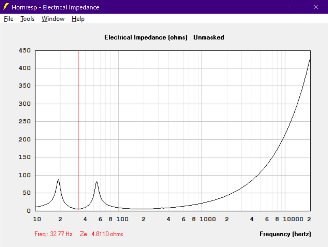

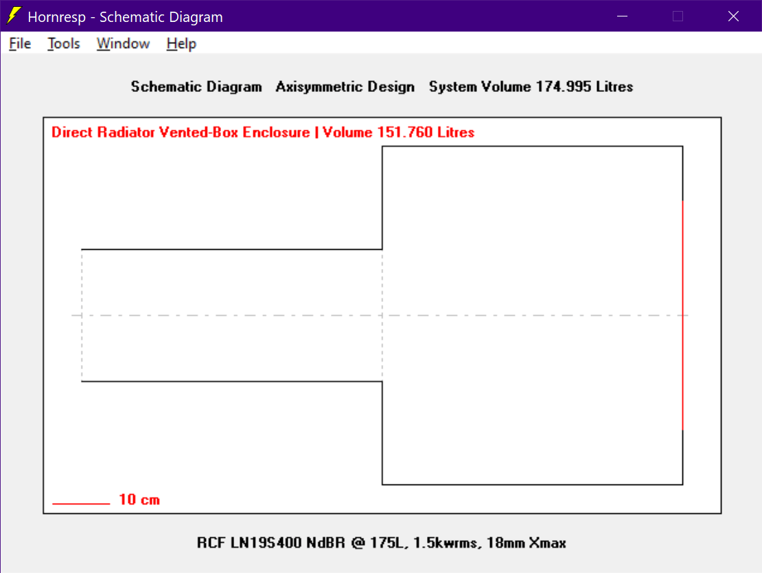

Anyone planning on using these in their project? I wonder if one can push these into smaller volumes (150l for 19"). These need excursion to not burn...

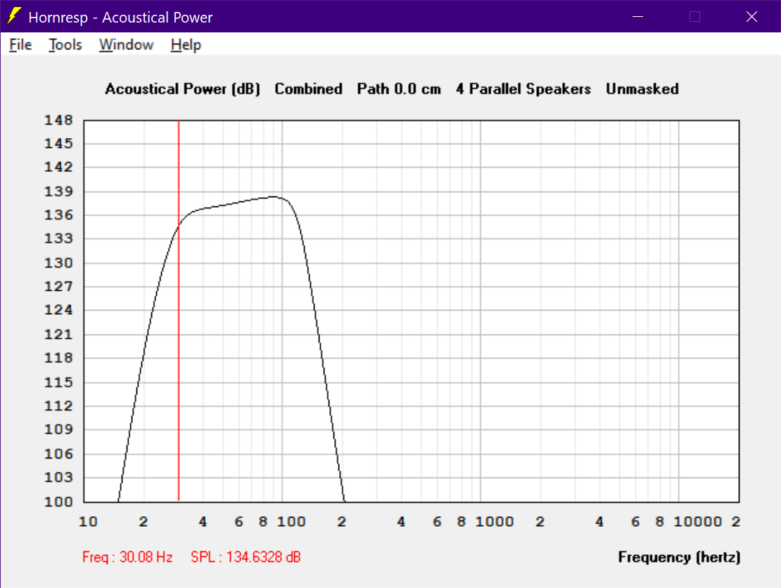

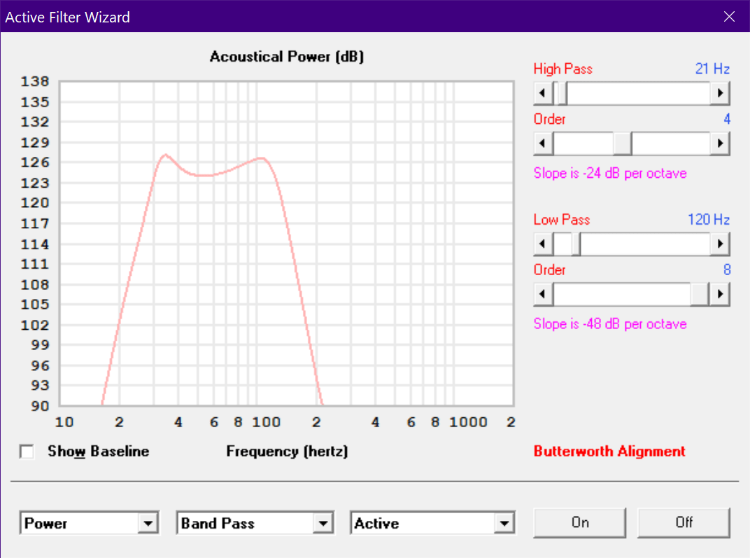

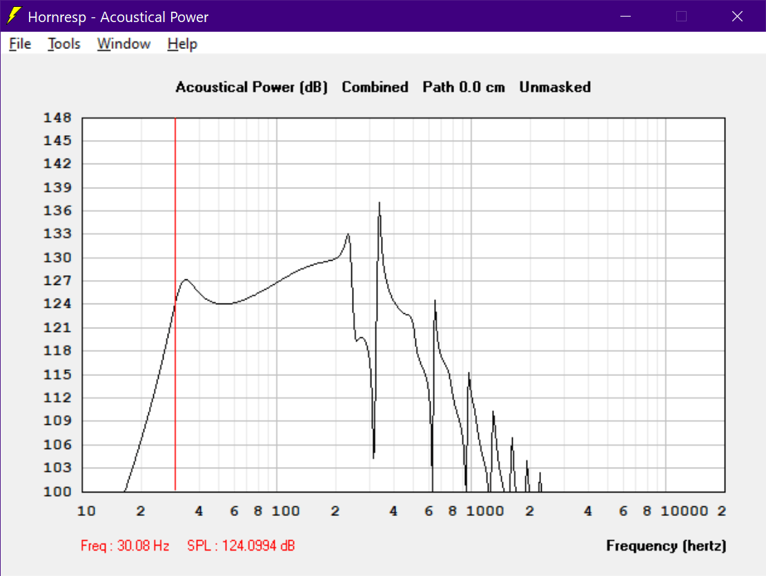

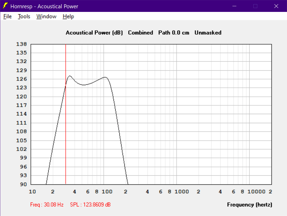

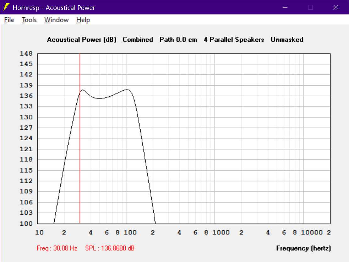

All are interesting. Either for cinema purposes with low tuning, or for increasing SPL density. With these you can afford to tune them between 25-30Hz, cut em at 28-35Hz, let em work around their impedance peak efficiently, and have quite power dense compact solution. The port will only be there for impedance shaping, cooling and cone excursion settings, so it can be nearly half the size of conventionally sized port.
Small port, 100-150l internal box volume depending on the model and needs, and you have nice efficient compact beasts. Older models simply are not capable of that. I think this is a good path if SPL density and compactness is important for you.
You can feed em with 2500-3000Watt amp, because the power will not go there anyways.

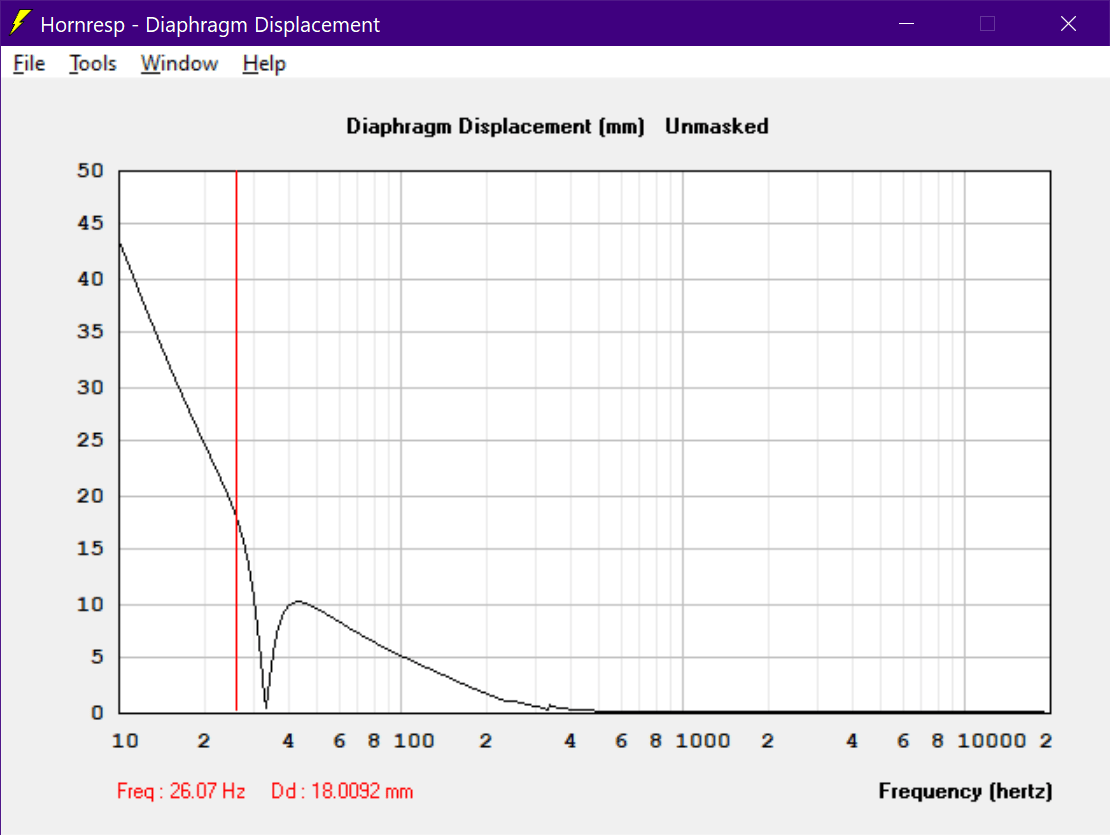

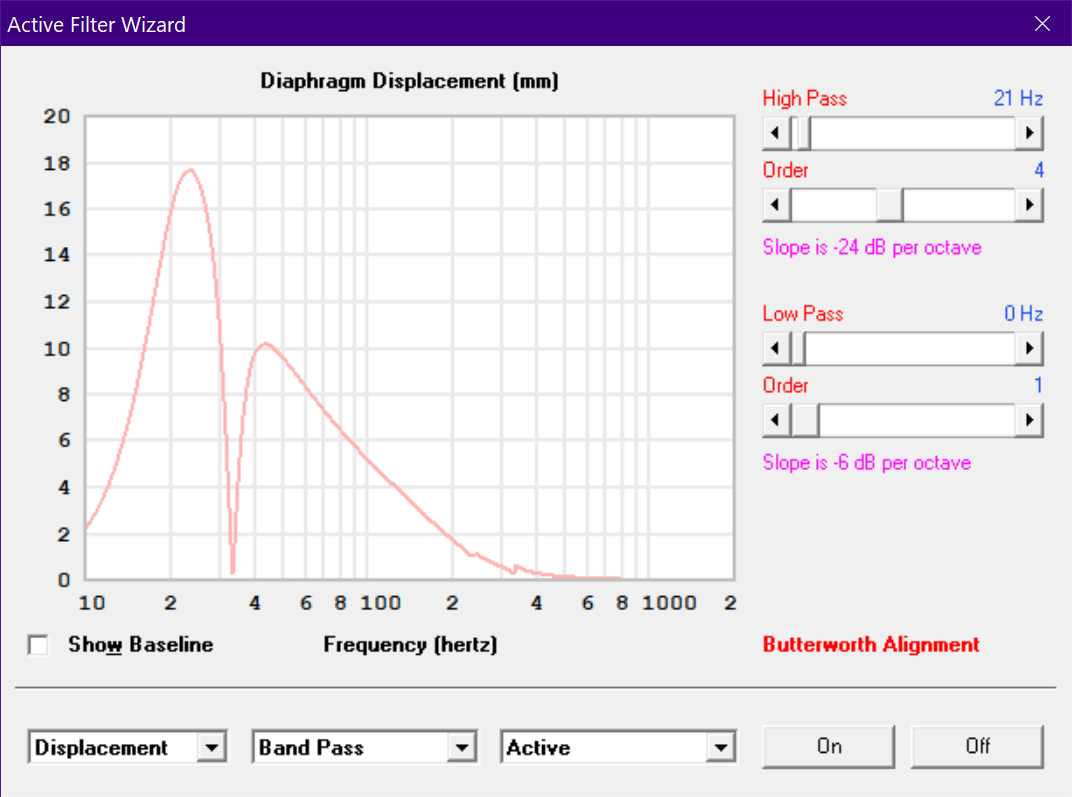

I am not saying it is wrong, but for this driver, excursion of 10mm above tuning frequency is not that desirable. The coil needs to fly and to cool down. Otherwise magic smoke could appear. I did it to my 21DS115s, although it only started to smell. The driver srsly can do it all, without the need of a port. The port doesn't add much efficiency anyways. 150l as I see in the input data is doable with such driver, but indeed, should in ballpark of fair minimum. Bigger volume might help with excursions too.
That´s a good question to ask.
There is no such specification, but historically and logically, there is best heat transfer from the coil to the air and pole piece when these swing around each other fully. Outside of that space, there might be less air flow or even pressure. Might...
Anyways, as the coil is 42mm long and the pole piece is 16mm high, it means that in order for the edge of the coil to travel around the pole piece, you need 13-14mm of swing for coil edges to cool down best on this speaker. Otherwise it might burn its edges sooner than "expected".
Undertuning solves this issue, and adds more positive consequences:
1) At the tuning frequency where there is least coil movement and therefore poorest cooling, there is not as much musicall content as there is let´s say at 35-40Hz. So less strain in the worst region for the speaker already.
2) Undertuning causes that in the spectrum of usable content, you have higher impedance. You are working more around the impedance peak compared to working more in the impedance valley of the port tuning, meaning that less power goes to the speaker. Less heat generated again.
I found it briliant for compact design SPL dense box. The caveat was that older drivers with Xmax around 10-12mm could not do that yet. RCF with nearly 20mm CAN.
