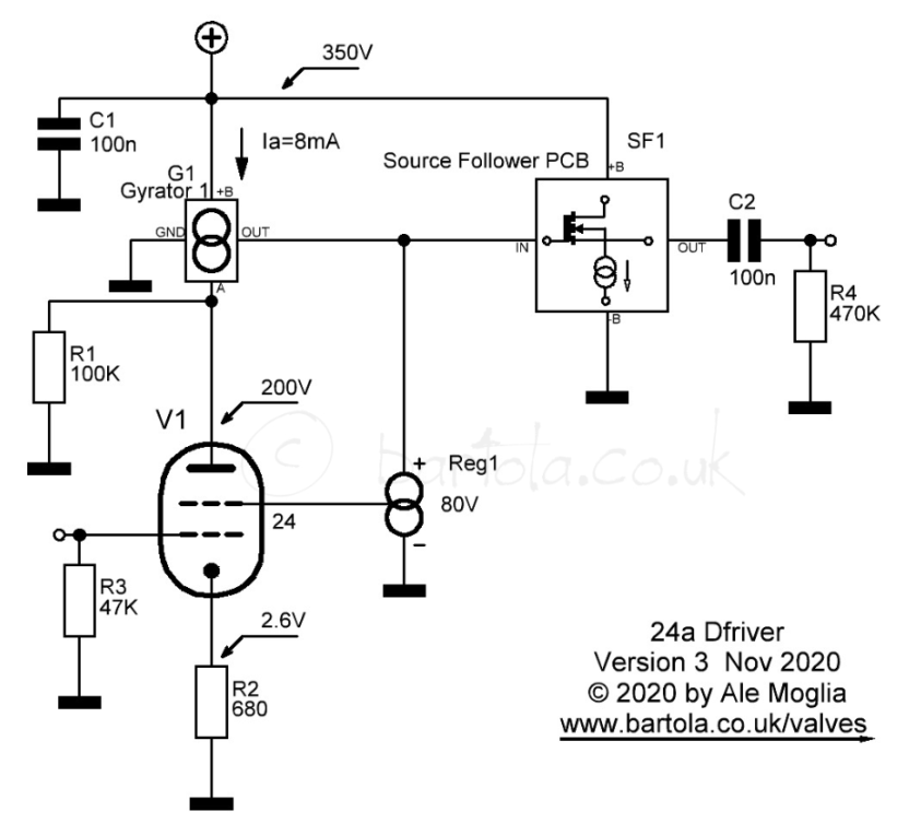

I had some time today and did some looking. It turns out that a builder that I respect greatly, Bartola Valves, has used the 24a tetrode to use as a driver stage. He put up three or four posts regarding it. https://www.bartola.co.uk/valves/tag/24a-tube/
The 24a is very similar to the 36, although the 36 looks a little better to me and uses 6.3V heaters. Ale says that his driver sounded quite good. I guess that the 36 might just be a good idea. Check out his website and have a look at his schematic.
Actually, I noticed that the Bartola design doesn't use a grid stopper at all. So I probably can. I used the equation Rg=1÷[2×PI×fc×Cgk].
I used 1Mhz for the cutoff frequency and 3.7pF for Cgk. That is 43K. Is that wrong? It could be but I thought it was that equation??
In fact, it seems that the 24a and 36 tubes are nearly identical save the heaters. You can basically say the 36 is a 24a with 6.3 volt heaters. I bet you could drop it into Bartola's circuit, as is.

I do not have experience with a tetrode as a driver. The pentodes I used as drivers (EF6 and EF86) were connected as triodes.
