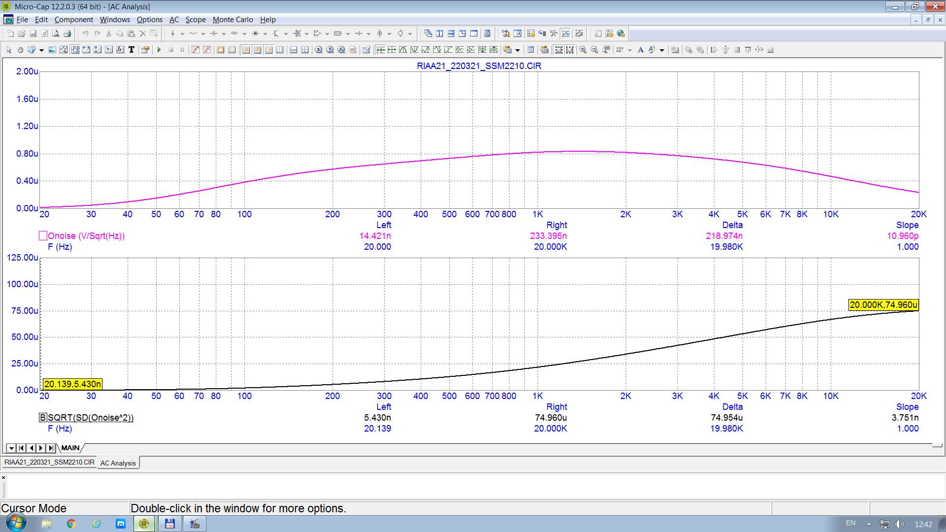

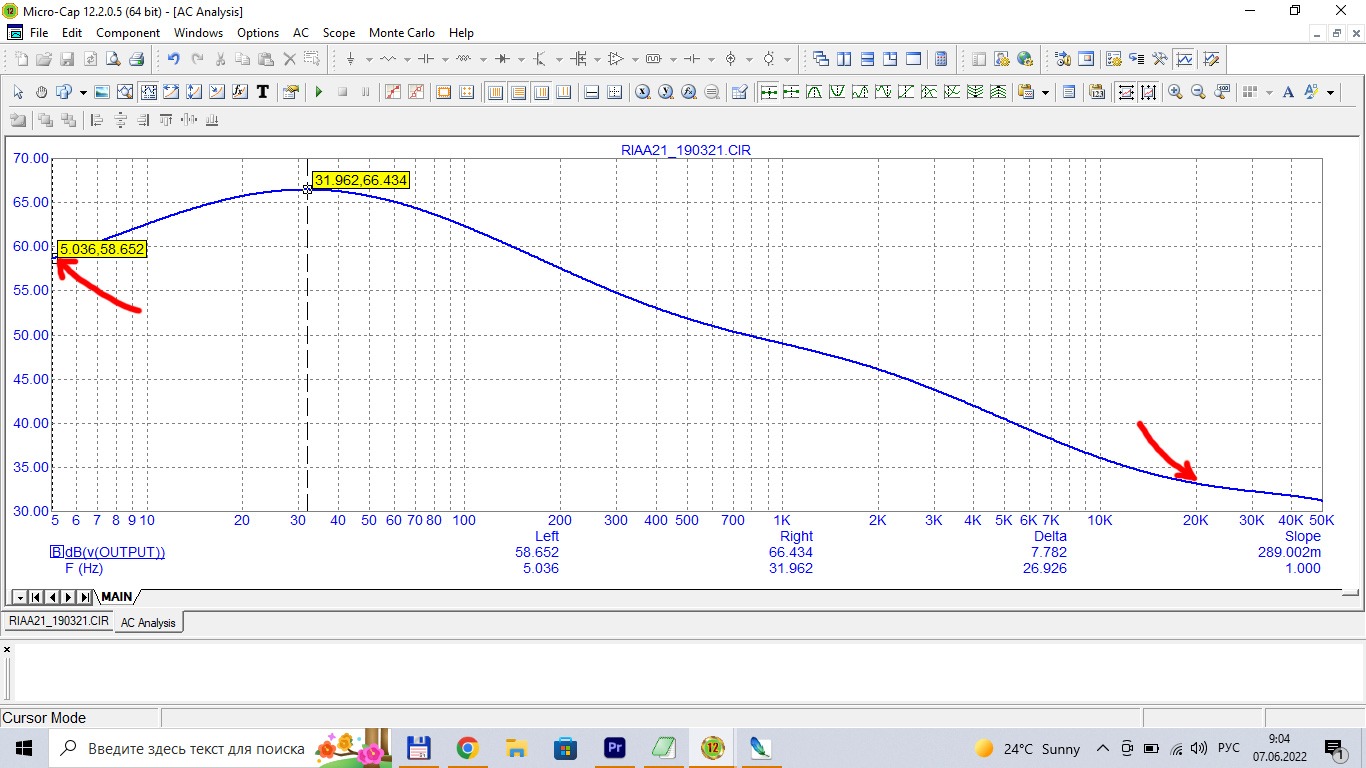

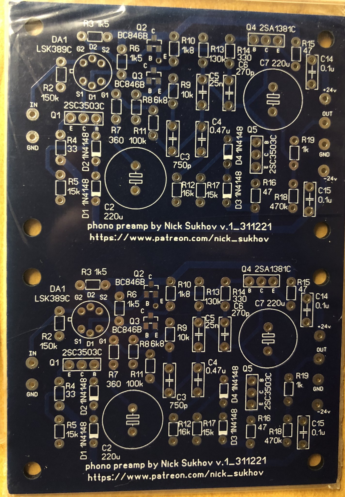

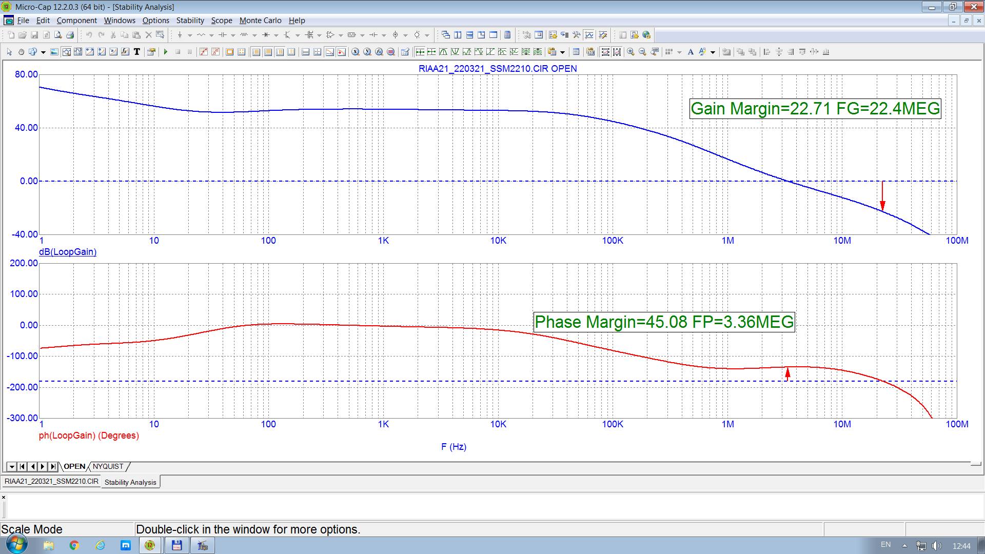

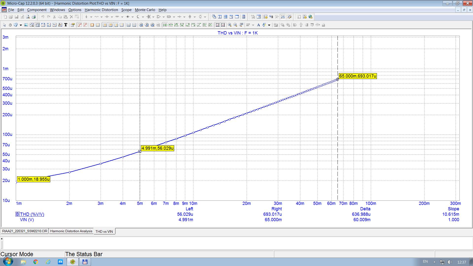

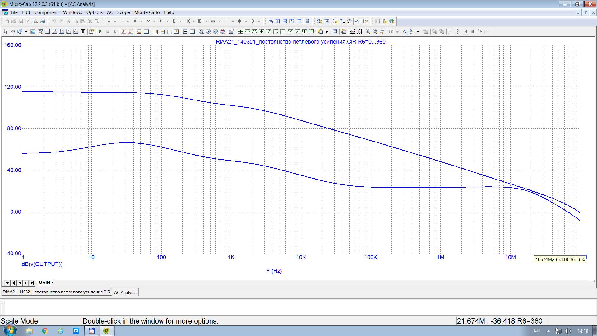

I would like to show you nice solution for MM cartridges from Nick Sukhov. He is a legendary audio circuit designer based in Kyiv, Ukraine.
MM Phono stage-XXI (Su-XXI) by Nikolai Sukhov, thanks to the "aperiodic" HF correction invented by him back in 1980 [first described in the article "High-quality preamplifier-corrector" in the USSR Radio magazine No. 3/1981 pp. 37-40, which became “The best publication of the year” in 1981] allows you to get rid of the input circuit resonance "MM head inductance + cable and phono stage input capacitance", due to which, above the resonance frequency (usually in the region of 14 ... 16 kHz), a frequency response decay is formed with a significant slope of 12 dB / octave ( like a second-order low pass filter). With aperiodic correction, such a drop is eliminated and the sound of $50 MM cartridges becomes as transparent and detailed as that of top MC k$ cartridges. Similar circuit solutions appeared 20-30 years later among high-end Phono preamps under the names "Neumann pole", "Damped EQ", "Enhanced RIAA - eRIAA", "Phædrus Phlux active phono cartridge". Thanks to the original "passive cooling" solution with 150 kOhm input resistor instead of 47, the Su-XXI provides an unprecedentedly low noise level of -85 dBA in full compliance with the standard input level of 5 mV @ 1 kHz (and not the "maximum input" - a typical marketing trick) and with an equivalent input MM-source 500 mH / 1 kOhm connected (and not the "shorted input" - another trick of the steamers). Finally, thanks to the use of a high-output impedance voltage amplifier stage with a load Z(f) in the form of an RIAA-chain (overall gain 1+Z(f)/R, voltage amp open collector stage gain is also proportional to Z(f)+R, so loop gain is almost constant across the entire audio band), a "passive-active" frequency-correcting circuit is formed with an almost unchanged feedback depth from 10 Hz to 50 kHz (55 dB constant loop gain). This design of the deep RIAA freq response correction of 40 dB eliminates the “diseases” of both excessive gain at high frequencies and insufficient gain at low frequencies, which provides both a high stability gain margin (22 dB) and a uniquely low THD of 0.00006% at a nominal input voltage of 5 mV @ 1kHz and 0.0006% at +20dB overdrive.

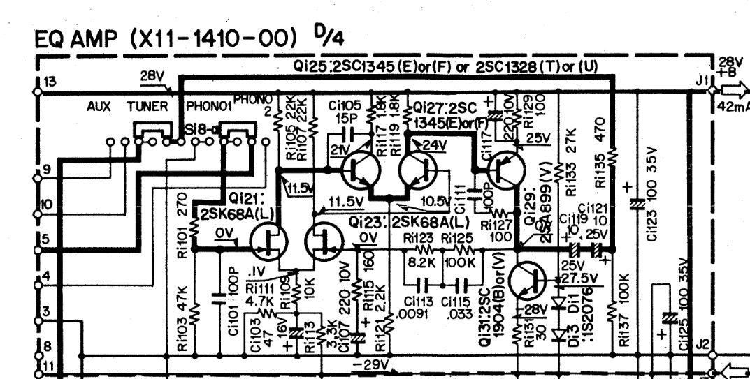

With the exception of a current source, a bypass cap on the common emitter stage, some tiny details relating to phase correction and the addition of Neumann's pole it is a copy of the Kenwood topology.
The large input resistor coupled to low input capacitance does indeed push the MM electrical resonance beyond audibility but only if the tonearm wiring adds no extra capacitance. Mounting this phono stage inside a turntable will work, but how realistic is this in practice?
