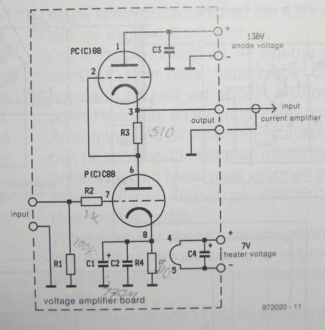

Tube MOSFET Elektor Hybrid 1997
Okay,
it was 1997 this Tube MOSFET Elektor Hybrid was published.
What semiconductors are used?
Tube:
PCC88
Voltage supply = 138 VDC
Heater: 7 Volt, or better one 300 mA constant current
MOSFET, complementary output:
2SK176 + 2SJ56
at 100 mA idle current = Class AB
and 2 x 42 VDC supply
Data:
65 Watt RMS into 4 Ohm
-1.7 dB at 100 kHz
___________________________
Comment from article:
Also 2SK175 + 2SJ55 can be used.
If lowering supply voltage ( 2 x 30 VDC )
it is said, that you can use IRF HEXFET:
IRF530 + IRF9530 or IRF540 + IRF9540
at about max 50 Watt output.
Attached is the very few parts Tube Circuit
The electrolytic capacitor C1 is 470 uF.

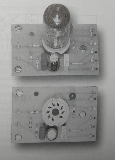

lineup said:
Here is attached how the Tube PCB looks.
At a real photo!
See Circuit in previous post.
