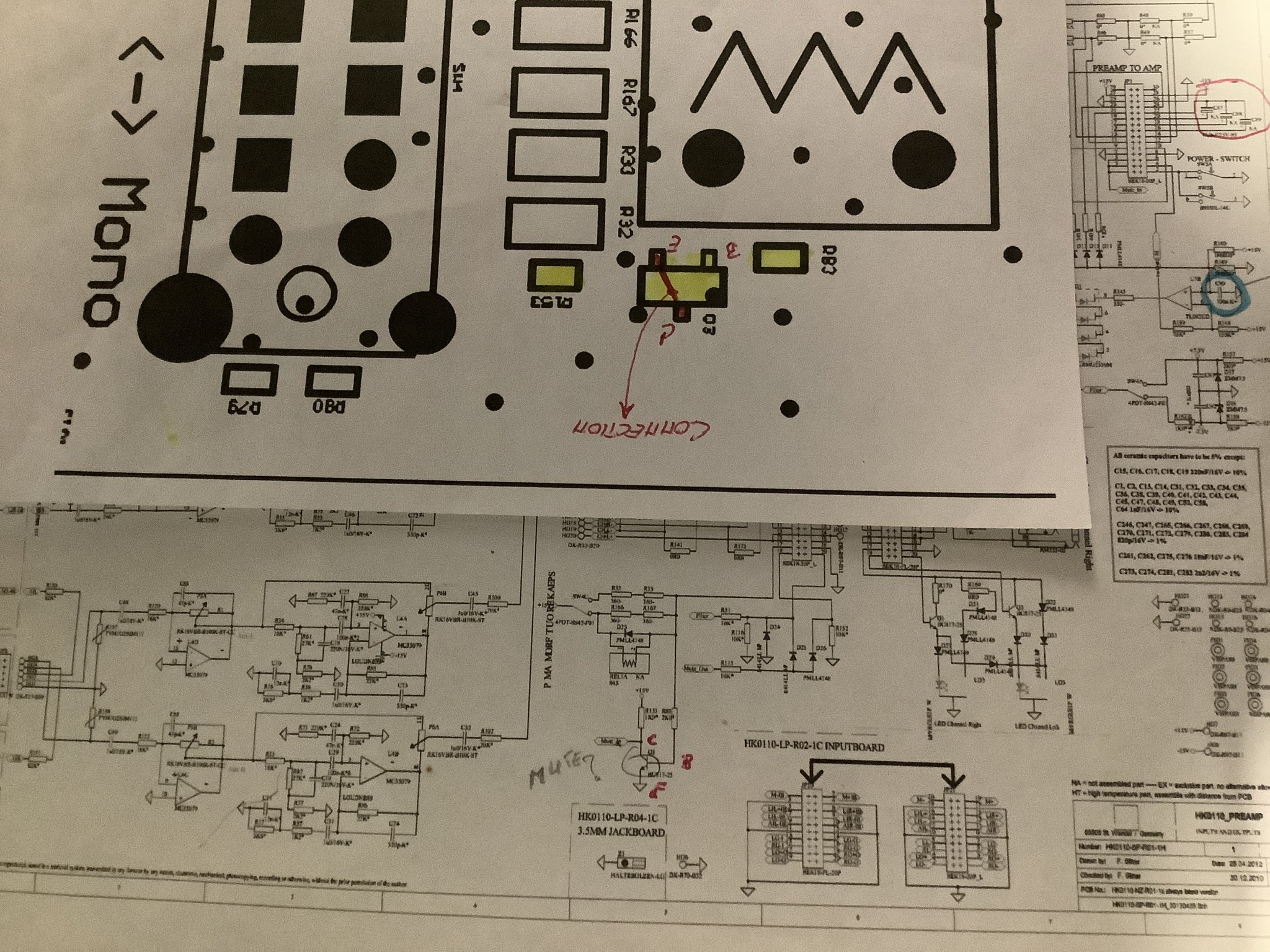

Hi all,
a friend of mine has the same problems as described by Andy D.
Luckily I have a same set in working condition.
What I did so far, is that I unscrewed both sets and exchanged the power amps with the other set.
Found out that my set was still functioning and my friends set still malfunctioning.
That tells me that the failure is not in the power amp. So It should be in the pre-amp ( the board behind the knobs)
At this moment I am investigating the schematic from Kevin.
Keep you informed as soon as I know more!

What I did so far: I checked if I could put the signal low, so that the mute would not work. I shorted the C and E connection of the transistor BC 817. ( Q3) However, the problem remains the same….
It could be one of the C’s that is shorting after a (random) while? Investigation required. ……
