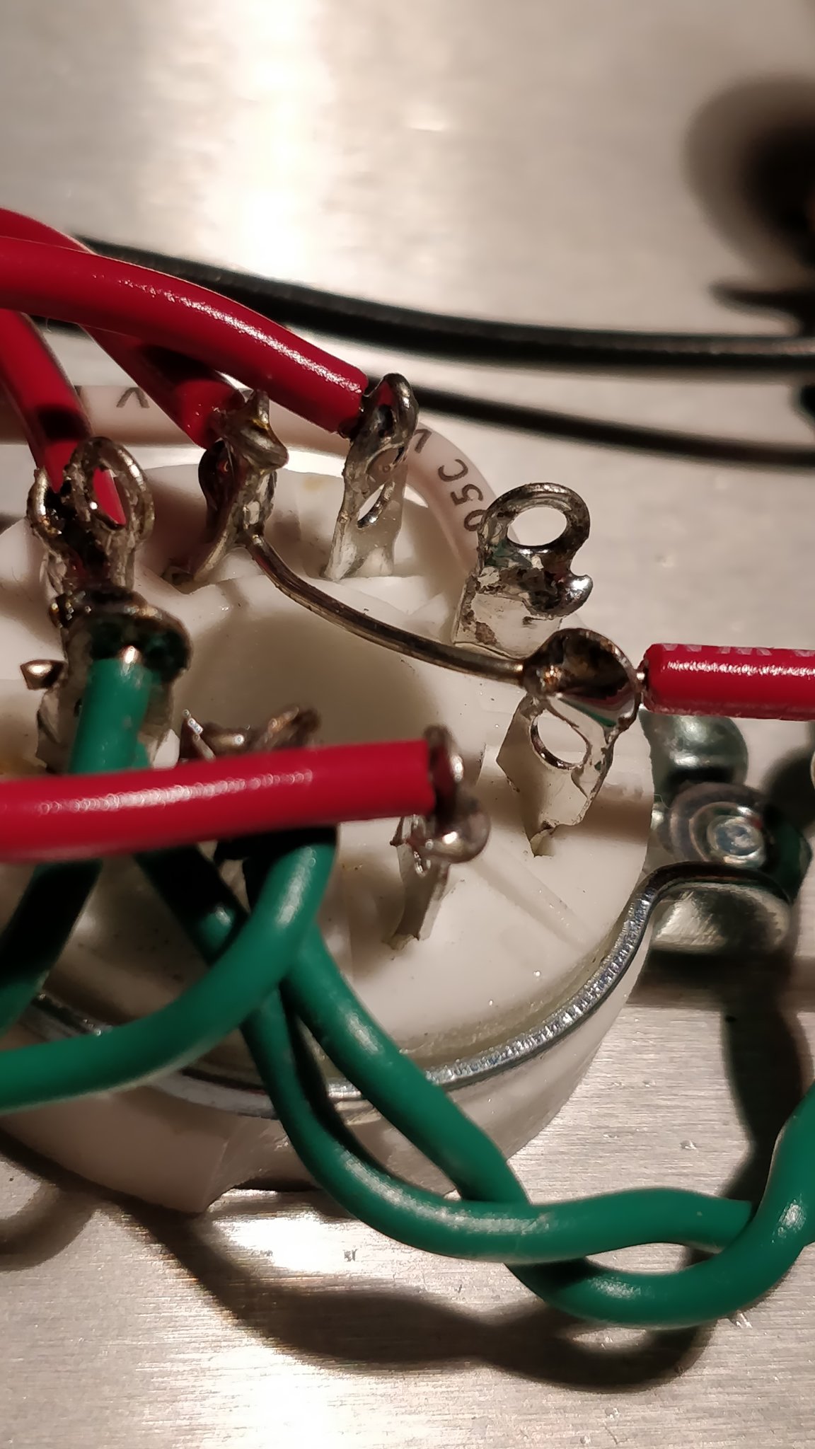

sounds like flux arcing on a solder joint.
But looking at your pictures, this one is not correct.
The resistor lead should wrap around the tube pin before being tied to the next pin. The first joint is "fluxy" while the other joint is "lack of solder sweat" from not letting the solder melt and bond.

I do not believe the cold solder joint is the root cause of your problem. That being said, you could do a slightly better job with soldering.
It is either a faulty valve, a bad valve socket, or a sound coupling capacitor (or other capacitor... like power supply rails' decoupling) issue.
Sometimes the transformers start to be winding-to-winding layer conductive, due to high voltage / slight mechanical bump... that damages the lacquer finish. This kind of issue manifests itself once the transformer heats up.
You said you replaced valves and wiggled the sockets... I'd look at the sockets very closely. The valve pins need to be completely clean; each valve socket needs to grab the valve pin tight.

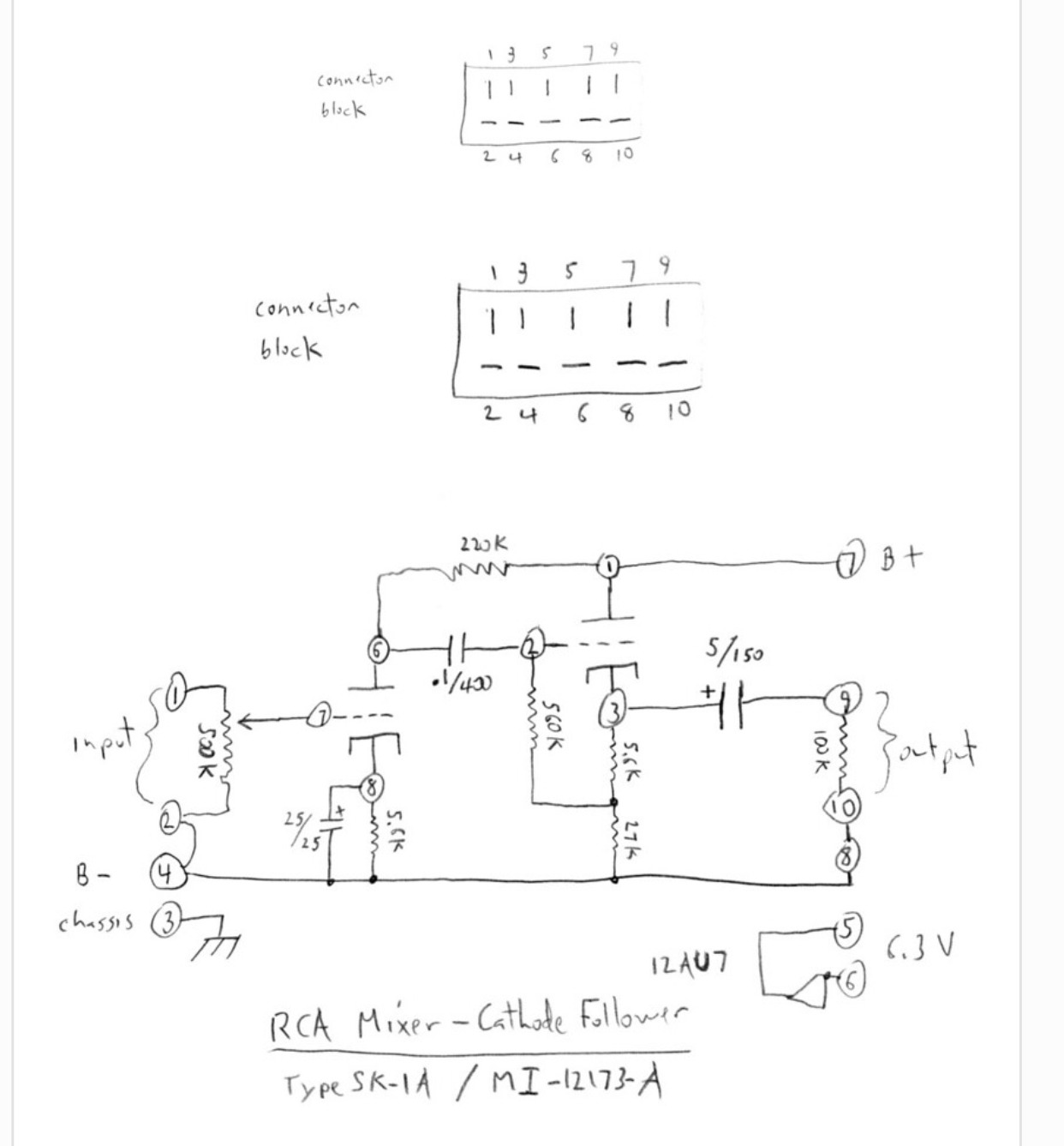

I'm not sure I would be allowed to share the circuit scheme that's in the manual, but if you google search it you can find this, which looks to be the same. If I'm not mistaken the "Channel one" sketch should be the right channel, which is the one that's giving me issues.

But as far as that circuit:
That is a variant of a Rainbow module from a 1950s mixer.Headphone or buss out. A lot of people have done it over the years. Its obvious that they would be into selling "upgrade options" because its not really complete or finely engineered.
This is a MI-12173-A. The only difference is using one section of a 6as7 as the cathode follower.

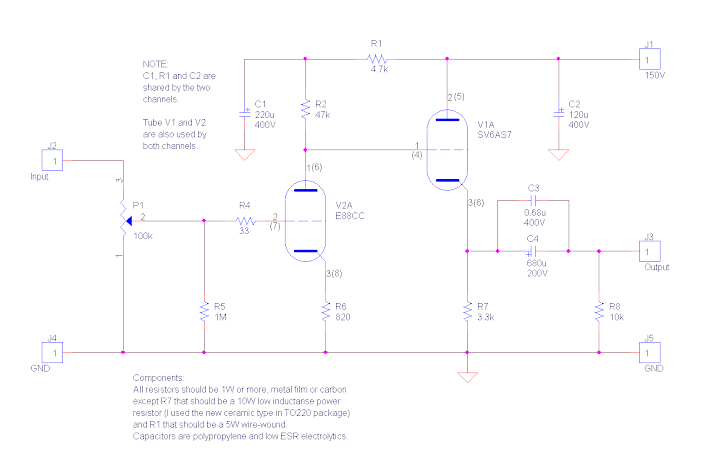

The bottom one is the most correct. There should be a 1M from wiper to gnd to prevent pot noise. Since the tube otherwise relies on the pot for bias, any time the wipe gets interrupted, the bias would go haywire on that tube. The grid stop is somewhat absent, but it has to be sized correctly depending on the input in the device before this is dc coupled. That is why some people have success, others would have issues with this circuit because its not quite universal and capacitor coupled from the previous stage would be the only one that wouldn't upset the operation of the circuit. The bottom circuit runs the tube plate at a little bit more reasonable voltage, and the 33 ohm gridstop would be the minimum that it would need to stabilize with a 8200 ohm resistor on the cathode.

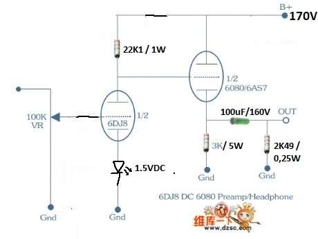

The crackhead uses LEDs there, which would force a constant bias state, but this would cause extra sensitivity on the grid. To find the right size of gridstop, you would take a 1M potentiometer and wire it as a variable resistor and inset it at the first tube where the 33 ohm resistor is in the bottom schematic.Connect the source, and adjust for the best noise floor. If you don't drop the plate voltage on the 1st tube to about 50% of the 6AS7, a 470 ohm grid stop should be used.
When selecting gridstops and cathode resistors, you should use ones that offeres no to low insertion loss, and low thermal ppm to keep the hiss down to a minimum. I use Mills/Dale/Vishay resistors. Which I would do Mills mra5 on cathodes and the grid stops
of course, what you see out there when you search

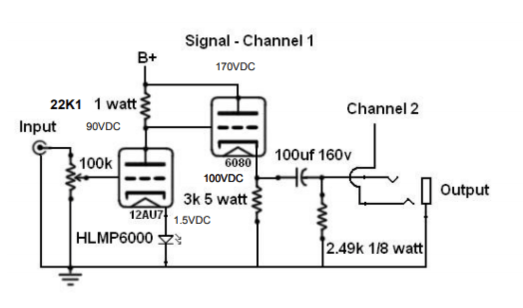

These kind of noise issues can drive you crazy. I know all too well from experience. But the advantage you have is that this is a very simple circuit and you have already ruled out the tubes themselves as the problem. And it occurs only in one channel. That rules out the power supply.
I don't own a Crack, but if this is the signal circuit for one channel
then the problem has to be one or more connections above on the right channel side. The fact that the problem originally responded to wiggling the 6080 tube suggests the problem might well be a questionable solder connection somewhere in its vicinity--not necessarily soldered to the octal socket but a connection down or upstream from it. That the noise is now constant suggests that what once was a questionable solder connection has become an outright bad connection.
The chopstick test ought to work. Have you probed with a chopstick each and every one of the connections in the above schematic? Any of those connections could be the culprit. Be careful with the solder joints that connect the LED because its leads are very fragile.
The last resort would be to desolder and remove all the components on the right channel side of the signal chain, remove the leftover solder on the terminals and socket pins (a vacuum pump device would be easiest for this), and carefully reinstall everything, doing your utmost best with each solder connection. I'd recommend buying a replacement HLMP600 since reusing a fragile LED can be dicey. They're cheap; you'll spend more on shipping than on the LED itself. You might also buy a new 100K potentiometer. It's possible you've got bad contact in the wiper of the pot you got with the kit. Make sure you get an audio taper pot, not a linear one. They're inexpensive as well. Bottlehead usually provides Alpha pots in their kits. They're OK quality, but I'd spend a few dollars more and get a CTS or Bourns pot.
