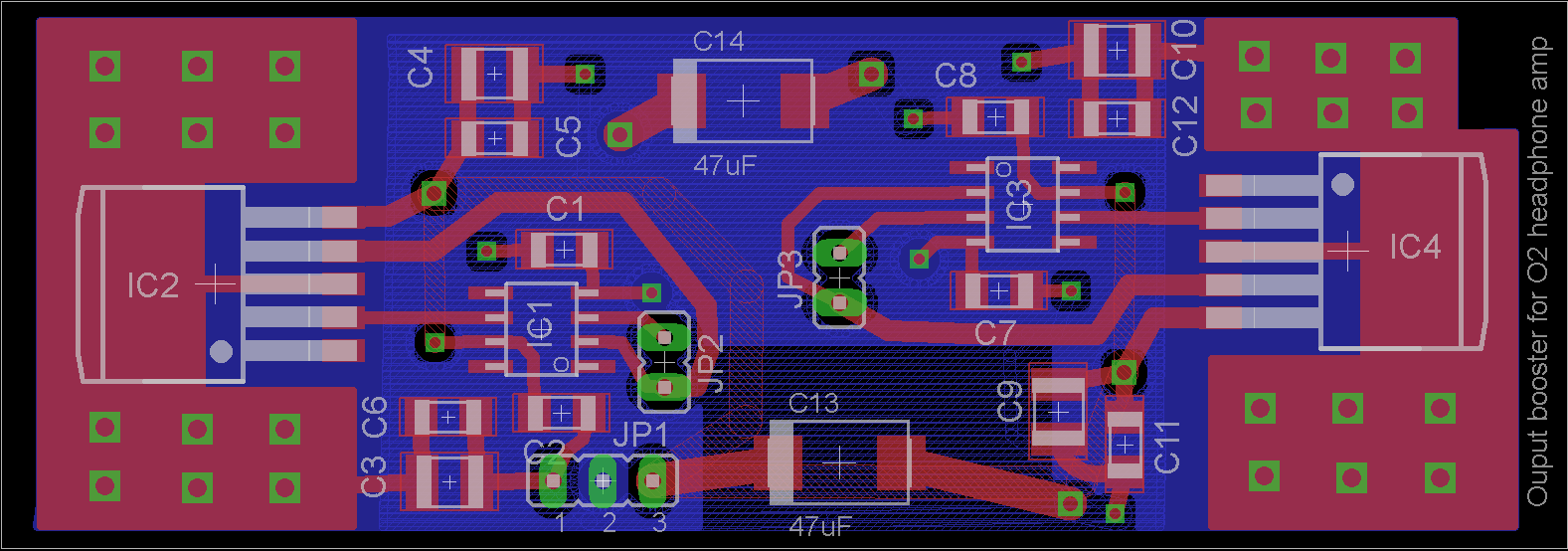

V3.5 changes
I corrected a bug in the older versions that caused the DC output offset to go up to O2 "regular" O2 headphone amp levels, around 3mV, when the volume pot was turned all the way down. The bug shouldn't have caused any audible problems for anyone since it only happened with the volume control rotated to the very extreme low position - no sound coming out. Now with V3.5 and above the DC output offset is the same ultra low 20uV even with the volume control down.
I moved the 1 meg ohm resistor that has previously been soldered in series with the sense wire that solders to the O2 board onto the Booster Board. The type of SMD diode for the relay was changed to 1A from the previous 3A, which was excessive. Placeholder pads (zero ohm resistors currently) have been added in series with the inputs to the LME49600, in case some other type of op-amps (other than the OPA827 or OPA140) require them. The RC power rail filters in series with the OPA827 power leads have their BOM values lowered from 100R to 1R. The previous value was set to coincide with the chip's datasheet PSRR drop. The new value sets the corner frequency at 72KHz, above the audio range.
The direction of the connection pins has been reversed from previous version in the build instructions, with the black plastic bar now up towards the Booster Board. The connection pins work fine either way, but one person using non-BOM IC sockets in their O2 had found that the pins fit best with the bar side up. I've also added wording in the build instructions to make sure the connection pins are centered top to bottom in the IC sockets if using the non-collet socket option in the O2 BOM, when soldering up the pins. The non-collet sockets have wide flat sockets for the IC pins which can allow 0.5mm or more of front to back placement. If the connection pins are not centered in the U3 and U4 sockets when soldering them they work perfectly fine, but one or both sets of will be at something like a slight 5 degree angle front-to-back.
The front panel green LEDs and their series resistors are now listed as "optional" in the BOM since most people have chosen not to install those. They have no circuit function other than just quick indicators to show the O2's power rails are OK (one LED on each power rail). They require two new small holes be drilled in the O2 front panel to see them, although the panel will clear just fine even without holes. Plus they cause a tiny amount of additional battery drain. There is a CAD file for a new O2 front panel with the LED holes at the Google Drive link above.
V3.5 was fabricated at a board house that allows the extra 2mm of board length needed to get all the connection pins onto the board, for the same price. Previous versions had the bottom two connection pins of U4 sticking out past the board (unused anyway) since the prior board house only allowed 50mm without a big price increase.
V3.6 changes
The left and right sides of the "tab" section are moved slightly, both 1mm to the left. This gives a little more room if a person has used non-BOM filter capacitors in their O2 which are slightly bigger diameter (one fellow ran into this with his Booster). Rectangular silk screen outlines have been added around the connection pin holes on the bottom of the board as a reminder to use the plastic-bar end of the pins up toward the Booster.
Placeholder pads added (currently un-populated) for bandwidth-adjust resistors for the LME49600 chips. The LME49600s are normally run in low-bandwidth mode (110MHz) since it is adequate for the OPA827 (or OPA140), pulls less idle current and produces less heat. But if someone has a situation where their specific headphones cause oscillation (very rare) the 100R bandwidth resistors can be added to bump the LME49600 up to high-bandwith 180MHz mode, for increased phase margin.

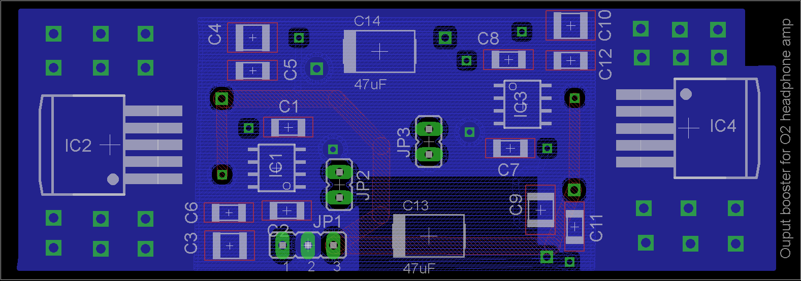

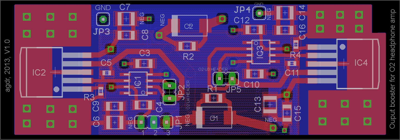

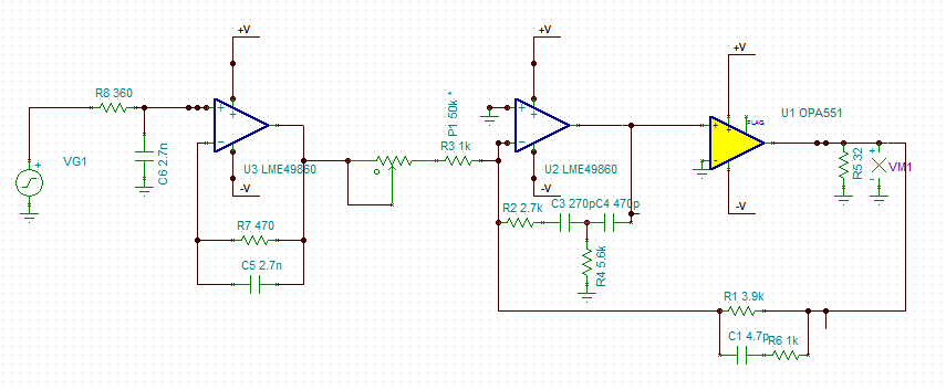

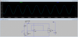

Sergey888 - I had an idea today for your OPA551 + linearization chip 2nd order circuit.

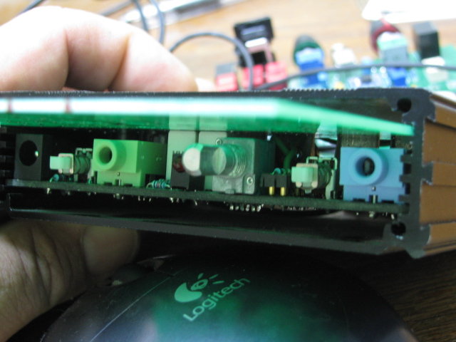

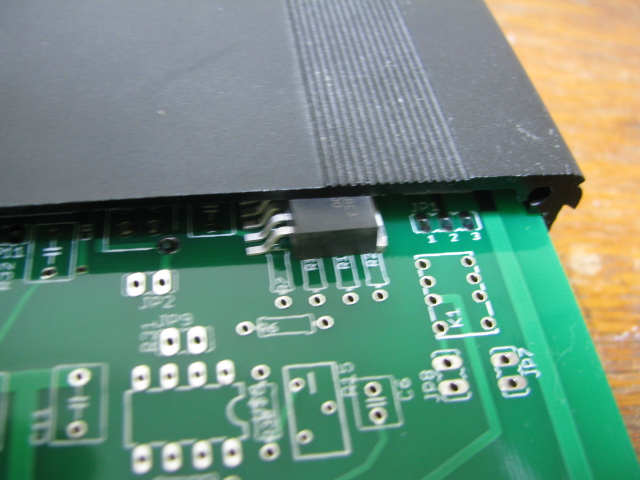

Turns out there is a open strip of space in RocketScientist / NwAvGuy's standard O2 headphone amp above all the front components that is 28mm deep and the 80mm case width. A circuit board slid into the top slot there clears all the components and mounts perfectly between the battery connectors in the rear and the front panel. The is 5.5mm of free space from the top of the PCB surface, inserted into that top slot, and the top of the standard B2-080 case.
So here is your OPA551 circuit + linearization op amp layed out on a board that fits that space in the O2. I've left the area above the noisy AC input parts blank. The board connects to the O2 by using twisted pair wires going to DIP8 headers that plug into the IC sockets where the NJM4556A chips go. In other words, just pull out the two NJM4556A chips from the sockets, plug in the two headers like this one (Mouser #535-08-600-21)
08-600-21 Aries Electronics | Mouser
slip the board into the O2 B2-080 stop slot and away it goes! Well almost. One twisted pair of wires go to one NJM4556A socket header plug (input/output, signals in phase), 4 to the other (V+, V-, input/output signals in phase) but then one additional wire has to be soldered to a ground point such as the middle hole of the output jack connector. There is no ground present in the NJM4556A chip holes.
A few potential benefits of the OPA551 output chips vs. the NJM4556A chips:
* Potentially lower distortion given the loop with the LME49990 chip. I substituted the LME49990 for the LME49860 since no voltage higher than +/-15Vdc rails is needed anymore and the 49990 specs beat the LME49720/49860 slightly.
* One single OPA551 vs. the two paralleled sections of the NJM4556A on each channel. No paralleled outputs anymore. The 1R output resistors are no longer needed, no output resistors at all in fact, unless I run into reactive load oscillation issues during testing.
* Higher output voltage capability by 3Vdc peak! The 12Vdc voltage regulators in the O2 can be replaced with 15Vdc regulators (LM7815 / LM7915) and with a 16Vac or 18Vac input you now have +/-15Vdc rails. Looking through the voltage specs of RocketScientist's capacitors I think that I only saw one that has to be bumped up to a higher voltage. The LME49990 is not only specified at +/15Vdc, it is specified at 18Vdc. The OPA551 is good with either rail voltage too, of course. The existing +/-12Vdc regulators in the O2 can still be used too, of course. No requirement to go with a higher rail voltage.
* More power dissipation. I pitched RocketScientist once on bumping up the rail voltages to +/-15Vdc. He correctly noted that would push the NJM4556A's over their maximum power dissipation under some circumstances. No such problem with the DPAK OPA551's.

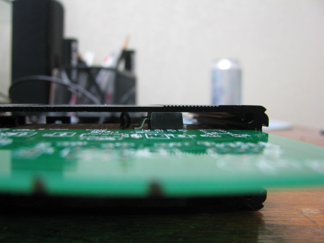

* It all fits, I think. The OPA551 is apparently 4.5mm thick and there is 5.5mm of free space above the board. We'll see what happens when it is soldered down with the solder film thickness. I've used 1206 surface mount for everything else.
* Short circuit protection form the TRS is maintained with the (short circuit protected) OPA551.
* Potentially higher current output. The OPA551's are good for 200mA each vs. about 120mA for the paralled NJM4556As, but I'll have to do some power dissipation calculations on the heatsink foil area and on the un-heatsinked regulators in the O2.
* Still battery power friendly for portable use! The quiescent current draw of the OPA551 at 8mA is about the same as the 9mA of the NJM4556A's they replace on each channel, a wash. So the added current draw from the batteries are just the LME49990's on each channel at 8mA each.
* Noise, or lack of it, may be about the same. 14nV/sqrt(Hz) for the OPA551 vs. the RMS sum of 10nV/sqrt(Hz) for the two parallel sections of the NJM4556A, which happens to also equal 14nV/Hz. The distribution over the higher frequencies is not the same though and the tiny 0.9nV/sqrt(Hz) of the LME49990 is added plus some additional resistor Johnson noise.
A lot more layout work to do, plus I need to add the bypassing. But it looks like it all may fit.

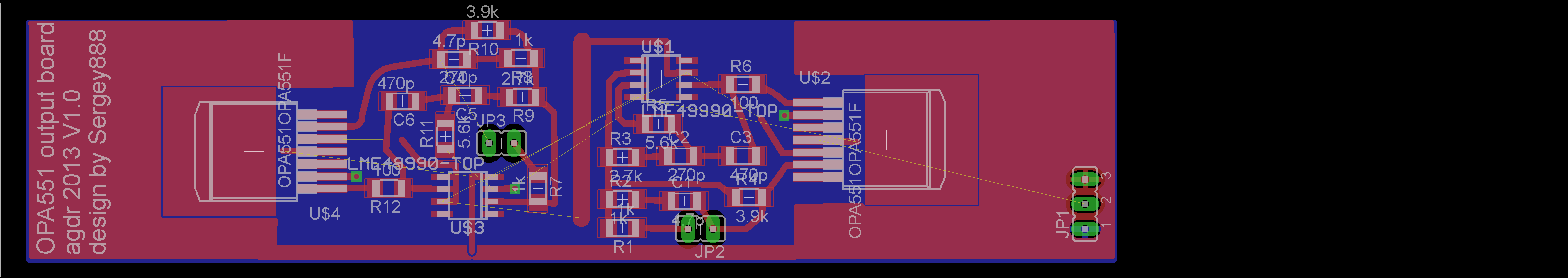

Hi agdr
I've got a few thoughts
Because OPA551 will be inside a feedback loop of the other amplifier, equivalent input noise will be defined mostly by the front end amplifier input voltage noise, input current noise and a feedback divider.
So with lm4562/LME49710(20) you may get something like 9nV/sqrt(Hz).
There are few reasons why you may not want to use LME49990.
First of all it has higher the input current noise. Multiplied by impedance of the feedback divider it is going to be higher than input voltage noise of LM4562.
It has higher power consumption.
It does not have dual version.
Distortion performance improvement may be absent at all, or will be marginal because amount of negative feedback around the output stage is going to be the same.
You may also have a look on some lower power devices,like LME49725, OPA2209 etc. but this will need some components recalculation.

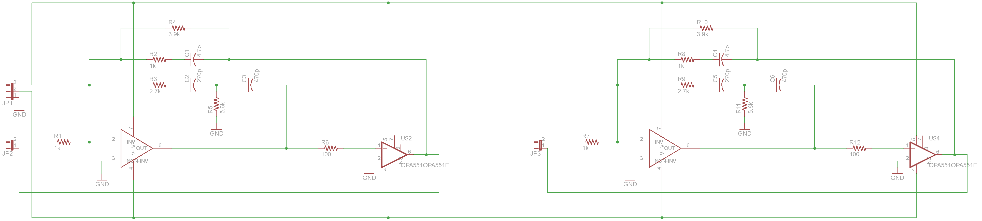

sgrossklass - you are quite right! That one hit me this afternoon. I was still partially thinking about the "ODA" amp in this thread where I'm using a 1K control vs. the 10K in the O2. Even then a 1K load would be too much and affect the taper curve. So either an input buffer is needed or a non-inverting design.
Sergey888 - good thoughts! I had missed that higher input current noise figure on the LME49990, It would be nice to get the chip count down. OK, how about a quad LME49740, SOIC-14 SMD version, using the extra two amps as unity gain input buffers to drive the 1K inputs? The chip is unity gain stable. I wonder if the input buffer arrangement would result in lower harmonics than going with a non-inverting design.
There is one more issue that hit me today. The gain is still set up for 2X from the discussions on using the circuit with the ODA here. In the O2 1x gain is all that is really needed for that output stage, although I can change the input resistor value on the O2 to make a 1:4 attenuator if needed. I have to do that anyway, a 50/50 attenuator, since even 1x through the O2 is too much for some of my sources.
You'll get the same common mode voltage in buffer or in amplifier itself. There is a potential field for improvement, but it could be a bit awkward to implement. LM4562, which is the same as LME49710/20/40 will have low distortion in non-inveting configuration when input impedances are match or kept as low as possible. If you put a unity gain buffer right at the front, before pot, you sort of satisfy this condition. From other hand it bed because in this case the buffer will always have full voltage swing on its input and output.The chip is unity gain stable. I wonder if the input buffer arrangement would result in lower harmonics than going with a non-inverting design.
Do not afraid to load this opamp. It has sub ppm distortion driving 2Vrms @ 1kHz to 200 Ohm load.
Do not exactly follow, but you can easily change gain adjusting R1 R7 from you latest schematic without necessity of compensation recalculation.

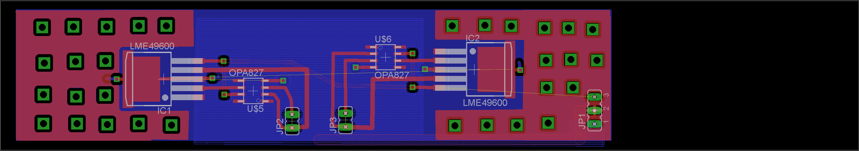

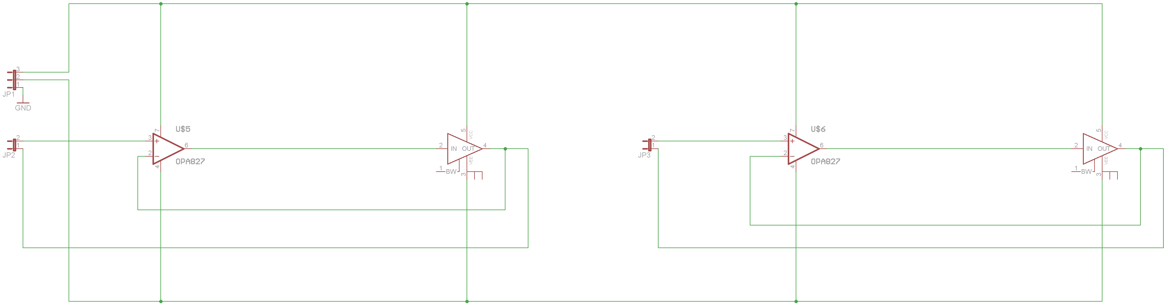

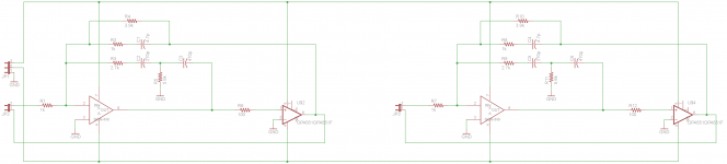

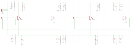

O2 amp output PCB with OPA827 + LME49600

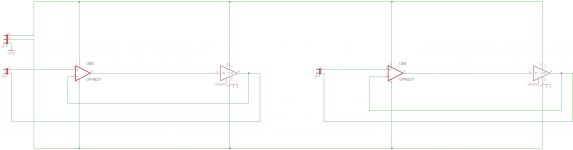

Pondering it a bit today I think that adding two more amps for input buffers would result in to high of a chipcount and quiescent current draw for the overall goal. I went back to the headphone amp circuit in the LME49600 datasheet and realized that on low bandwidth mode the 49600's draw is only about 7mA, same as one of the NJM4556As. Along with being used in OPC's Wire, I had been skipping the chip because I remembered the current draw being a lot higher (high bandwidth mode). So the additional current draw in replacing the NJM4556A's would just be that of one additional chip on each channel. Still battery friendly.

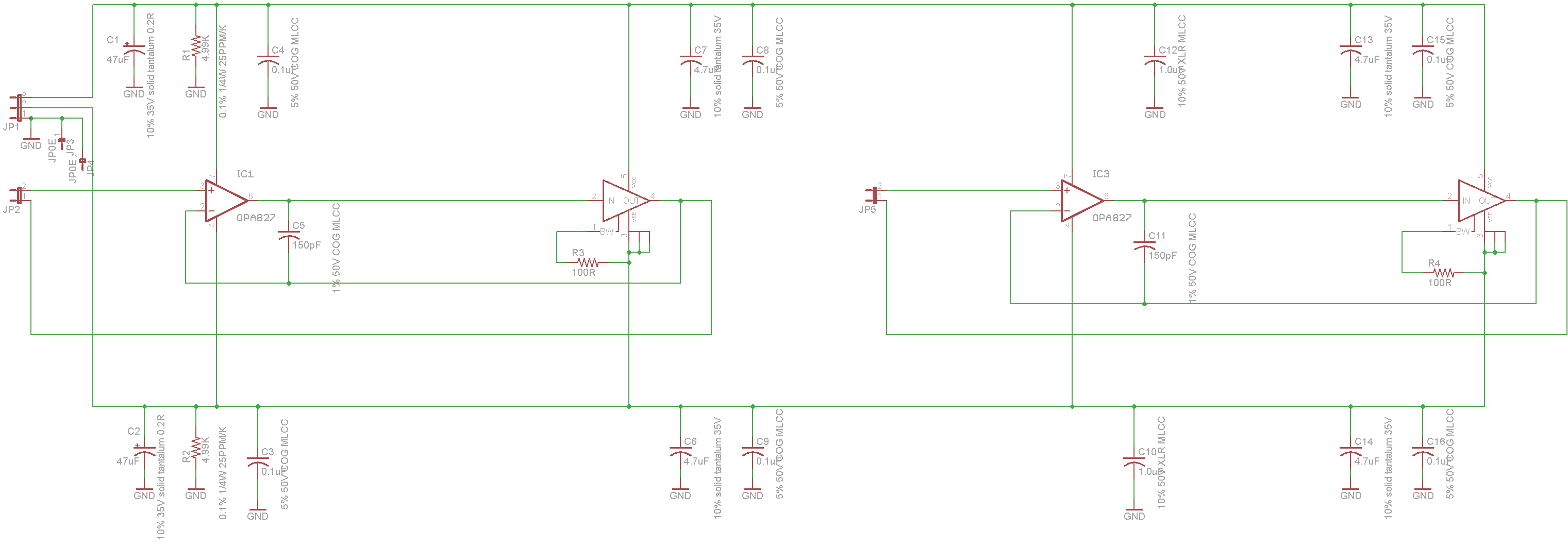

Here is another spin at an O2 accesory output board using the LME49600 buffer with an OPA827 wrapped around it instead of a LME49720 or a LME49990. This arrangment solves the "DC servo makes the offset worse" problem on the LME49600 datasheet headphone amp given the much lower input offset voltage and input bias current of the OPA827 vs. the LME49720. Doing some Googling and forum searching I'm finding several OPA827+BUF634 amps out there, but didn't turn up any OPA827 + LME49600. The net result should essentially be the same, with the OPA827 + BUF634 amps having some good reviews.
The non-inverting configuration and FET input solves the problem of loading the pot. Not only is the input offset voltage up to 4 times less with the OPA827, being FET the input bias current and input offset current are 1000x less, meaning no more significant voltage drop generated in those 40.2K resistors to ground in the O2 amp. In other words the circuit should also pretty much null out that 3mV or so output DC offset the O2 has. That was another thing I wanted to roll into this board somehow, DC offset reduction for RocketScientist / NwAvGuy's O2 amp. If I'm going to spin a board to replace the NJM4556As then it might as well nuke the DC offset too.
Still should achieve the goal of lower THD than the NJM4556A chps it replaces, plus the circuit could hangle higher voltage rails and supply more output current. Eliminates the need for the 1R output resistors.
Sergey888 - sgrossklass - jcx - any input is welcome!

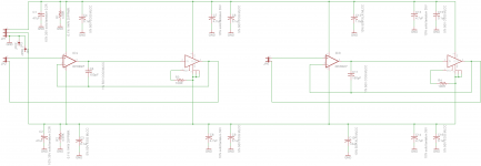

I had a better idea on the layout. I've gone to 4 layers here, since the fab is so relatively cheap these days, with the bottom foil all V-, same as the heatsink foil for the Dpak chips. Then nailed the two together with thermal vias. That links the two pads electrically and saves a connecting trace on top, along with 3x'ing the heatsink foil area. Then the ground plane is in the middle - only used for bypass / decoupling return here - and the other internal layer for routing V+.
OPA827 + LME buffer
You may want to have a compensation capacitor around OPA827. At least a place holder. And of course you can make it two poles (as with OPA551) or inclusive, where midpoint resistor connected to buffer output instead of ground.
Don't forget about input and output filters. Fast buffers may be upset driving a long unterminated like without any filter.
Important thing to have is power supply decoupling for input opamp. Just put a RC filter with something like 22 Ohms 100uF.
You need good power supply decoupling next to output buffer.
I see why you want to separate buffers in space, but proper power supply routing and decoupling may be tricky this way. I would probably put them closer.
You want to be careful with return currents from decoupling capacitors. This will be an B/AB class output, so these currents are highly non-linear. Because you do not separate signal and power ground, you need to pay an attention to make sure they are not going to be injected into signal path
Sergey888 - good comments! Thanks.

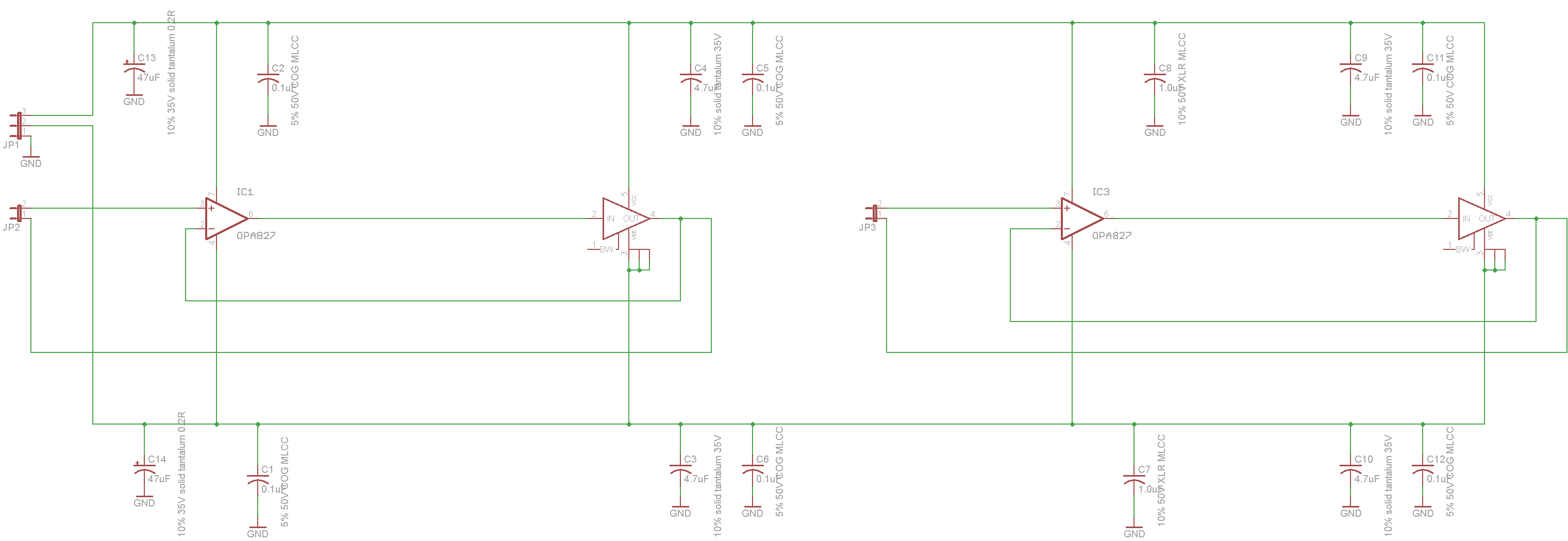

I'll add that feedback loop placeholder around the 827's. Certainly can't hurt. The whole board has wound up shorter now since I realized that I screwed up and had it laid out as 28x160mm initially rather than the proper 28x80mm to fit the O2 amp's case. The good news is that takes care of some of those longer trace paths.
Well... turns out I also had the O2 case (B2-080) upside down again. Aarrgghh. Rightside up the space above the board to the top of the case is 4.6mm instead of 5.5mm, just slightly taller than the LME49600 (or OPA551 DPAK). It fits, as the photo shows, but that is without solder. I think that I'm going to fab it anyway. If it binds maybe bending the case top up slightly will solve it, or even sanding down the case on the 49600's slightly, or just flip the O2 case upside down (but than the front panel moutning holes are slightly off), or use the taller B3-080 case.
The bypassing caps are added. I've followed National/TI's guidelines from the 49600 datasheet and the evaluation board datasheet. I've cut a notch out of the bottom layer trace where the board sits above the O2's 220uF electrolytic caps since the top of those are exposed and metal. I've also notched out around one of the O2's AC rectifiers. I've stayed with 1206 SMD or larger, even though they are a lot bigger than needed, just to keep it DIY-friendly.
Looks like the total DIY cost, including one board out of a minimum board order at Seeed Studio, clocks in at about $60. Lol - RocketScientist / NwAvGuy would probably cringe. $60 to replace the two $0.70 NJM4556A's with something beefier and lower THD.

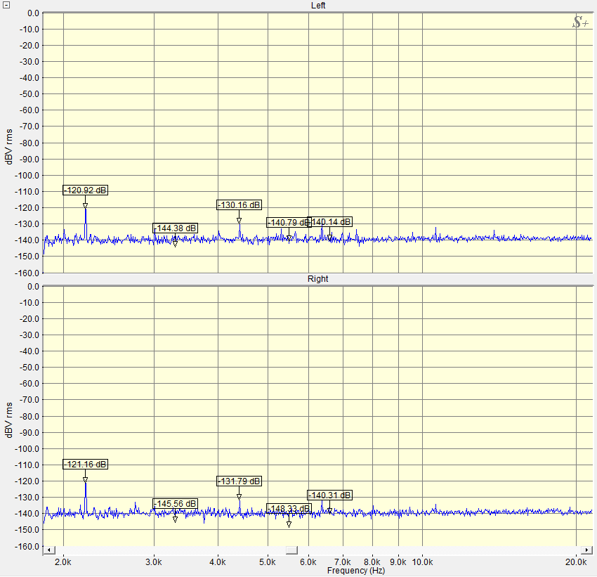

I'm really kind of liking using the FET input OPA827 after the O2's middle-of-the-circuit pot. The design solves the issue in the O2 of the NJM4556A input bias current causing that several-mV drop across the 40.2K input ground return resistors, which gets reflected to the output as DC offset. The OPA827 specs out as 125uV input offset voltage maximum with just pico amps of input bias current. There should be no reason why the O2's output DC offset isn't that low now. That would be a 24 fold decrease in the O2' DC otuput offset voltage.
From the data sheet graphs the overall THD of the OPA827 + LME49600 should be down an order of magnitude (10x) from the NJM4556A for the lower half of the audio band, and more like two orders of magnitude down for the upper half, if I'm looking at those plots correctly.
In the layouts below red is top layer (V- rail which goes to the LME49600 tabs), blue is the bottom layer (also V-, stitched to the top layer with thermal VIAs), hatched blue the second layer (ground) and hatched red the 3rd layer (V+ rail). In Seeed's process those inner layers are half as thick as the top and bottom layers so I've made the inner traces wider to compensate.

There is a pretty good layer of plastic in these packages. You can easily file off 0.5mm or even more.

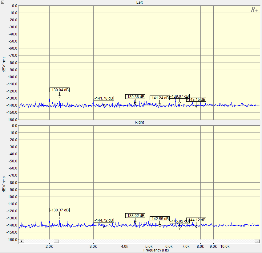

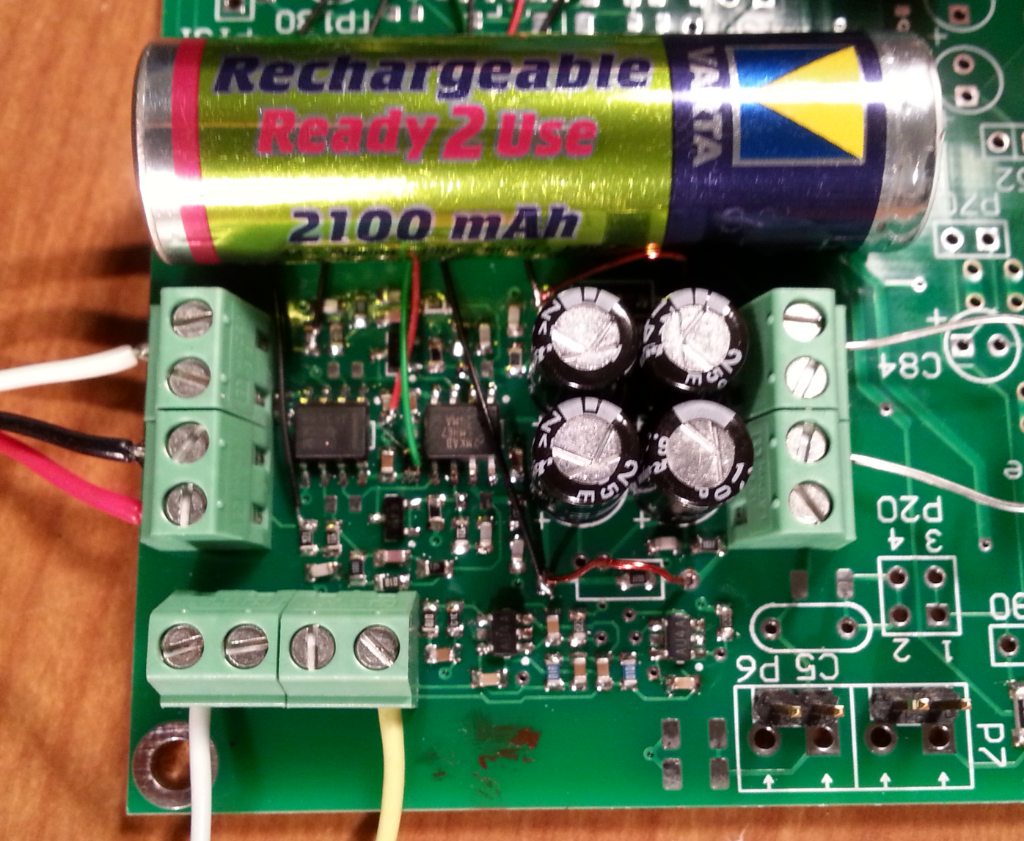

In this little, single battery powered project, second and forth harmonics dropped around 8-10dB when I increased timeconstant of that RC filter around front end opamp. And it was driving just around 1Vrms at 33Ohm.
Sergey888 - I agree about the package sanding. Taking 0.5mm or so off the top really shouldn't have any effect. Most of that plastic is for mechanical strength when the leads are bent. Having the chip body butt up tight against the top would seem to be good for heat sinking, but I know that very little heat actually transfers through the plastic body. Most of the heat transfer is through that metal tab. Having the entire PCB bottom as heat sink trace via those thermal vias should help quite a bit.

I forgot to post a picture showing the clearance underneath a PCB in that top slot vs. the top of the O2 board. Fits great. I've added pads for a resistor to V- on the LME49600 bandwidth pins in case someone is running it on AC and doesn't care about current draw. I made that one a small 0603 sized SMD though to save space, so if anyone wants those two resistors they will have to work for them a bit when solding.
All the wires go to the two DIP headers replacing the NJM4556A chips except for ground. I have it set up to get ground in any of 3 ways. Solder to the middle battery terminal that the PCB butt up against, solder through a hole I've put in front to a wire that goes around a case screw ( same way RS used to ground the case ) or solder a wire to another hole I added above the output jack to the center ground on that O2 hole he has next to the jack.

Sergey888 - I was thinking about a negative-rail-only RC! That much might fit, especially if I did go to 0805 or 0603 sized SMD for a few things. The net result should just be slighly reduced maximum output swing, hitting the negative rail first. I'm still thinking about whether that might alter the offset voltage. If nothing else I could just add 2 pads and try it in V2.0.
Well V1.0 is out to fab. With any luck I'll have it back in a week. I had to use Seeed Studio's 5cm x 10cm 4 layer service for the 28mm x 80mm board. I realized today that I could panelize 3 of these side by side (nice wide 8mm cut channels inbetween) and then use Seeed's 10cm x 10cm 4 layer service, which is only $20 more for 10 boards. The per-board cost, including DHL, would drop from $10.50 USD to $4.50 or so.
I have the files below also at a Google Drive link, but I have no idea how long the link will continue to work. My Goole-fu on permalinks isn't doing well.
https://drive.google.com/folderview?id=0B67cJELZW-i8Vmp5MDVLNzJxTGc&usp=sharing
The V+ rail is now a polygon on layer 3 rather than traces, to match a polygon ground on layer 2 and the full V- plane on the bottom and top heat sink foil areas.
I've added optional 4.99k resistors across the O2's power rails, R1 and R2, to implement a no-thump mod I posted a while back. Puts a 10K resistive load across the load side of the O2's mosfets to allow the post-mosfet power rails to discharge linearly all the way to zero when the mosfets shut off. RocketScientist / NwAvGuy left it with just the chips as load on the mosfets. Their discharge rate becomes rather undefined when the rails drop below the chip's minimum operating voltage, which can result in one rail dropping more than the other, which can create a power-off thump.

You can not connect C5 C11 just like that. Resistors must be added between LME's output and opamp input. Sorry didn't noticed it earlier.
I tried it in simulator. With opa827 and without fitting anything at all the phase margin looks a bit to small. Fitting 10p + 1k resistor brings it to more reasonable level.
The alternative way would be using opamp with smaller GBW, like OPA1642(1) I mentioned before.
