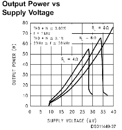

2x 24V transformer will be fine too, if you go with 8 ohm speakers; power wise anything in 200-400VA range will work fine. The amp actually sounds better with higher voltage (more lively and engaging). if you prefer more laid back sound, than lower voltage might work better.
Attached graph shows power vs supply voltage.
