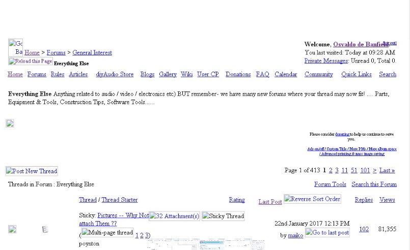

Ok... have spent an hour researching this now.
ERR_SSL_VERSION_OR_CIPHER_MISMATCH is the key error.
The problem is that Windows XP doesn't support any modern ciphers or SNI. I just looked at our stats, and 1.6% of visits to diyAudio are from WindowsXP.
Windows XP End of Support
After 12 years, support for Windows XP ended April 8, 2014. Microsoft will no longer provide security updates or technical support for the Windows XP operating system.
PCs running Windows XP after April 8, 2014, are not considered secure.
It's possible for us to downgrade and open up insecure Ciphers, but this then appears to break many more modern browsers due to some SSL/Cipher incompatibilities. I've been unable to activate SSLv3 with XP compatible Ciphers, while not breaking other things.
I may ask for a SSL expert to assist and see if there is a workaround but I've tried a half dozen recommended ssl_protocols / ssl_ciphers combinations now, then testing with SSLLabs). So, we have a choice between breaking the security of the site for 1.6% of visitors, and having a buggy and insecure end-of-life Microsoft OS work for those computers. It's a tough one, but I think I'm going to pull the plug on WindowsXP. The workarounds to support it are to the detriment of modern browsers.
Average time to infection: 4 minutes - TechBlog
It takes an average of 4 minutes for a fresh WindowsXP computer connected to the internet to become infected by Malware, which is less time than it takes to download the latest security patches. That article was from 2008, I assume it's much quicker now. It's a mess, I suggest we draw a line in the sand. If you can give me any good reason why anyone in 2018 should be using WindowsXP, let me know. The internet has changed, it's much more dangerous than it was a decade ago. Running Windows XP you are literally asking for malware and cryptolockers to ruin your day. If I can find a workaround, I'll implement it though, no problem.
I'm confused about why you can access the site at all, but it's possible that once we switch to true SSL only (next week), diyaudio.com will be completely inaccessible from an incompatible browser.

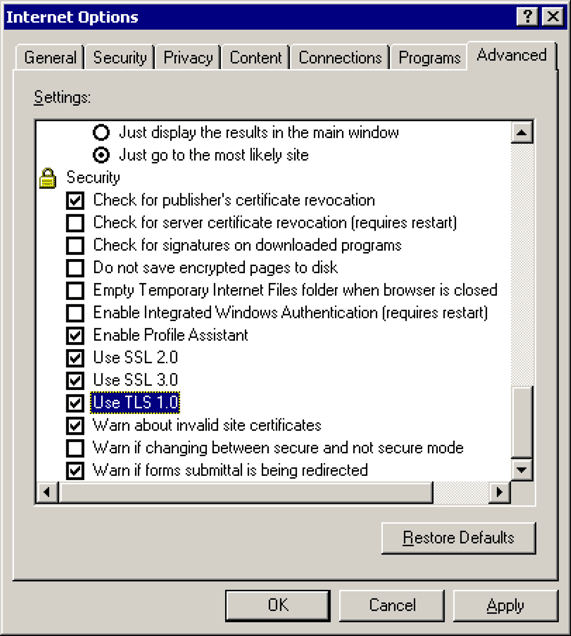

Hello.
The last two-three days, when I enter the site through a Win XP computer
Can you try this? I've now enabled TSL1.0 but I can't tell if that's going to work with <IE9+XP.
https://warwick.ac.uk/services/its/servicessupport/web/sign-on/help/enable-tls/
  1. In Internet Explorer 6, go to Tools > Internet Options.
  2. Select the Advanced tab.
  3. Scroll down to the Security section. (It's at the bottom of the list of settings.)
  4. Select the checkbox Use TLS 1.0
  5. Click apply, then OK
Again, strongly suggest you switch to Firefox, if nothing else but for your own safety.

Firefox and Avira were the last resort for WXP. Still work! A couple of months ago I moved to W7 though. I don't feel much safer to be honest... WXP would "show" me if something was running in the backround. I mean, not much could stay hidden, I think. Revisiting Ubuntu after almost a decade it was a big dissapointment to find that it is nowhere close to what I was remembering. But I have to admit that most probably I am the least qualified internet user in this forum

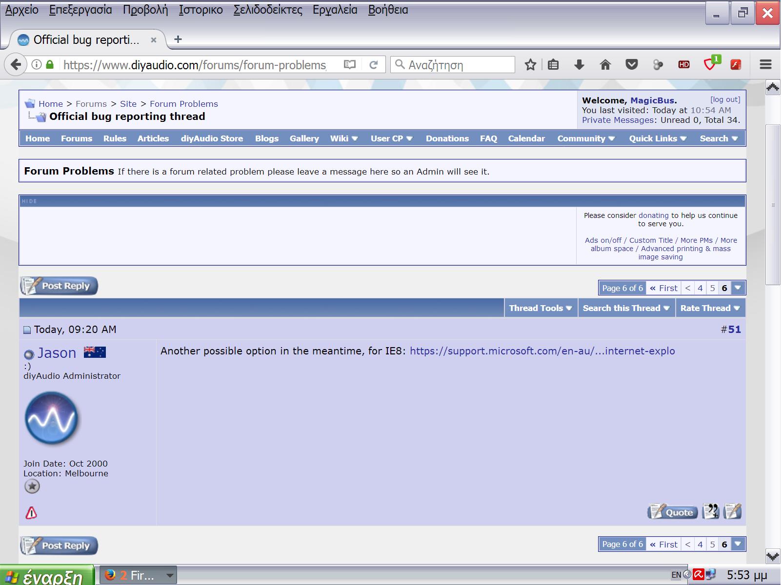

Now I have to apologise to Jason for making him spend his time chasing the problem I posted.
I am using Win XP SP3 and the browsers that cause problem with the site are Chrome 49.02623.112 and IE6. The IE8 does not open the site at all.
The Firefox 52.90esr and the K-Meleon 1.54 work fine.

I have now implemented a detection page for WindowsXP users that will throw them to http://noxp.diyaudio.com which gives them a direct download link for the FireFox version that they can use to browse diyAudio and other websites that do not support SSLv3 and require SNI.
It's hard for me to test (I've faked the user agent and it works for me) but if anyone with XP can tell me that is working for them (successfully redirecting to http://noxp.diyaudio.com) that would be good to know.

The detection page works for Win XP SP3. :up:
