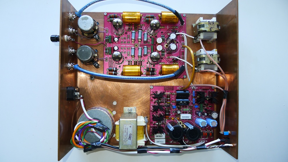

Some months ago have found in my country the not-ready KIT by one guy. As in my stock are been many years ready a lot of stuff, like Altec Peerless 4722 step-up traformers, Cardas connectors, Jensen Capacitors and old USA resistors etc... i have decided to made this project ready for my Garrard 401. The results are very amazing and what is good--tubes are making more lively sound compared to transistor amplifiers. It also very good resolution in the sound. Best tube amplifier in this level! I am using end caps yet 0,22 uF. Think they are not enough. If I am comparing to high end transistor amplifier –there are more powerful sub- bass. It be very helpful, if somebody can tell , what upgrades are been as good step forward by this phono amplifier. Also what is small problem— slightly hearable hum in both channels. Maybe it is because I haven’t yet build shield . The transformers are separate for anode and filament voltage. There aren’t shield between primary and secondary windings. Maybe it is reason maybe not.
Please tell about your experiences with this amplifier.

Yes, the D3a is a very good tube, especially for phono. But because of the high amplification is is very sensitive for stray fields, and that is where the hum comes from in your build. You should think about building an external supply, and use shielded input wires.
Output cap should be minimum 1mF. RIAA caps and resistors should be matched as close as possible. And the Salas SSHV 2 is better than the first one you used.
But already in a simple version this is very good. BTW I found the attached circuit to be better, more linear and smaller resistor values in the RIAA for more dynamic sound. You can omit the Ecc288 Line output of course...
